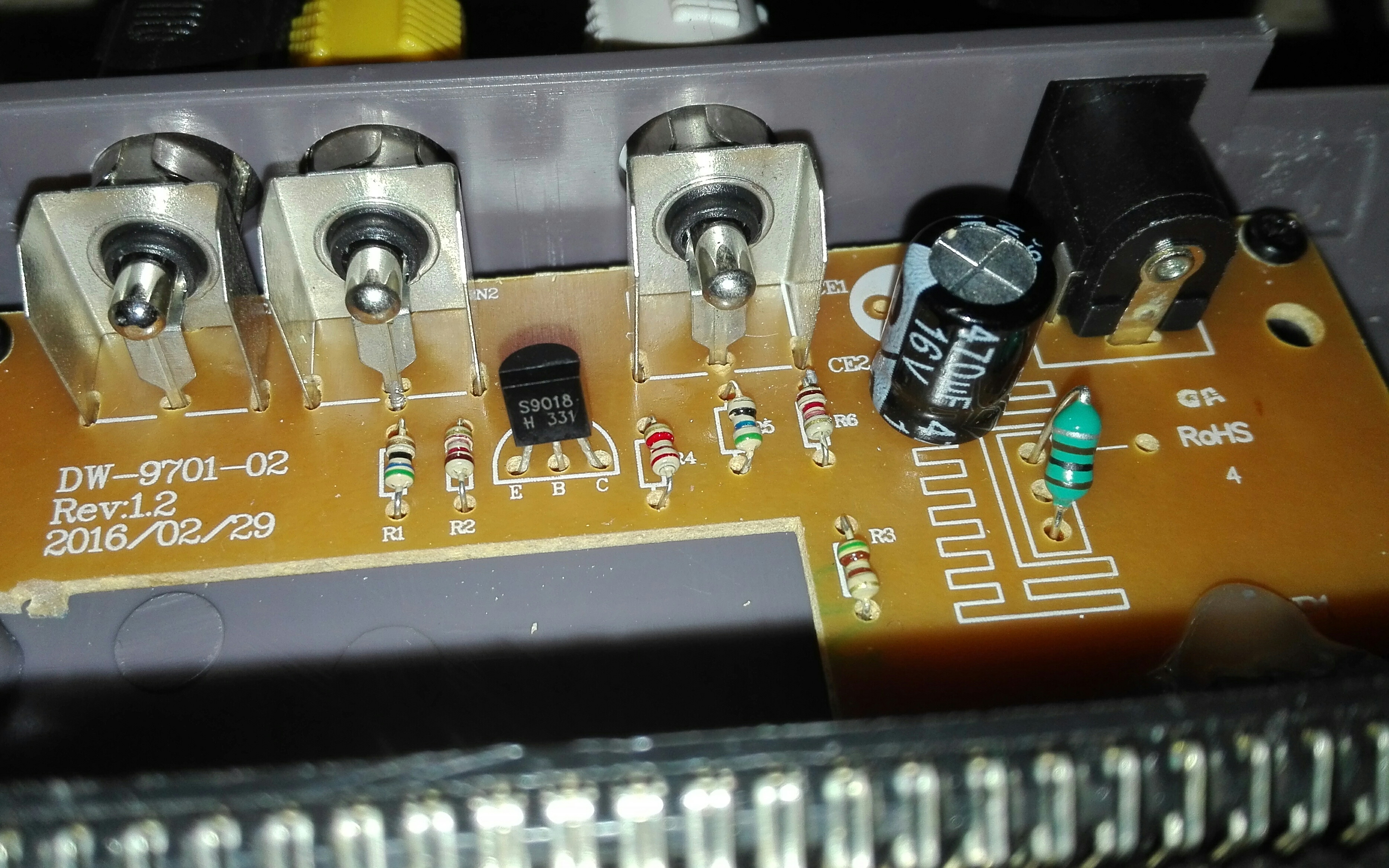

    I have tried to resolder the video connector pins etc. but it hasn't changed anything. I'm not an expert which I believe you can tell, but could it be that the transistor is bad?
    I took one quick picture, I have to resume this tomorrow or later date.

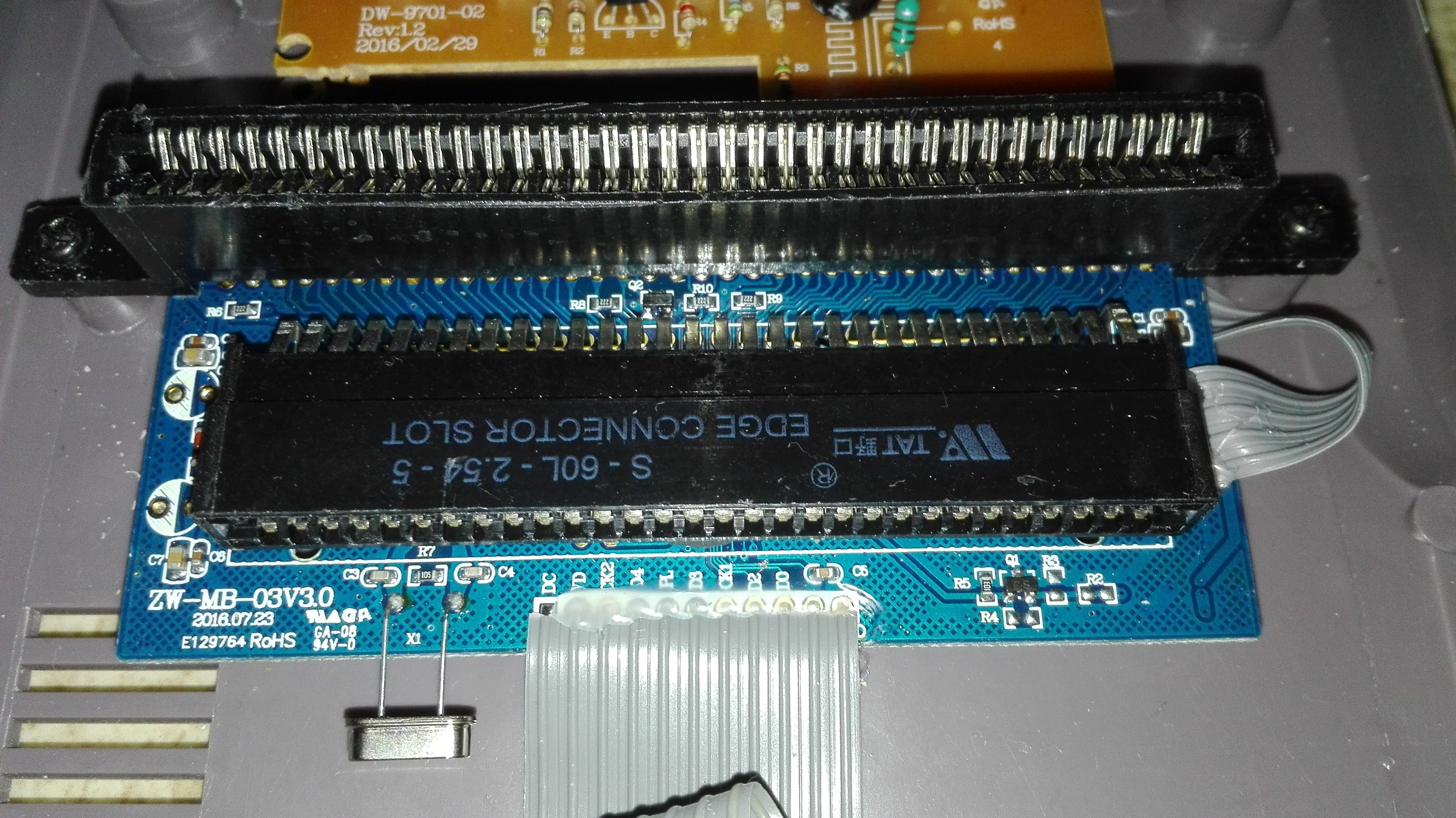

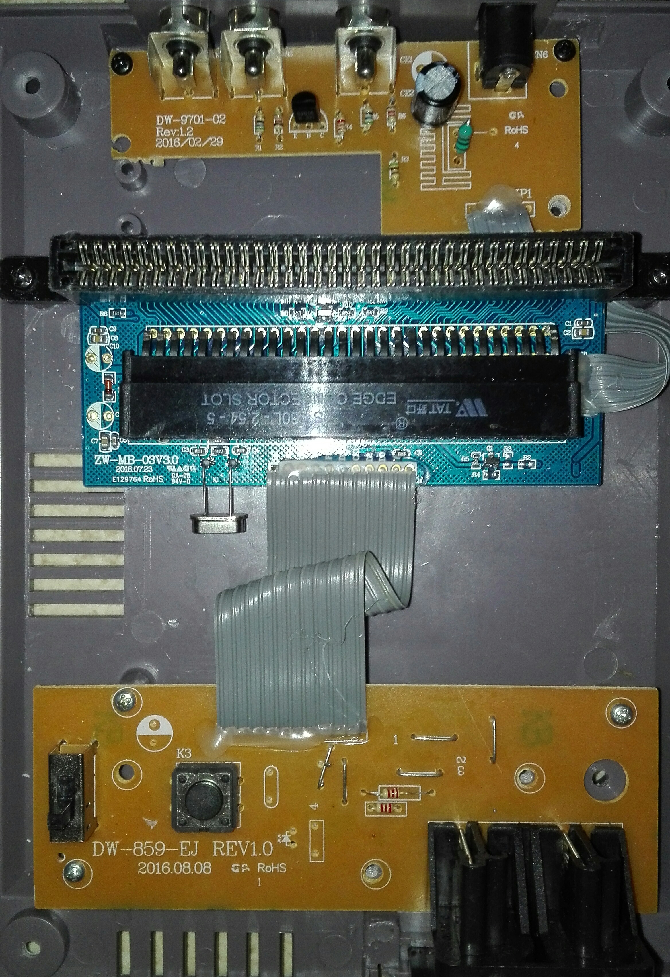

    Are there any other transistors near the cartridge connector? More pics would be great to see if anything else can be done.

    Yes, I already raised dispute, took several photos and recorded opening of the package as well as testing. Seller has not yet responded.
    First I thought I shouldn't open the console before dispute has ended, but then again of course I will not be sending this back since it's so expensive so I'll hope either the seller or Aliexpress will refund. I didn't ask for full refund since game cartridge which was included works in genuine NES.

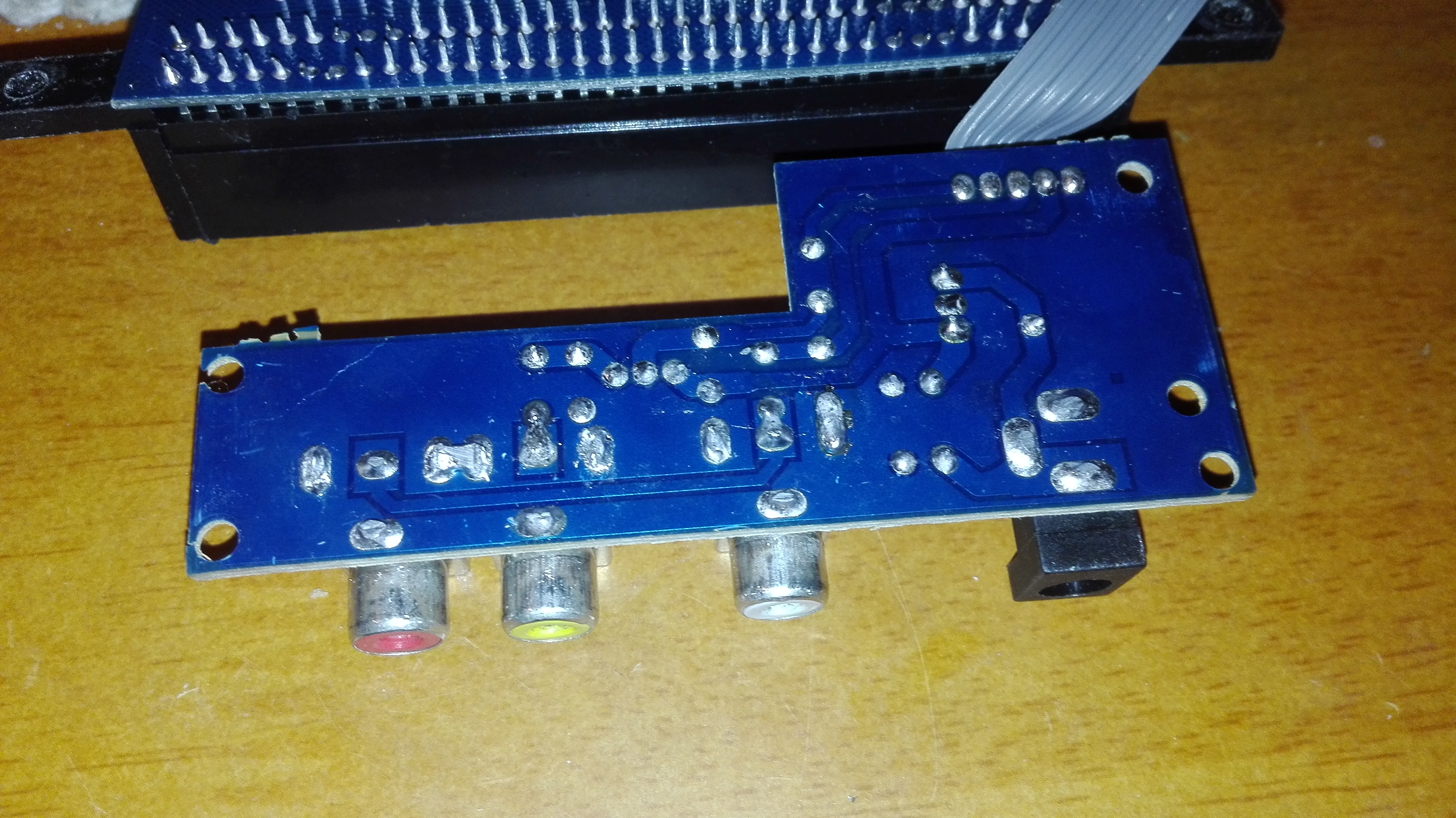

    Backside of the power / av connector board.
    Tested ribbon cable continuity, cables seem to be good.

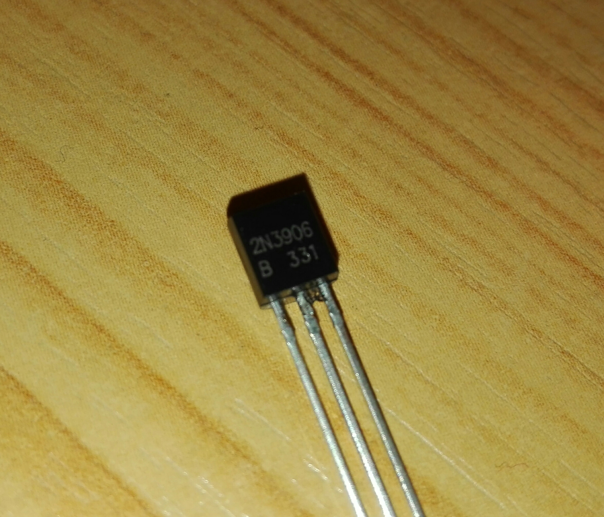

    If the transistor can be suspected, I have these available and maybe one another type, have to look:
    But I don't know if these are compatible.
    UPDATE: Tried replacing transistor, nothing changed.

    Console was fixed by performing AV mod using new transistor and bypassing most of the AV board.
