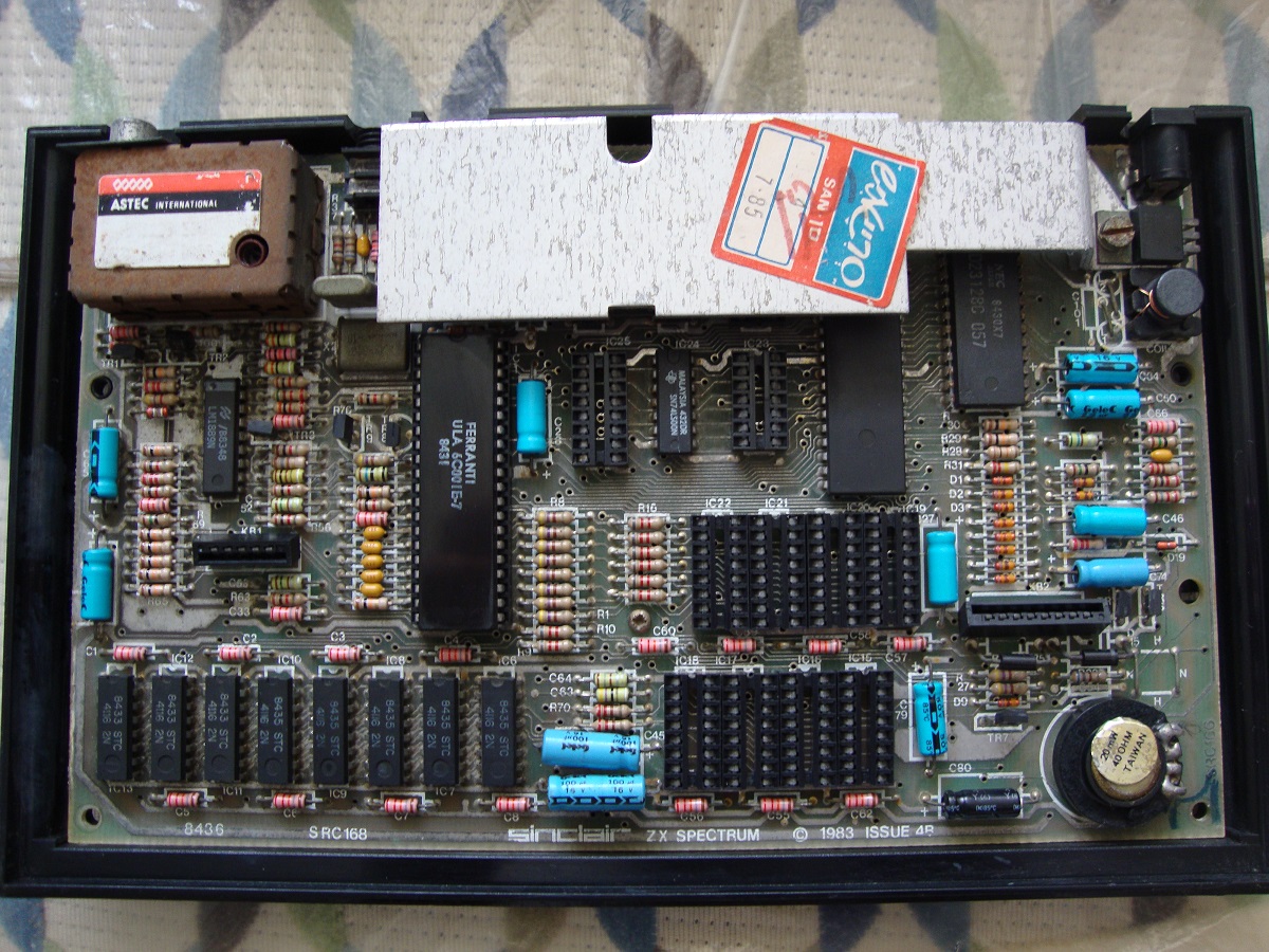

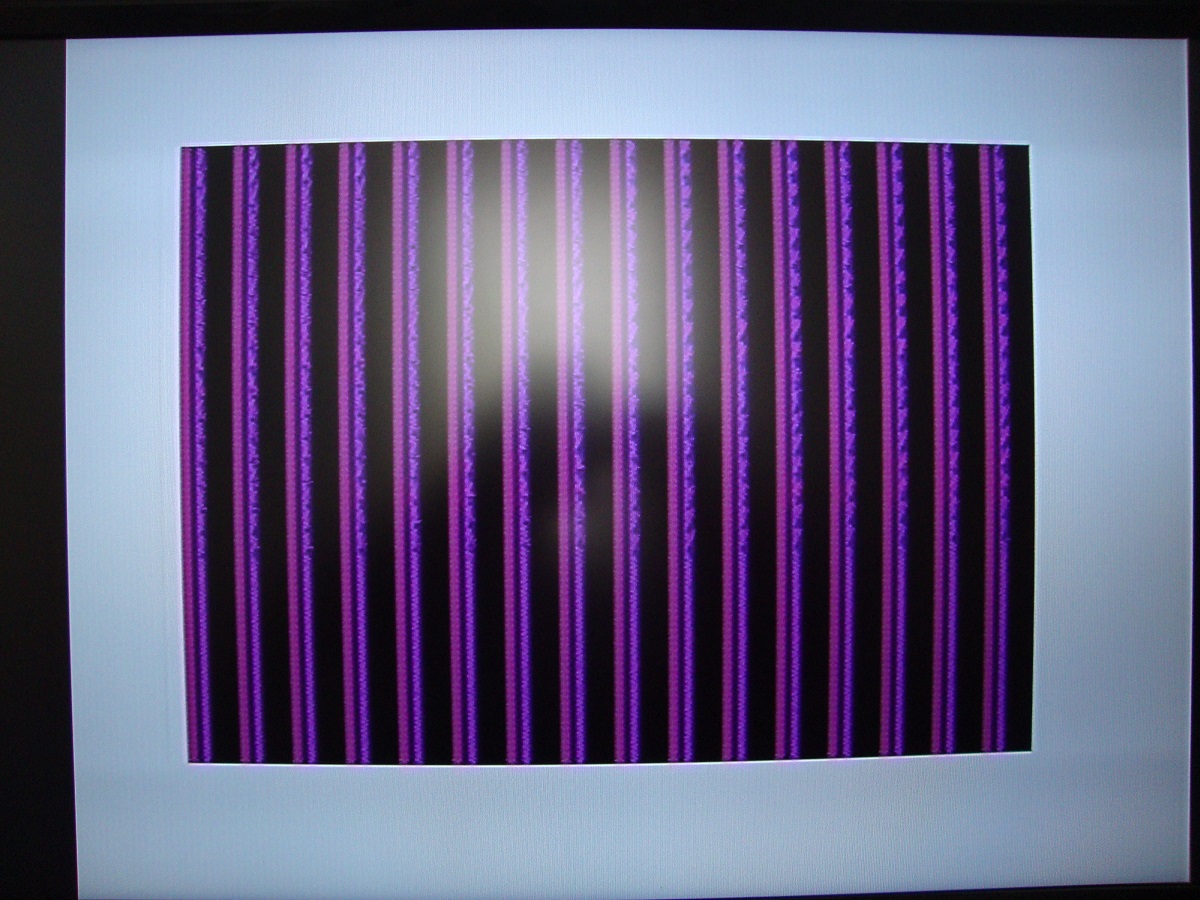

    Hi I see you know about the ZX spectrum and maybe you can help me. I have on 48k that when turn on it only display the screen in the photo. I dont know anything about this computers but it suppose to boot in white and with the sinclair words at the bottom screen.
    Well I think is a 16k the board have too much unused sockets.

    Yea, it should load in the a sinclair copyright screen. That is most likely an issue with one, or more, of the lower RAM chips being faulty. At this age that isn't surprising, especially considering how Clive Sinclaire LOVED cost cutting (it doesn't even have a proper solder mask on both sides of the board).
    Finding out which chip is faulty would be a real pain and finding replacement chips would be hard as they can run into the same issue not to mention them being expensive. I'd recommend desoldering all lower RAM chips and replacing them with the modern variant (http://zx.zigg.net/LRR/)
    And yea, that is a 16K speccy.
