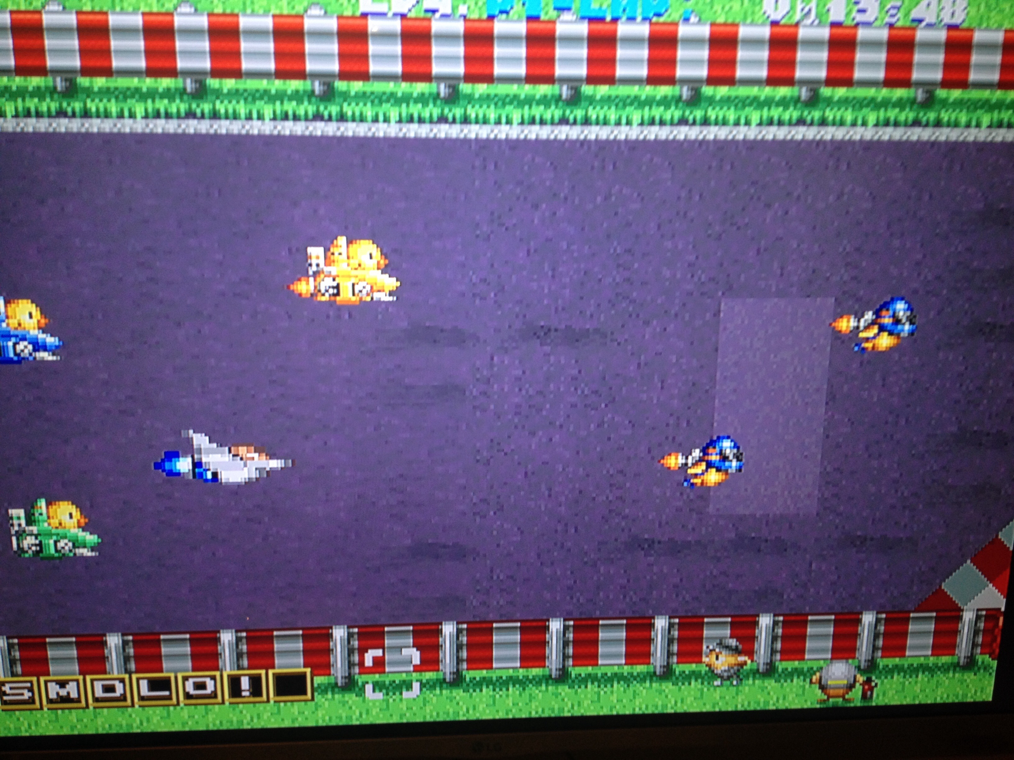

    I'm new here and have a weird Problem with my Framemeister which I can't solve even after days of testing...
    Hope the post is right here.
    On all analog inputs, on all my consoles if Picture mode is selected, I get pixel issues at the left screen site most at light grey colors and purple colors but only if the screen scrolls.The problem does not appear at static Images.
    Most noticeable when I turn the sharpness up and lower the A/D settings. Pixels on the left site gets blurry...
    Here is a picture from Oshaberi Parodius which shows the issue quite good.
    So is my FM faulty or is this a common problem with the mini?
    I haven't found this specific problem nowhere in any forum.
    Hope somebody can help me
    Thanks!

    That looks strange indeed, the little light grey rectangle on the right is there all the time as well?
    Never had that with the FM, I take it your on the latest firmware? Have you tried a different screen? Does this happen on any resolution? What about the other modes?
    Picture mode might be specifically tailored for static content, I've never used seen or used it actually.

    Yes the mini is updated to 2.03a.
    It happens on default settings (after reset) at 480p and at any other resolution. With meister mode it gets better and is only slightly noticeable. wth standard mode I get some strange backgroundblurry around moving sprites. But I dont like the low pass filter so I play all 240p and 480p games with picture mode. Same problems on a different screen.
    I even think about buying another mini cause this issue annoying and my mini is for some reason faulty.
    I can't imagine that this problem is common for the mini. I thought picture mode is the way to go for 240p?

    The rectangle is the normal graphik!

    That's very odd. Can't say I've ever seen anything like that in any of the 100+ Framemeister units I've sold. Is the light grey square always in the same place on every game?

    Sorry, I'm not referring to the square, thats the ordinary levelgraphic.
    I hope in my video it is identifiable that left site is darker than the right one which causes the crushed pixels at the light grey background I think.
    Don't be confused by the look of the video. At picture mode I adjusted the sharpness up to 30 and lowered the A/D Settings to 20, over a scrolling background (Contra Hard Corps) to demonstrate the odd issue. Otherwise it is hard to recognize at a uploaded video...

    I had the chace to test the problem on another brand new mini, unfortunately with the same results.
    The same pixelissue on the left screensite with picture mode enabled.
    Very disappointing:(

    Have you tried different cables? Could be a faulty HDMI cable. Also make sure you're using the right valued power adapter.

    Yes, I tried three different HDMI cables on two different monitors. I' m using the the origininal micomsoft power adapter bundled with the mini. I also tried another mini PSU.
    Is there really nowone else with the same result?
    I wondering because I notice that flaw on two different FM, but as I said only on light grey, deep purple/blue backgrounds with scrolling.
    If I turn the sharpness up and lower the A/D settings I can recognize it all inputs with picture Mode enabled.
    Even on the new mini I tested.
    Most strange!

    Nah man, its perfectly fine on ALL my consoles. What consoles have you tried on it?

    MD 1 Jp, Saturn jp, Xbox pal, Neo Geo pal all with raw sync cables.
    DC jp via toro. PS2 jp via component.
    The problem is most noticable on saturn and Neo geo for example on Samurai Shodown II at the scrolling character select background.
