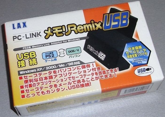

    Sorry for le bump, Gentlemen, but since we were talking about a Dongle->PC adapter, I was wondering, did you Gentlemen ever try to dump your dongle files (not bind lol) using such a crap device ?
    I got one a few days ago.
    This thing plugs into a MC slot of a retail PS2 and you insert your PS1/PS2 Memory Card into it. Once the mechanic's controller did authentificate the card and the session is open, the LED of the adapter is flashing green. Then you can link the adapter to your PC using the USB cable and run teh PC software. Both the bundled client/manager and the EMS one are unstable as hell and can't raw dump the cards from what I saw...
    Perhaps this kind of adapter is COH MechaCon friendly LULz, who knows[​IMG]...

    Is that using the PS2 to unlock magic gate? If so, I do wonder about using it on a 246 but it's possible the boot only keeps the card going long enough to pull the elf.

    -Unlock protocol for dongle seems also different than that of retail memory cards. BIOS uses different drivers for the dongle (dongleman vs mcman) and for any eventual memory card which might be plugged in. So I don't think kHn idea of using that "MG BYPASS" device will work... Well, if it works I won't be eating my shorts ... lol
