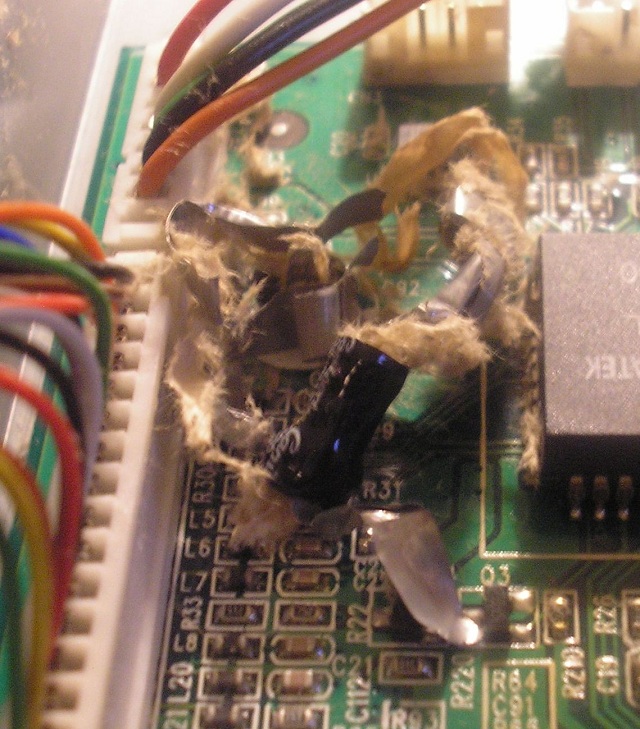

    Yup. Just find out the names of all of them (should be a spec sheet somewhere if you can't read them on the caps themselves) and just replace them all.

  7. la-li-lu-le-lo
    I'm confused - are you saying that photo is what I described, or that's what's going to happen? Because that's not what I saw. As I said, the capacitors looked normal. The yellowish hair-like things were centered around the cart connector; there were a few elsewhere, but they were mostly centered around the cart connector. There was also some dust elsewhere.

  8. Twimfy
    Twimfy Site Supporter 2015
    Apr 10, 2006
    3,570
    When you mentioned yellow hair I immediately thought of the picture above but perhaps it was simply just yellow hair.
    I'm not saying that's going to happen but it really does sound like a caps problem.

    Twimfy's picture looks like what happened to a sub amp of mine when water got inside and shorted out a voltage regulator. Replace the cap, turn on the sub, BANG. Went off right into my foot too.

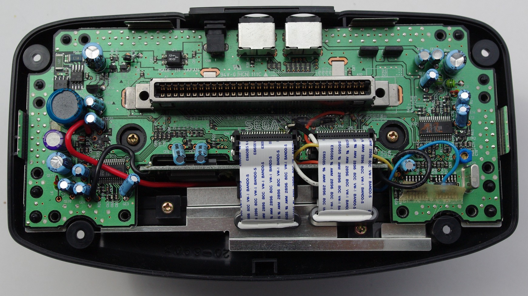

    I've been troubleshooting the same issue, although mine does boot and play.
    There's a high-pitched whistle/whine/hum from the left side of the board.
    In looking at a few other threads, there seems to be a lot of discussion on the "inductor" on that left side, and it's quality. It seems that SEGA used an inferior one, or that the inductor goes bad after a while?
    http://www.digitpress.com/forum/sho...making-a-high-pitch-whining-sound-when-played
    http://dreamcast-talk.com/forum/viewtopic.php?f=18&t=3530
    http://www.sega-16.com/forum/showthread.php?5154-Sega-32X-System-Buzzing-Humming-Crying-Noise
    I've taken a look at mine, and the inductor does seem to be the source of the noise. None of the caps around that area appear to be making any sound.
    Now, is it possible that bad/failing capacitors could cause the inductor to be noisy, and THAT'S the problem?
    Or, is it a bad inductor? I just don't know . . .
    The inductor on my unit is labeled "331º" on the top, and I am still trying to determine what I should replace it with.
    A similar rated inductor? A higher rated one? OR, is it the caps . . . ?
    I'd be interested to hear what else you learn . . . it seems that the noise 32x is a common problem, such as this situation:
    http://www.sega-16.com/forum/showthread.php?20645-Strange-audio-problem-with-After-Burner-32X
    There's some great breakdown pictures of the 32x here - -
    http://notaz.gp2x.de/hw.php (scroll down to the SEGA 32x section, he has some very high resolution images)
    Here's one of his pictures; the inductor is the largest cylindrical object on the left side of the board
    -a2a
  16. Flash
    Flash Dauntless Member
    Oct 18, 2011
    739
    67
    Remove plastic cover from it and glue the coil to ferrite core. This should eliminate that hissing sound. It's a common problem with various types of chokes and transformers - coil moves on ferrite core with current frequency, so it becomes a kind of speaker. If it's glued - there's no sound anymore.

  18. atari2atari
    atari2atari Rapidly Rising Member
    Mar 13, 2012
    98
    Interesting! Do you think that standard hot glue gun glue would be okay, and not cause damage? I'll desolder the inductor and take a peek. Good idea - - I think!
    Have you done this to an inductor yourself?
    "Enough is enough! I have had it with these motherfucking snakes on this motherfucking SEGA!"
    -a2a
