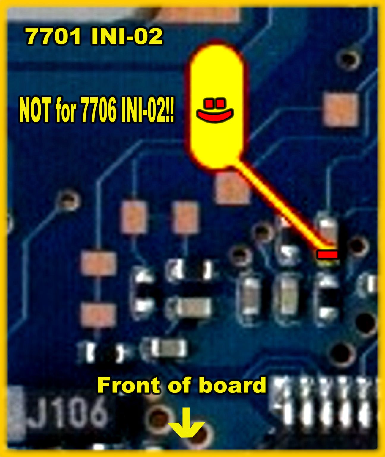

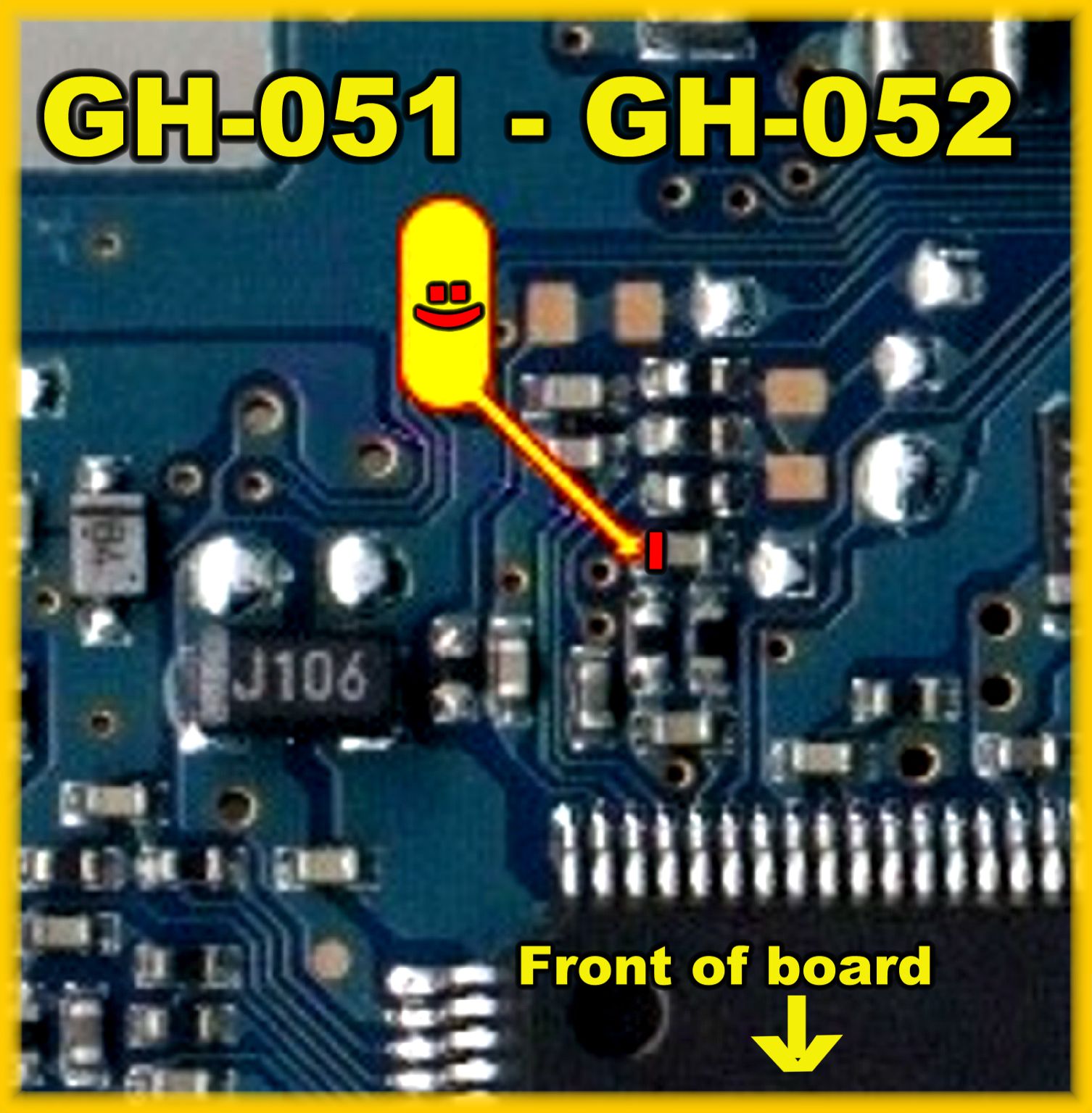

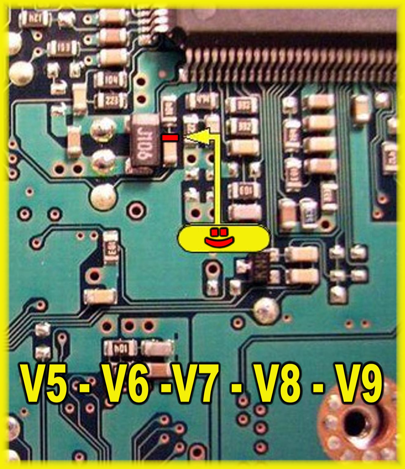

    Sorry if I missed 0's on the numbers LOL... Hope this helps some of you... I believe security is for PS2 mode games only. 051-052.jpg 7701 ini02.jpg 56789.jpg

    If you break it, you get to keep the pieces!!!!!!!!
