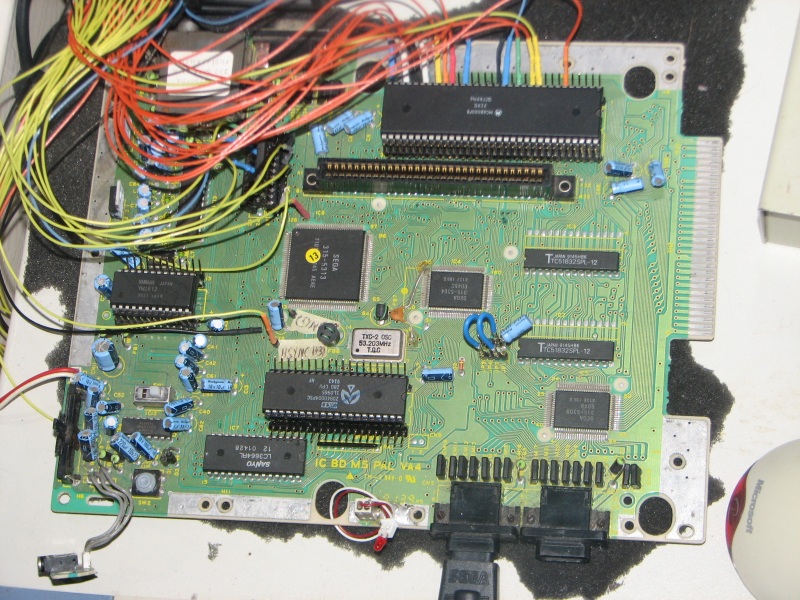

    This is the best way to do it: http://www.amazon.com/Hakko-Desoldering-Kit-With-808/dp/B000ARPULW
    I have one, one of the most useful pieces of kit I ever bought. Makes desoldering devices like this almost trivial. It's the only way you can do something like this:
    Without completely stuffing it up.

    That Mega Drive board is very impressively done, I have to say! :congratulatory:
    Thanks for the tips guys, looking forward to getting one and doing some fun things to my Mega Drives... !
