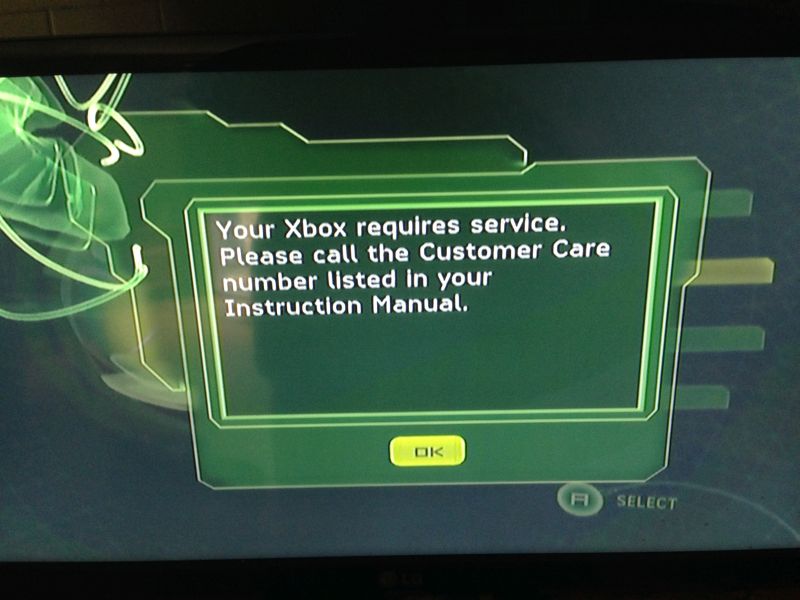

    Maybe someone can help me out , I have plenty of experience just never had this particular issue before
    Xbox fires up normally , I can navigate through the menus but when I try to play a game , the game spins like it should and the xbox logo comes on like the game is starting , then goes back to dash with this error message
    I've tried 3 drives , I know they are good , tried changing IDE and power cable , and multiple games , same error
    Thanks for any advice

    Have you tried tinkering with the eeprom? Try to load a backup.
    If not I would advise clearing the cache partitions. Also, how much space you got left on each drive?

    It's a stock xbox I got off ebay , hard drive is empty except SID5 and Splinter Cell gamesave , I cant get the eeprom which is the problem
    I meant I tried 3 different DVD drives if that wasn't clear

    If you can't get a game to load I have no idea how you're going to go about getting the EEPROM atleast short of getting a modchip and installing that. That's a very odd issue to be having. I'd figure something is either bugged with the EEPROM or just xboxdash.xbe

    Yeah I figured this would be the place to ask , I've probably gone through 100 xbox consoles over the past 10 years , softmodding , and etc , never seen this error happen like that. Maybe Ill get a chip for it because its in such good condition , Thanks for the replies and keep them coming if anyone has any input

    Safe to say, it's EEPROM related... Probably a region issue, as it's throwing the xboxdash back up.
    Get or build an EEPROM reader, then come back and share your results.

    Yeah as hex said build a eeprom reader or buy on on ebay, dump your eeprom and keys and see if you can find a stock eeprom dump somewhere and flash back or find a copy of the xbox refreash disk (iirc that only touches the HDD)

    Try holding down the power button and/or eject button. I picked up an Xbox once upon a time without knowing it had been modded, gave me this exact same error but booted into unleashx once I held down the button.

    Guys I have exactly the same issiue these days with a unit a got. I replaced the ide cable, the cd-r and even installed 2 different modchips but nothing worked. It gives the same error on games and plays only music cds. It is a PAL v1.4 motherboard. If find a solution please let me know! Thank you!

    I have only seen this issue with some retail kiosks a few years after the system launched. I am guessing the systems overheated in those enclosed systems and had problems.

    Did you try manually formatting the cache partitions?
