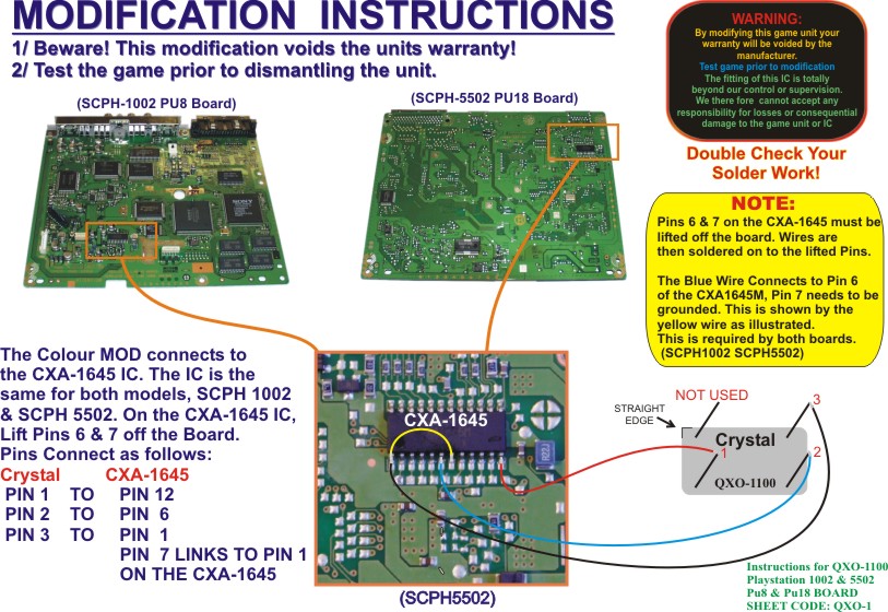

    I've just found a diagram. Anyways,what's with the jumper wire between pin 1 and 7?
    Picture I've found is this:
  6. tehgazza
    tehgazza Rising Member
    Nov 11, 2012
    63
    Jumper wire is because the pin 1 of the CXA is ground, thus you are grounding the pin 7 - saves you soldering two cables to the single point for ground. Its the same reason why you solder to pin 12 - in this case to get at the +5V rail. You could again use any 5V source from the board.
    You may use any part of the ground plane of the PCB if you wish - such as that part that has no solder mask next to the CXA
