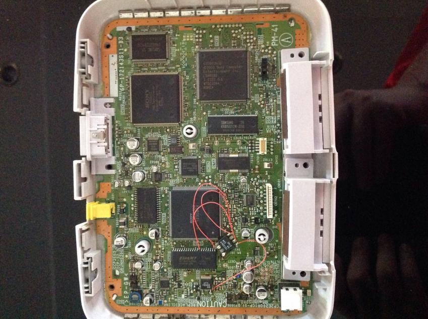

    What do you know? if it's a PAL or NTSC or if it's a pm41v1 or pm41v2?
    If you can take a photo of the motherboard would be easy ;)

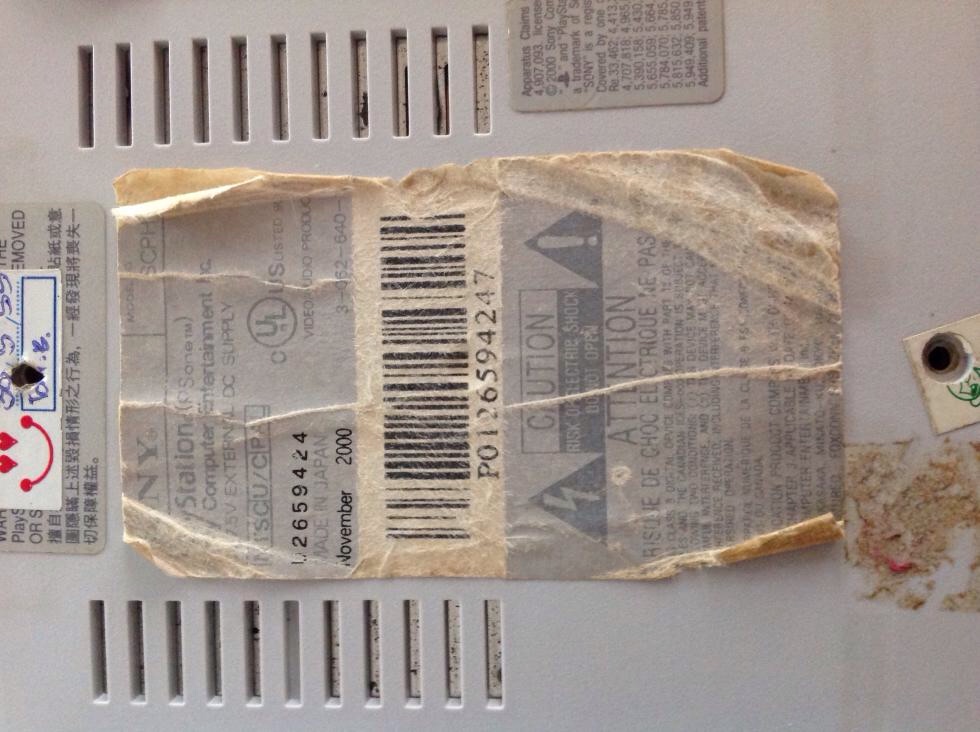

  3. SoulPleumz
    SoulPleumz Member
    Oct 8, 2014
    P.S. The modchip installed onto the console was 12C508/P SAW modchip, it's a fake copy of the 12C508A, installed by the pre-owner

  4. Twilight
    Twilight Site Supporter 2015
    Dec 7, 2007
    615
    The sticker is not original. You may find the original sticker under this shit if it wasn't removed be someone who attached this fake sticker.
  5. master991
    master991 Enthusiastic Member
    Jun 4, 2012
    597
    It'a an NTSC pm41 V1 (old type) with a classic modchip installed

    If you want to find what the original model was, the easiest way is to look at that little square chip in the middle of the board.
    It should have a number starting with "SC4309" on it
    SC430942PB: SCPH-100 or SCPH-103 NTSC:J
    SC430943PB: SCPH-102 PAL
    SC430944PB: SCPH-101 NTSC:U/C

    Mine is a SC430942PB either a SCPH-100 or 103 NTSC-J, anyone knows the difference?

    Different markets - SCPH-100 is Japanese domestic model and SCPH-103 is the Asian export model. The console is the same, and both models are designed to boot NTSC:J discs.
    In fact, that's a SCPH-103, but I only know that because it's still got the warranty warning label on it, and it's written in English and (traditional) Chinese - the label on the SCPH-100 is written only in Japanese.

    As far as modding it is concerned, it's exactly the same as the SCPH-100. The connections are the same as the SCPH-101, but you have to use a chip that's designed for Japanese machines (I.E. one that outputs a "SCEI" boot string).

    So, it means to mod a 100 or 103 model, I can follow the same diagram as a 101 model, but have to use a modchip that supports NTSC-J like mayumi v5 or mm3 (jap), right?

    Yes, that is correct.

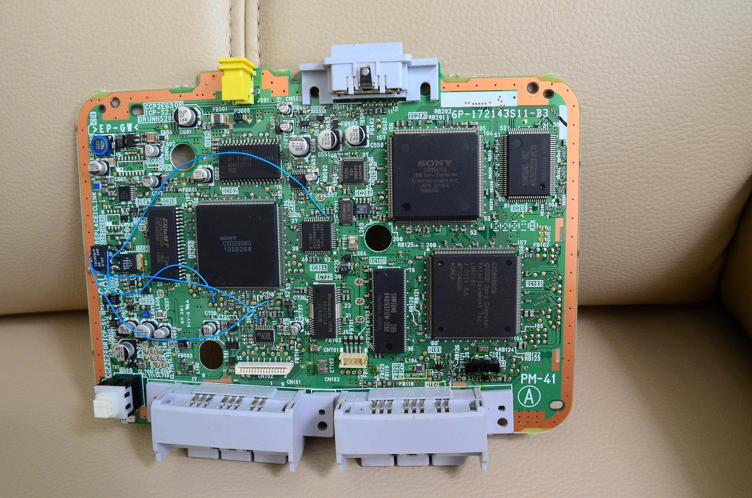

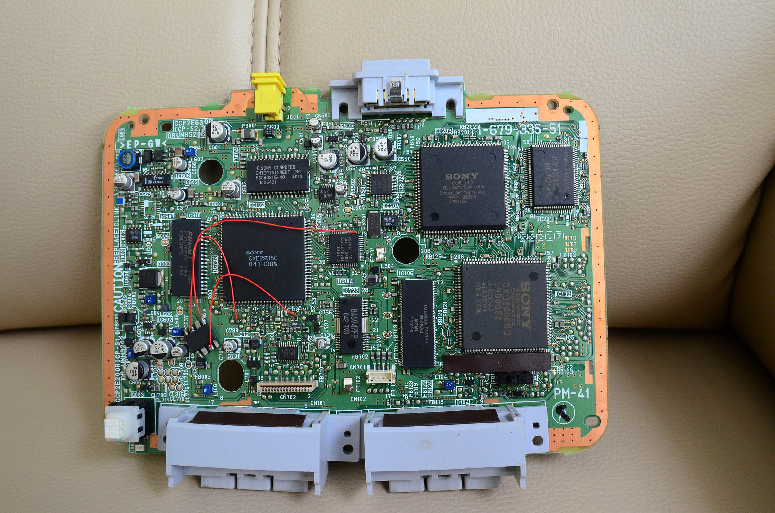

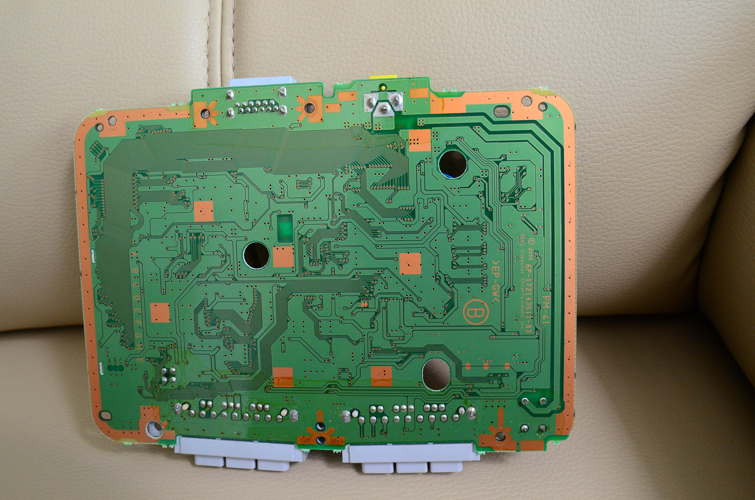

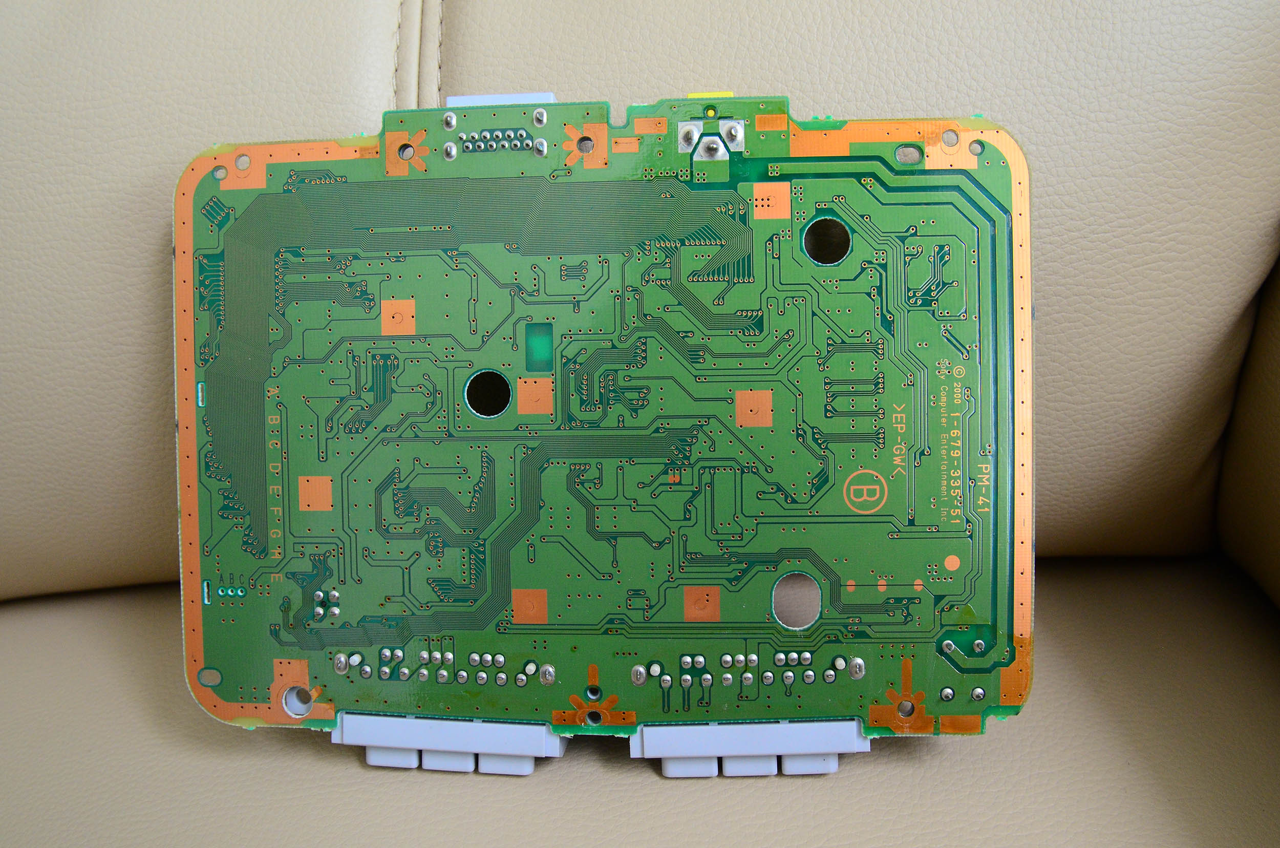

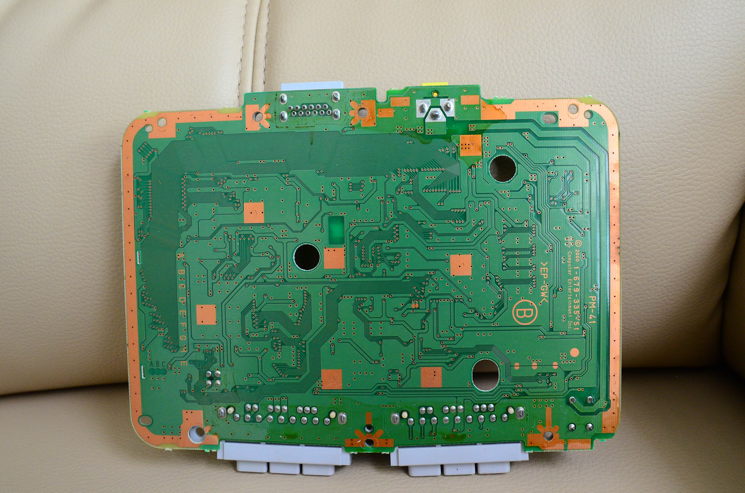

    I figured that I could share some pics of my SCPH-101, SCPH-102 and 103 for references sake.
    SCPH-101 Front
    SCPH-101 Back
    SCPH-102 Front
    SCPH-102 Back
    SCPH-103 Front
    SCPH-103 Back
