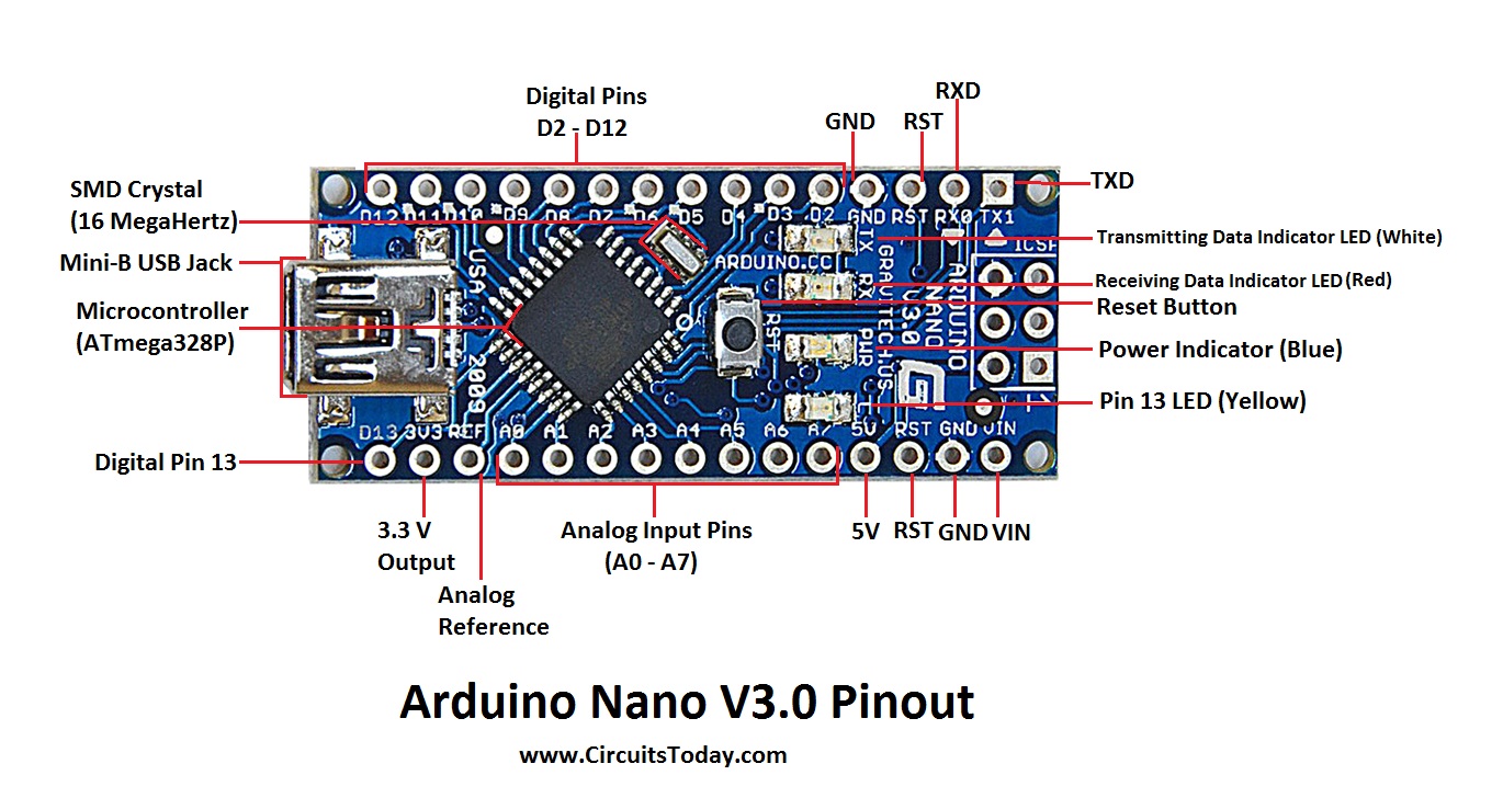

    I'm not super familiar with arduino stuff... How do I tell if its 16mhz?
  2. Gunstar
    Gunstar Member
    Apr 9, 2014
    According to this vid you might be able to tell from code on the SMD Crystal/Ceramic resonator:
    8xx - 8mhz
    A.x - 16mhz
    Might also be able to google the model number on the regulator if it has one written on it. Not sure if the Nano V3.0 comes in 8mhz but I only did a quick search.

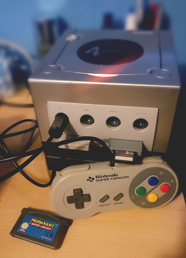

    Success! So the dual 3.3v/5v 16mhz Pro Mini is definitely the go to Arduino for this mod. I got a couple delivered today, installed it and I have a working controller, no worries!
    Excellent mod, and saved me so much money over that stupid Hori controller.
    Images of mine:
    sa1, Gunstar and Bearking like this.
