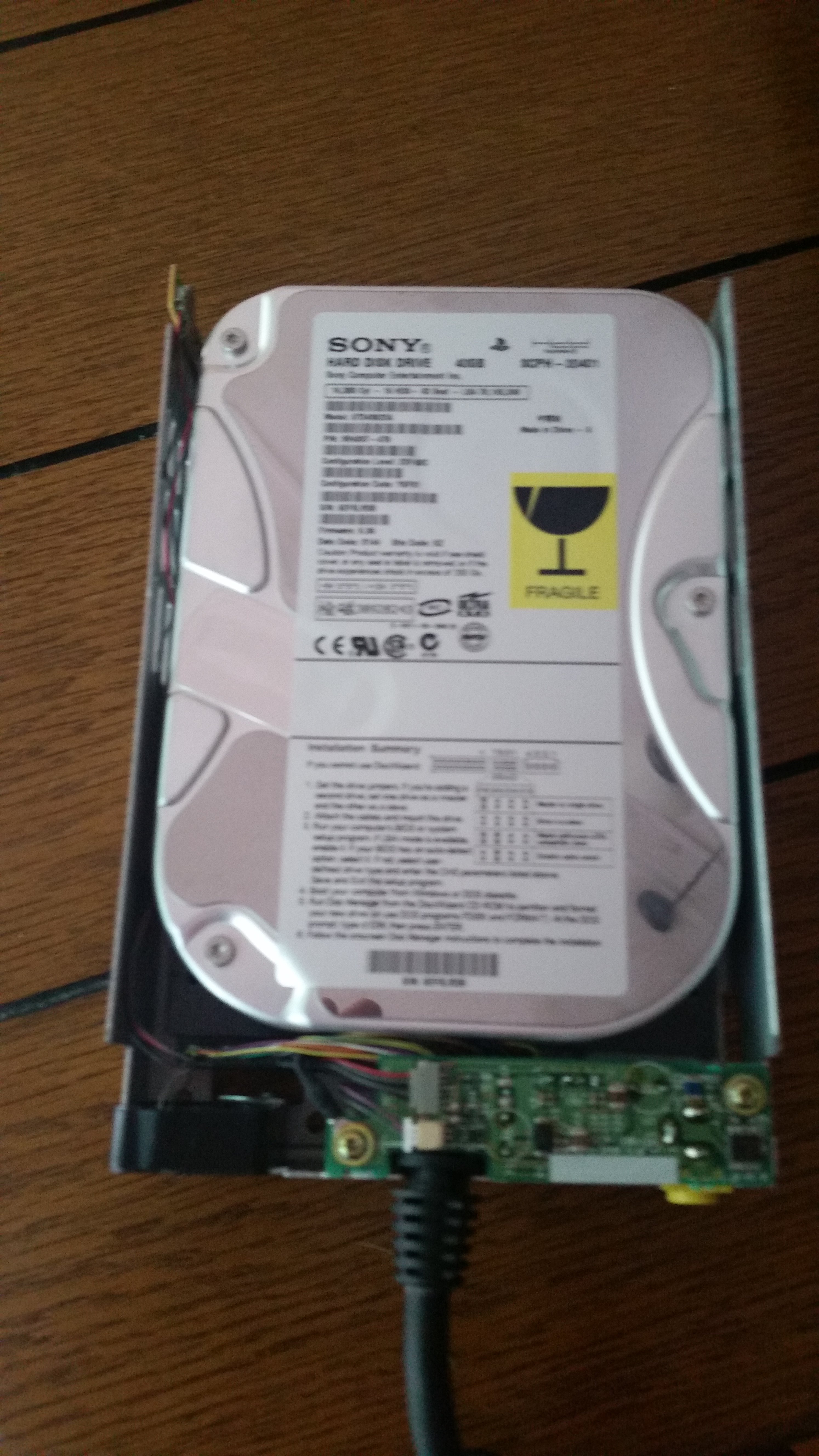

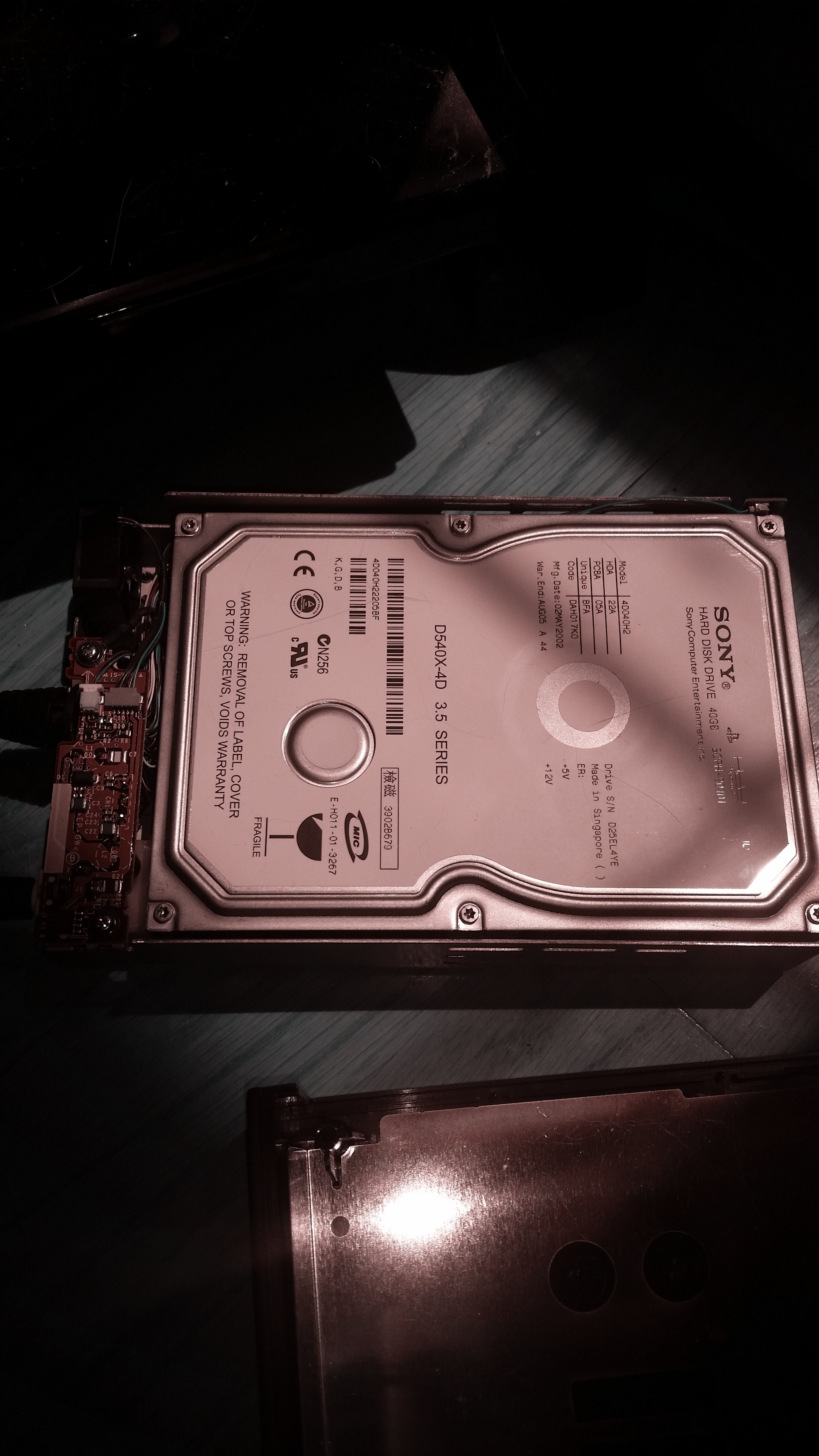

  4. Agent21KGB
    Agent21KGB Active Member
    Mar 27, 2016
    44
    Hdd 1 the one i can format.
  5. Agent21KGB
    Mar 27, 2016
    44
    Hdd 2 the one that will not format in ule.
