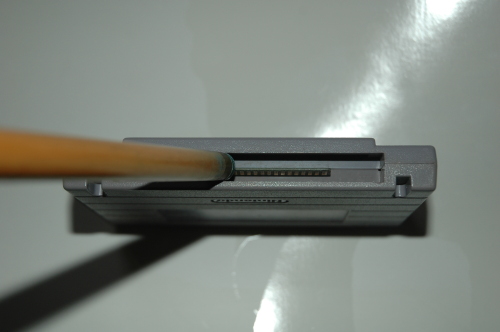

  10. retro
    An important note...
    As a result, the following will not work!
    On a serious note, just use cotton buds (brand name Q-Tips in America, not cue tips, those are for pool cues) with contact cleaner (isopropyl alcohol), as stated. DO NOT use pencil erasers. These will just smear rubber over your contacts and leave deposits.

  12. emu_kidid
    emu_kidid Enthusiastic Member
    Jun 28, 2008
    524
    lol, yes, a q-tip, btw, you have too much time on your hands if you took that picture yourself :) I also take the PCB's out whilst I'm cleaning the cart because a lot of grime tends to build up in between the two halves of the cart.
