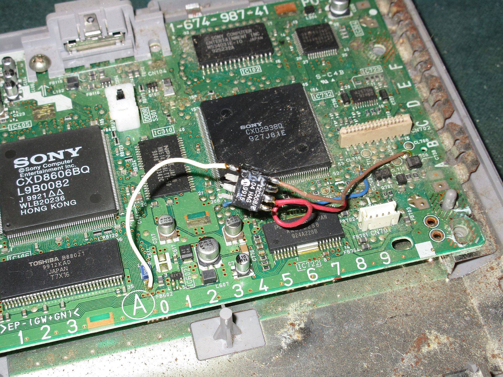

  7. ElectricCo
    ElectricCo Rapidly Rising Member
    Jan 12, 2013
    80
    Is there a way to identify which modchip one has? Like a homebrew or something?
    I bought a couple of modded consoles, unaware of it. Never liked the idea because of laser wear and stuff. But to my surprise, these seem to be in really good shape (laser wise), although they need a new disc spindle. Not sure what models they are now but wondered how can I ID the modchip. Both are a 3-wire modchip and a (blue) jump wire. The only different thing I noticed was that it outputs an NTSC signal during boot, which I didnt even knew my tv supported. I've only tried a couple of pal original games on it (console is pal, I belive 500x model).
  8. master991
    master991 Enthusiastic Member
    Jun 4, 2012
    597
    woa! rust modchip model! XD
    i'm kidding, it's a classic oldcrow modchip
    Shane McRetro likes this.

  10. Mord.Fustang
    Feb 17, 2013
    818
    182
    You can narrow down which modchip it is by looking at install diagrams for modchips and finding ones that match and also finding out which PIC it uses (12C508 in this case).
