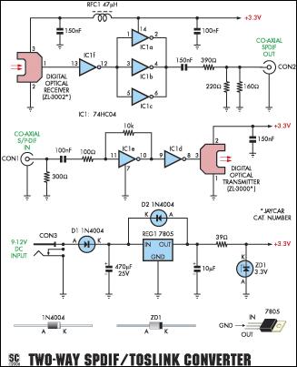

    I'm just confused here. The bandwidth properties of the optical-via-transceiver and co-axial signals are the same, they are just different voltage levels. The signal from the transceiver is 5V TTL, and the signal from the co-ax is 0.5-0.6Vpp. Either should be happy to go through a relay. (In fact, the TTL signal would give less of a crap about the impedance of the relay)
    If you have a look at this conversion circuit:
    There is no manipulation of the signal going on, just some passives and a hex inverter (which is being used as a buffer here, see how the signal goes through the gate twice). It'd be pointless converting both ways.
    So by my reckoning, the easiest way to switch your SPDIF signal would be the same way you're switching your other signals. Just go from the receiver's data pin to the relay, then from the relay to the transmitter's data pin. Simple.

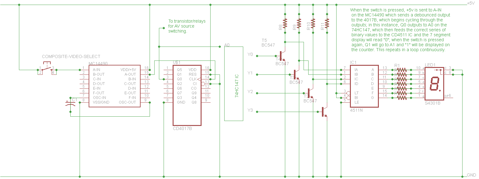

    BTW, did some research into your suggestions above and have thrown together the following circuit theory in Eagle to demonstrate how to get the push button to trigger a count on a 7 segment display:
    Another circuit I found that might also do the job is this one - not sure which would be better though, or if I'm even on the right track with the circuit I posted. Apologies if the circuit is messy, I'm still learning!!
