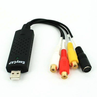

    If you only want to capture SD footage (guessing since you said DVD recorder) you could try an EasyCap, it would be the cheapest way. Just make sure you pick up the DC60+ instead of the regular DC60, the regular one can have some problems with certain signals, the + version fixes those issues.

    Yeah, just SD is fine since retro consoles don't output higher than that. I was hoping to be able to record RGB from SCART for better quality.. :)
