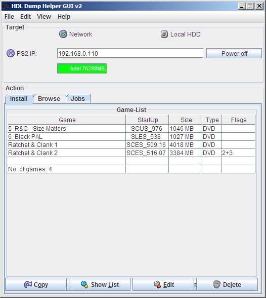

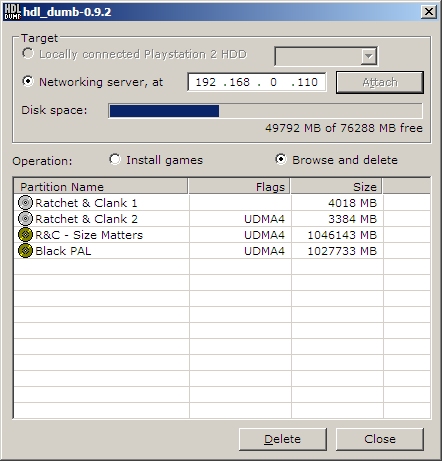

    Hi!
    Same config, same hardware and so different results? Strange...
    SMAP and so the installer uses UDP?
    And, i install 2 games via 0.6MB/s ethernet for testing.
    One game ~3GB and another with ~1.7GB are both shown with a size of ~1GB.
    It seems the installer kills something. Bitmap?
    The installer really don't like the dms4pro in my v7. -> Black screen.
    Without the turned on dms installing from a backup dvd fails. Fun!
    Rgds.

    That's for the HDLDump server. Yes, HDLDump uses UDP.
    And no, it's not impossible if auto negotiation acts up and this new server ends up connecting with 10Mbit Half-Duplex.
    Could you please not use HDLDump to check the installation state of the games? I don't know why, but sometimes it doesn't work right. Especially for those games that are larger than 4GB. Just look at those numbers shown by the HDLDumb v0.9.2 UI... that's over a thousand Gigabytes. The HDLDump helper doesn't work properly at times too, and you get weird game sizes.
    I haven't really checked how uLaunchELF determines the size of the installed game, but I think that it works fine.
    You've seen nothing yet. ;)

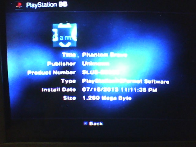

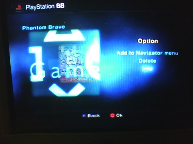

    EDIT: OK so it now has a icon on the HDD OSD but not BBN :/

    Sorry, but what do you mean by it doesn't have an icon shown in the PSBBN? Do you mean that it doesn't appear there at all? Or do you mean that it shows a standardized icon that indicates that it's "legacy content"? The latter is normal, while I think that richi902 reported the former before, but I don't know why that happens because I followed the Sony specifications and it works on all the HDDOSD versions. D:

  9. fate6
    May 15, 2013
    973
    351
    Thanks ^__^
    The reason I use it is cause I like how it looks and yes most channels are dead but the version of BBN I have has access to backups of most of the channels
    oh and the reason I started BBN to even get to the installer is because for some reason my PC wont find the PS2 if I don't do it that way
    (yea IDK what's up with that either)
    thanks again ^__^
    Here are some pictures

    As for psbbn there is no way for injecting icons cause psbbn icons needs pfs file system but hdloader doesn't use any file system at all.
  12. fate6
    May 15, 2013
    973
    351
    Is there a way for me to make the required file? I would like to have everything looking fancy :3
    BTW I'm pretty sure the BBN I have is yours so thanks for that ^__^
  13. sp193
    sp193 Site Soldier
    Mar 28, 2012
    2,217
    1,052
    There's no way to store the resources for the PSBBN to use because HDLoader games don't use the PFS filesystem. The specifications for the PSBBN resource files is in the Sony PS2SDK.
    It's a lot easier to build and to work with than the old HDDOSD way of doing things. :/
    @Richi902: is this what you meant by the PSBBN ignoring the icons? If yes, then it's not a problem actually.
