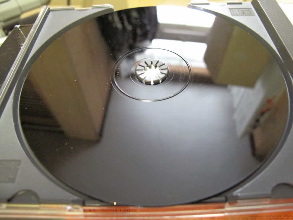

    I am packing and ripping my old games. Hundreds of discs.
    PCE CD games - cd is flawless. These discs date to 1992?
    Sega CD- same discs is flawless
    Psone. Oh. My. God.
    Any fingerprints / skin oil left on the discs? Even if "clean" looking
    when stored? Even trace oil? HEAVILY oxidize the disc surface.
    Does NOT buff out or come off, it is a change in the disc surface.
    This is a big big problem.
    The bottom of psone games, for some reason are vulnerable to corrosion!

  5. ASSEMbler
    I own about 300? psone discs. I bought many of them used for just archiving.
    Picture 1 is of a cleaned and archived disc.
    Pictures 2 onward are of an uncleaned, archived as bought disc which has dirt
    and fingerprints.
    Last pictures show the permanent fingerprints oxidized into the disc.
    Clean disc, cleaned when archived.
    Uncleaned
    Cleaned
    Cleaned with permanent finger marks oxidized in the disc.

  8. ASSEMbler
    well what this is is an oxidation of the black scratch proofing, I doubt the media is going to go bad as the disc play, it just looks like shit is all.

    The narrator states that "black ink is added" which unfortunately leads me to come up with the mental image of someone squirting a fountain pen into a batch of molten plastic. They show a handful of the transparent plastic that they melt to make the disc and then show a disc having some transparent viscous fluid being applied to the top. The inner hub is clearly a black plastic but the reflective metal layer is also clearly visible.
    Unless they skipped the step for adding black in the video as per being a company secret or something. The narrator did say the black was to help prevent illegal copies from being made but I don't think I've ever heard that one before.
    Given CD tech was pretty much mature by the time the Playstation came along I would place my bet on whatever Sony added to make the discs black (or allow the plastic to accept the coloring agent) is what caused the oxidation. Never have I seen a CD come out like that before, even the copy of MYST I've had since 1994 or so and abused heavily as a youngling. Looks like I tried to buff it with 80 grit sand paper but nothing like what your PS1 disc looks like.

    I have a number discs that have clouded. Some are obliviously because of fingerprints I stupidly left but others have no apparent reason. I think the black color just fades over time for some reason and anything like fingerprints, dust particles, ect simply exacerbates it.
    On the plus side it doesn't seem to affect them from playing since every game I've tested still plays just fine.
