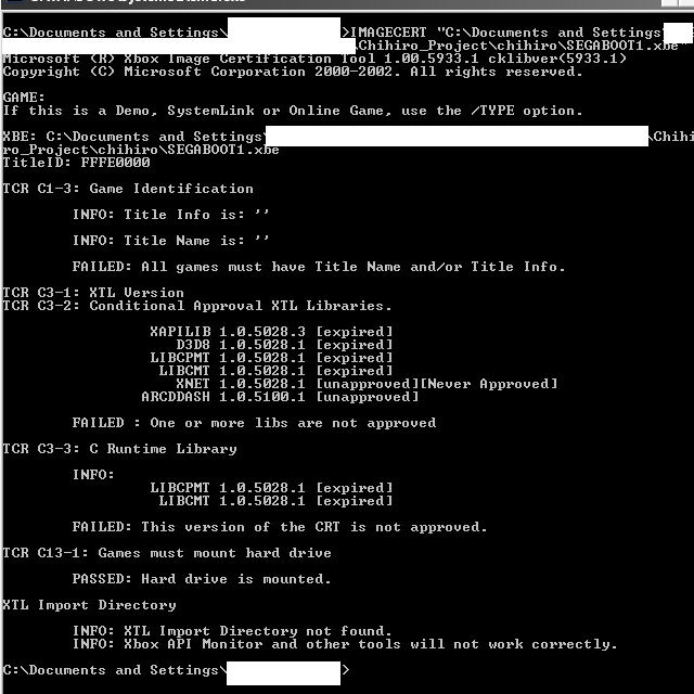

    3 and 4 have no xbeh header, are vxWorks firmware images.
    also, identical to eachother.
    vr feb 07 04:28:47 2003
    do mrt 03 09:03:22 2005
    D:\abe\xbox\SegaBoot\Release\segaboot.exe
    c:\usr\abe\xbox\SegaBoot\Release\segaboot.exe
    all libs: 1.0.5028
    2003 version (segatboot1.xbe) has ARCDDASH 1.0.5100
    2005 version (segaboot2.xbe) has ARCDDASH 1.0.5209
    2005 has NO XNET, probably not needed or more likely included it in the arcadedash
    segaboot 3 and 4 are the vxWorks "firmware"/Os images (what do we call this officialy? kernel?)
    EDIT: "VxWorks OS itself (and application code)" is probably what to describe it.
    "Copyright 1984-2002 Wind River Systems, Inc..This program contains confidential information of Wind River Systems, Inc..and disclosure and copying are prohibited"
    Not sure about what your log of segaboot3/4 is telling, could be it is loading the default libraries or "thinks" it should load this...
    but sure I do not see any xbox headers or libraries.

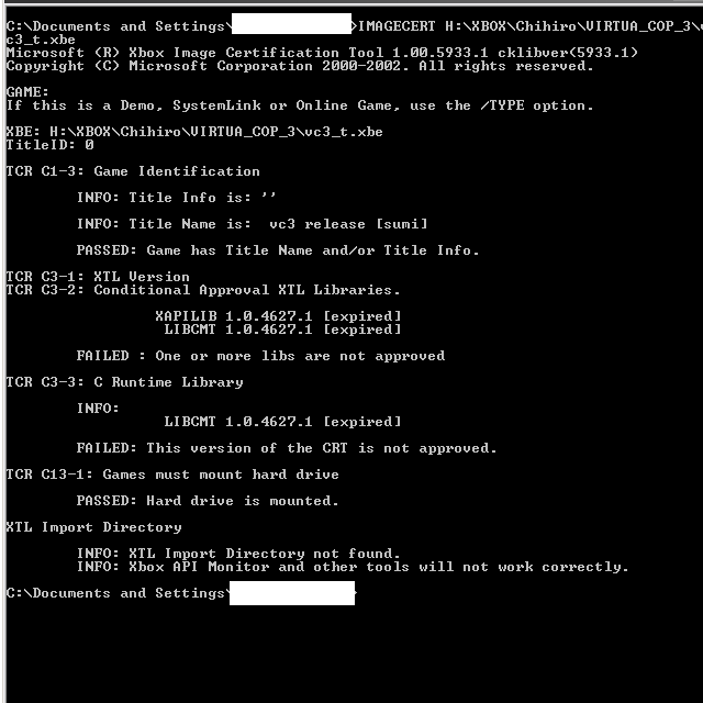

    Anyway, vc3_T.xbe is quite old... D:\user\sumi\vc3\test\TestLaunch\vc3.exe is compiled against most 4627 libraries if im correct. maybe segaboot needs to be similiar? did not do any testing on my xbox/devkit or chihiro (wich is currently dead anyway)
    EDIT: You said earlier:vc3_t.xbe (option mode version) launch Image Certification Tool with 4627 version, after the .xbe call in the HDD vc3.xbe , it seems Image Certification Tool success, but crashed after.
    You mean on the PC side some certification tool? or is this suposed to be transfered over the SCSI cable (Virtual dvd, dvd emulation?)
