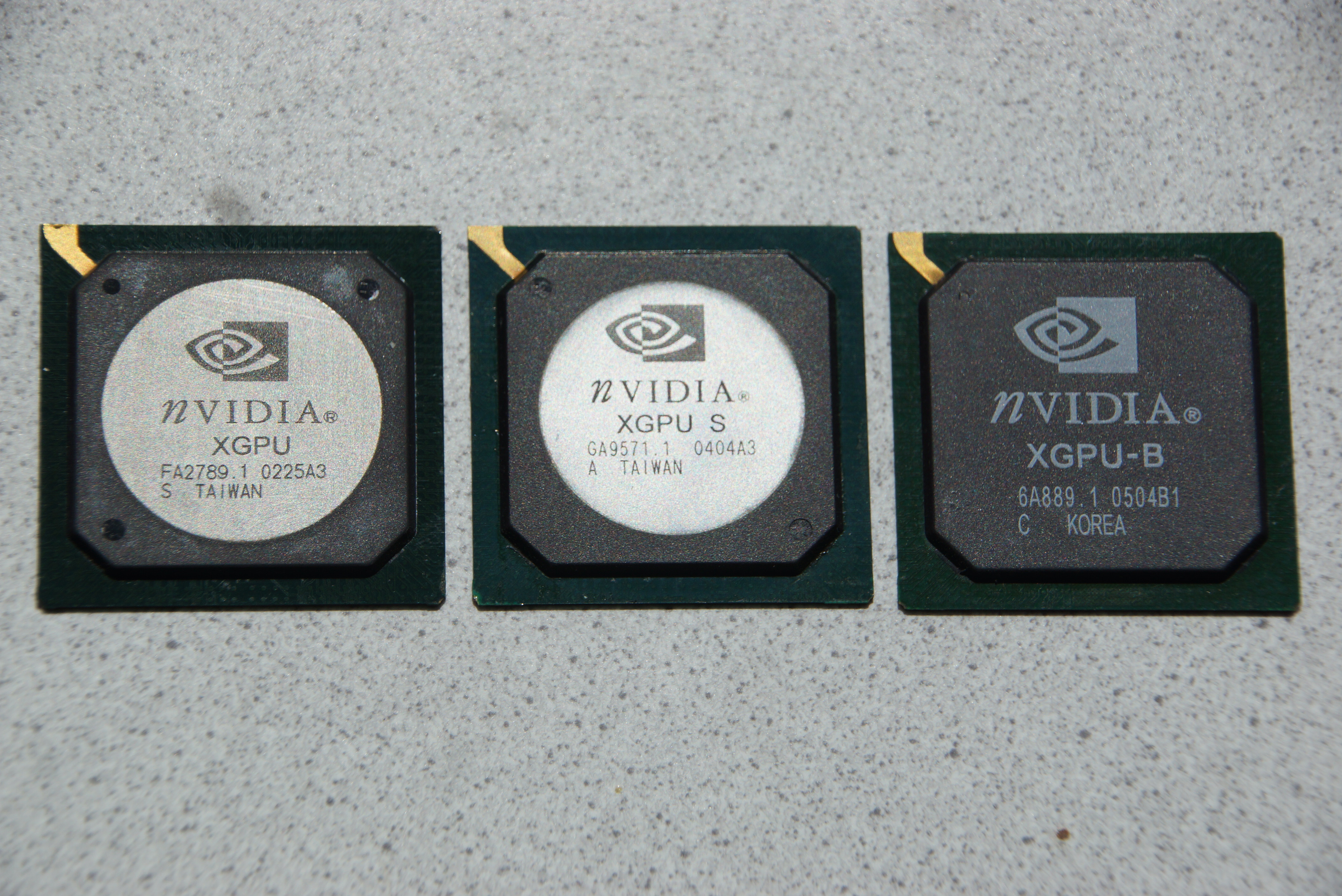

    Here's an interesting thing, the Chihiro XGPU is suffixed "S" where the regular Xbox is just labeled "XGPU". I have them in front of me now.
    It could explain why Ghost Squad gets further when models are removed, it might be a slightly higher spec.
    Not sure however if there really is a difference.

    Thats interesting!
    The "XGPU S" is normally found in newer console revisions like a 1.4 or 1.5 if i remeber correctly.
    Till now i have seen 3 different revisions of the Xbox GPU.
    The XGPU is the first revision, the XPU S was the newer revision and the XGPU B was the last revision found in the Xbox V1.6.
    Would be interesting if there are any differences in those GPU's that a game could check for as a security feature.
