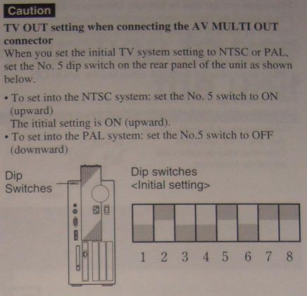

    What Dip switches need to be on in the back?

    The unit was controlled from either the ds* command running on a networked PC under linux, Snsys Target Manager or Metrowerks Codewarrior's utility from a PC under Windows.
    The result is the same wether you do it locally, from a networked machine or a serial terminal.
    Here are the switches:
    What happens if you run ./dsidb instead of ./desb?

    Ok so I have it right with 2, 5, 7, and 8 being on. I don't know but I can find out in a second.
