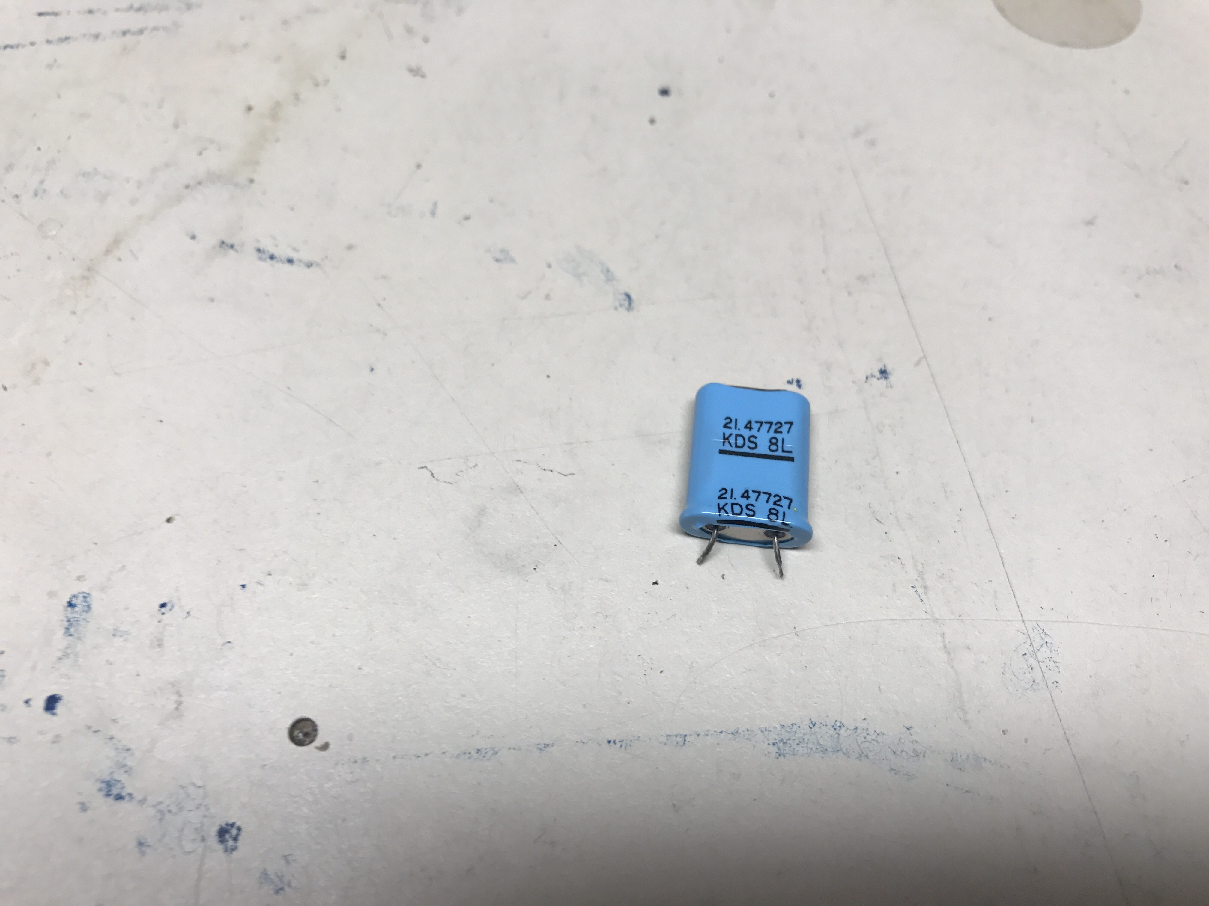

  13. DaveyPocket
    DaveyPocket Member
    Aug 27, 2017
    Need one? This was in my parts drawer. Believe I pulled from a NES.
    Sp33dFr34k likes this.
  14. Sp33dFr34k
    Sp33dFr34k Spirited Member
    Jul 13, 2015
    141
    Oeh, nice! I haven't received my Ali Express orders yet, I ordered the CPU/PPU/crystal as above. My desoldering station is on it's way as well. If I encounter any problems with the crystal I ordered, can I get back to you? :)
  15. DaveyPocket
    DaveyPocket Member
    Aug 27, 2017
    Of course!
