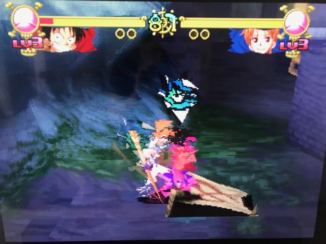

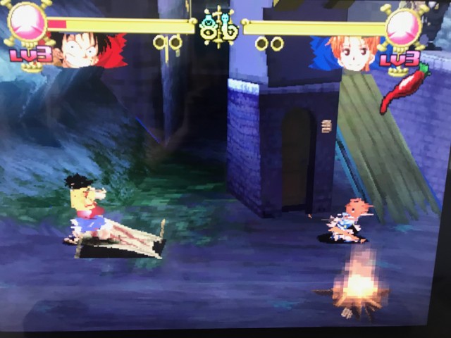

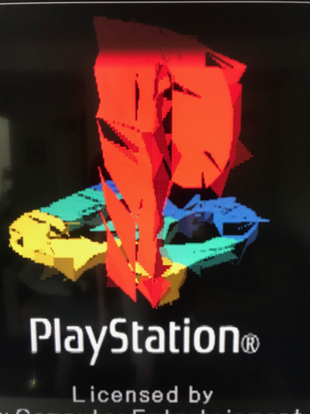

    I have a Japanese SCPH39000 unit that plays PS2 games without issue however when I pop in an original Japanese PS1 disc I'm greeted with this:

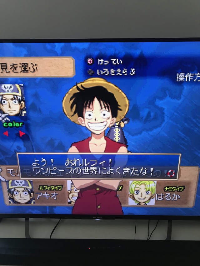

    The odd thing is it exclusively affects polygons, 2d titles perform perfectly:
    Any idea what the issue is?

    A problem with the GTE? Just a guess, but that would explain why it only affects 3D graphics and only PS1 games. Beyond that, I can't speculate.

    PS2, if I remember correctly uses psx cpu and ram from retrocompatibility. Maybe one of those are damaged...

    It uses GTE to display the boot logo? The GPU is emulated using the EE+GS, there could be some weird hardware problem.

    This is indeed an interesting question, given that AFAIK the logo is 3D polygons and is not transformed (rotated, scaled, etc.), (or is it?). But then again, when the actual rendering to a 2D image is done, GTE instructions may be used. I am not familiar with the PS1 3D rendering, but if 3D vertex coordinates are sent to the PS1 GPU (in this case the EE emulating it), then it might be an IOP-EE synchronization issue that is causing this - perhaps due to a broken connection on some of the lines. Note however, that for what I know, all the IOP-EE SBUS lines are used for both PS1 and PS2 mode, so if the cause was there, then PS2 games and maybe even booting the console would fail as well (with the exception of an interrupt line maybe).
    There is even the possibility that there are some test-points on the IOP ASIC related to the GTE, which got short-circuited, resulting in incorrect calculations (but this is far-fetched).
    So what was already suggested - a fault in the GTE - seems to be the most likely reason. This can be checked with a test program, but I don't know if such exists (somebody at psxdev.net or PCSX2 coders might know of such). And there is also the matter that the faulty calculation does not always happen - it seems some vertices are at their correct positions, moreover the vertices that are incorrectly transformed are not far from their correct positions, so it is almost as if the calculation is wrong by just a few bits - otherwise we would be seeing polygons stretching in all directions. So it may be a low-order line from some of the internal GTE buses that got disconnected and keeps at a constant potential. When the coordinates to be processed have that bit in the same level as the line, the calculations end-up correct, and when the (input or output) value has this bit different, it is forced to the state of that line, resulting in an incorrect output value.
    But this is just a speculation, and either way, there is nothing that can be done to fix it (AFAIK).

    bad solder joint via ee or gs

    It seems vertex buffer content is error thus the vertices position is affected.....May be caused by memory problem....

    It's an interesting and rare glitch for sure.
    I'll go with a minute fault on the GTE silicon, maybe a permanently stuck gate on an instruction decoder or so.
    Definitely not external, so fixing it would mean replacing the IOP.
    There is some homebrew that can test a real PSX's GTE. I don't know if it'll work on a PS2 though.
    https://psx.amidog.se/doku.php?id=psx:download:gte
    https://github.com/ogamespec/pops-gte/tree/master/GTETest

    Seems unlikely - the same RAM is used for the IOP and PS compatibility, and since PS2 mode apparently works fine it's hard to see of how the RAM could fail in a way that only affected PS mode. Unless there is more stuff in there I don't know about, I would have to go with it being a problem with the GTE. Having said that, I don't know for sure if the GTE is used for rendering the boot logo, although since it's stored in .TMD format it seems likely.
