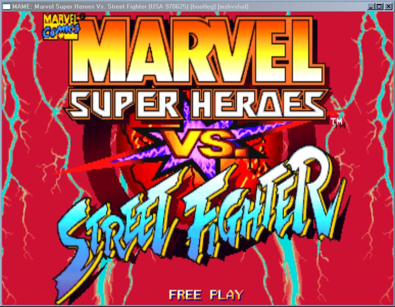

    I happen to have a dead Marvel Super Heroes vs Street Fighter CPS2 game and I never seen a "Phoenix Edition" version of this game so I went and made my own:
    For those who don't know, the sprites are at wrong positions because the changes needed to make it work on the real hardware cause the program to write data at wrong offsets. Causing that effect on the emulator.
    Was quite a challenge figure out how to split the data from code but once I figured out how to do that it was easy-peasy. :thumbsup:
    P.S.: This post contains no copyrighted code.

    The hacked ROM writes graphic data to different I/O addresses on the 68000 memory space (to allow it work on the no battery board) but the emulator I used for testing (Nebula) expect it to be a regular ROM writing to the proper memory, hence the wrong graphics.
    A "Phoenix edition" ROM would do the exact same thing on emulators.
    I finally took my time to download mame sources (mame supports the memory map for dead boards) and added it to mame database.
    It works on Mame with correct graphics if it's identified as "Phoenix edition"/"Bootleg" :thumbsup:

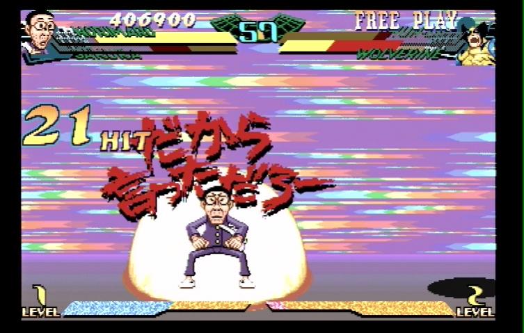

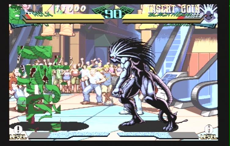

    Update:
    Plays on the real hardware but need some more work (see the second picture)

    Whats wrong l_oliveira thats normal looking for one of my pcb games
    nothing is wrong.;-)

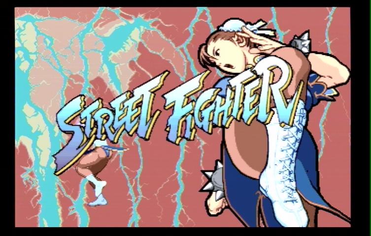

    Turns out there was nothing wrong with my hacked ROMs.
    There were wrong settings on the board configuration jumpers (I've been playing with game swapping in it so I had it configured for EPROMS, :evil: so I undid the original ROM jumper settings)
    Now I've fixed the jumpers and the game screen look like this:

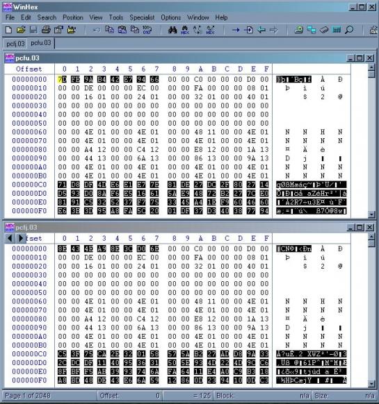

    Have you ever tried to compare two CPS2 roms of the same game/revision with mismatching regions, while encrypted ?
    Take a look at the attached picture and judge by yourself...
    Picture contains the 68000 interrupt vector table for the game Pocket fighter, pictured are the region which isn't encrypted. initial values of SP and PC are the first four bytes of the file. Non-encrypted data will match on both files. By logging where the original encrypted ROMS are equal (using a 16 bit compare algorithm) I can "punch holes" on a XOR file I generated from a DASM list of the decrypted ROM (using MAME with debugger) along with the original ROM file and then after I have the said XOR file with the proper "holes" (areas on the original ROM that contain data are zeroed out on my modified XOR). I only need to apply another XOR operation to the original file and my modified XOR to obtain a perfect, unencrypted dump.
    Pretty slick, huh ? :lol:
    Saves time for games that multiple regions under the same revision do exist. But then if you think of games like "Quiz Nanairo Dreams - Nijiirochō no Kiseki" which only one region exists, it's impossible to apply this method. So heavy analysis of the ROM may be necessary.

    And relax, on the real thing the graphics are just fine:
