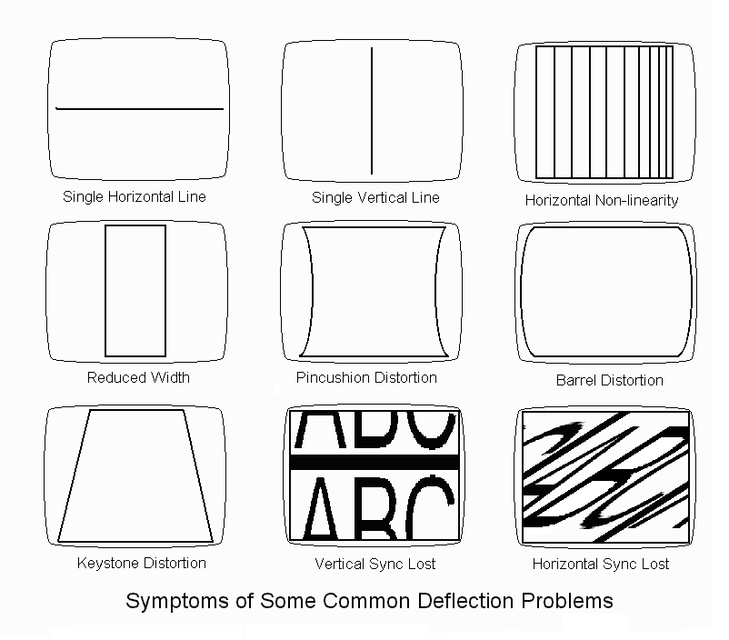

    Sorry to dig up an old thread. If my CRT is warping towards the edge of the picture, what settings could I adjust to straighten this out? More than happy to post the 240p test suite pattern from my Trintron CRT with the Service Menu values on it.
  9. Kaeser
    Kaeser Active Member
    Jun 15, 2016
    49
    Take a photo of the grid pattern for starters. Here are some examples of what might be going on [​IMG]
