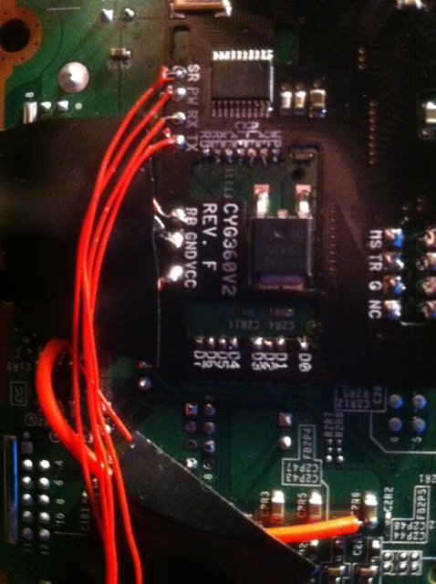

    My friend had a falcon 360 that he could not read the nand on. He sent it to me and I tried both my nand x and my jr programmer. Jrunner would say flash config 0x00000000 can not continue.
    I tried both top and bottom point's. I even reflowed the south bridge as someone suggested to me.
    So I had a cygnos v2 rev f and e sitting here and decided to try that to read the nand.
    Downloaded the latest cygnos toolbox app. installed driver's.

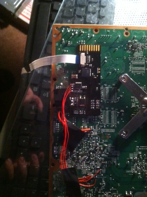

    Then soldered in the cygnos. Work's great. Read the nand 2 times really fast too.
    Tomorrow I will install a coolrunner rev c in it and rgh1 it to latest dash.
    Figured I would share this in case someone else has this problem reading the nand on a xbox360.

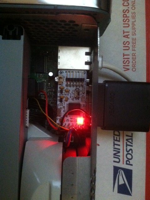

    Right...well it's all done. I installed a coolrunner rev b and it boots in 1 sec...updated to latest dash on jrunner(16537)
    The one problem i ran into was writing the ecc file to the nand....since i couldnt use a nandx or jr programmer in jrunner i had to go old school. I used nandpro in command and injected the ecc file i created in jrunner to the original nand. I had to use a old laptop i had with windows xp too becasue nandpro didnt like windows 7. Then I used cygnos toolbox to write that nand and boot to xell reloaded to get my cpukey...
    Then created a new hacked image and used cygnos to write it again. Literally took like 10 sec's to write the nand..super fast with the cygnos.
