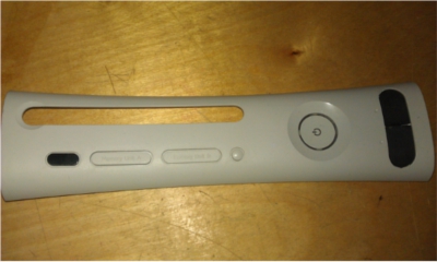

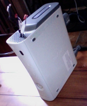

  18. jaunelapin
    jaunelapin Spirited Member
    Oct 25, 2011
    195
    88
    The poor Kit :/
    Not because of you, but because of the guy who updated a nice Beta Kit, and then even a white one with those neat Argon readout cables (2 red plugs, 3 wires, each?)
    And no, these wires don't cause problems, they just indicate what kind of Kit you have there. These are not too common nowadays.
    By the way, many Beta Kits behave weird, if it's just the accelerometer, I wouldn't worry about that though.
    Would be quite interested to see that Dash though, just to see what the modder did to it :)
    it will be similar to this, I know of 3 kinds of Kits like these, 1st: as pictured, 2nd plain white without logos, 3rd same as second, but with a faceplate as seen on the 2nd pic.
    (I guess these pics show enough detail for the public?)
