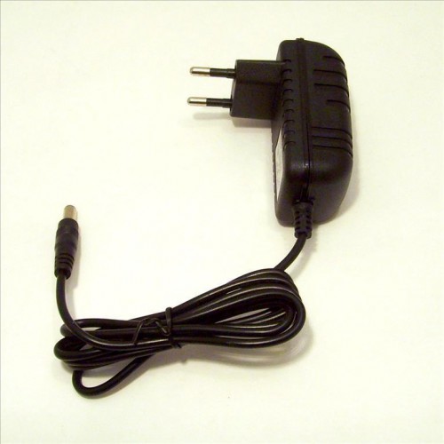

    Also, is it enough to use a EU SNES power adapter to power an SFC?

    The power adapter I'm not sure about and you must be very careful. The SFC wants something like 10V DC, Center Negative. So long as your power adapter can output 10V (or 9V is ok) with Center Negative and providing 850ma or more of amperage, you should be ok. Hopefully someone in a PAL territory can respond with better certainty.
  3. Bad_Ad84
    1,309
    PAL Snes PSU's are AC.
    Either polarity DC adapter will work on a PAL snes as it has a rectifier in it.
    Dont know about the SFC, but if it wants DC like the US one - dont use a PAL snes adapter on it.
  4. TriMesh
    Jul 3, 2008
    2,324
    The SFC is just like the US SNES - it takes DC, 9-10V, -ve center - and it gets very upset if you try and run it from AC.

    Not quite, the inside of the tip on the console end is slightly bigger on both the PAL NES and PAL SNES than it is on the NTSC NES.

    Thanks alot for the PSU info, thanks to that and google I found a local shop that sells european SFC PSUs (for about €5).
    @Bad_Ad84, TriMesh & ApolloBoy
    Yeah, after the info Mottzilla shared I found out that you need a custom PSU, which can be easily attained :)
