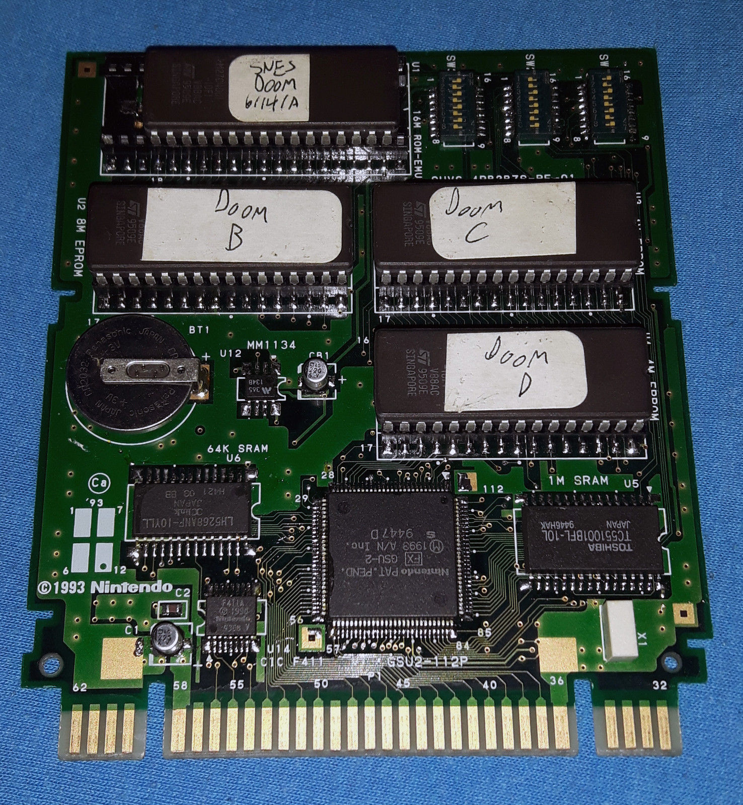

    i got my hands on a SNES FX2 Development board with DOOM Roms on it.
    First at all the board is legit as you can see on the picture. I compare a dump from the seller with the Final version and it is 100% the same without any differents. The Seller did not dump it. He got the dump from a friend. So im not total sure if this dump is really from the board at all..
    I have to check it when it arrive.
    My question for now is: Have any prototype or sample cart small differents like the header compare to the final version? Or can it be 100% same data as retail?
    What did you think, the chips looks legit? The eproms are from 95 what is realistic.
    regards
    Chris

    Yes, not unusual.

    It's certainly not unknown to have a prototype board with the final code on it. That the board appears to have been hand-soldered is rather unusual, although not inconsistent with the nearly a year gap between the PCB production date and the parts on it.
