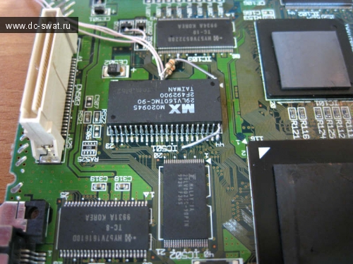

    On a newer Dreamcast do i need to bend pin 23 (Vcc) on the flashchip?
    In this guide it looks like he soldered it to the Vcc pin on the original bios:
    http://www.dc-swat.ru/blog/hardware/16.html
    It sure looks like only pin 1, 12 and 44 are bend in that picture :)
  9. DarthCloud
    DarthCloud Fiery Member
    Dec 26, 2007
    874
    You don't need to do anything with Vcc with your DC, Connect the Vcc of flash direcly to the Vcc of bios just like all others pin.
    The schematic just point you a point where you can take Vcc (3.3v) but your are free to take it from anywhere.
