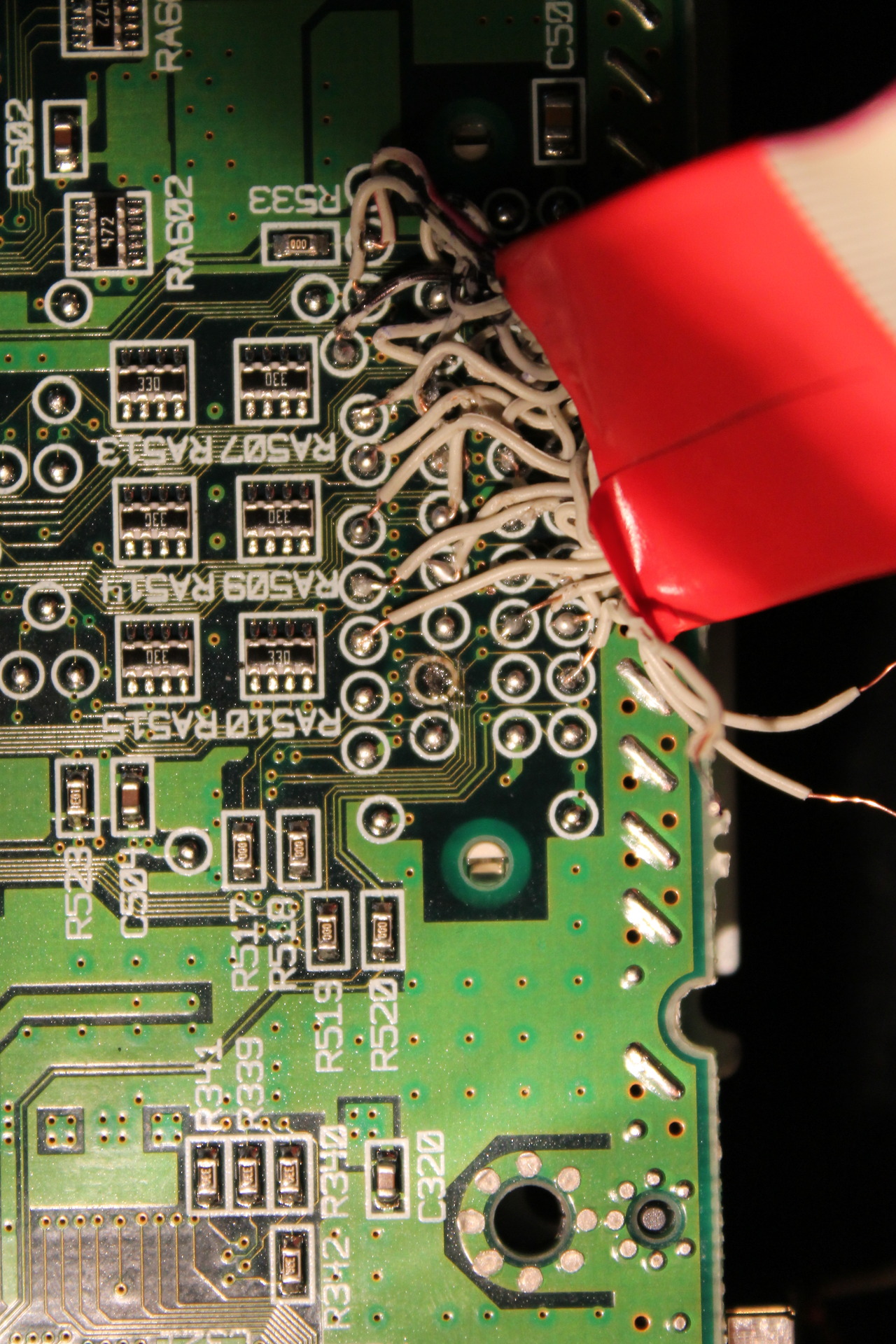

    Hey just finished the ide ata mod.
    I found some pictures and little info about it but did it anyway....
    http://www.dreamcast.es/forum/viewthread.php?thread_id=2127&pid=14132#post_14132
    But I have a few questions do i need a sd card reader to make it work?
    Found out somewhere that the bios needed to be on sd card is this true?

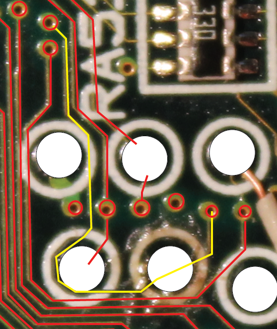

    Here is my connection i broke a trace line at point 37
    But i fixed it connected the yellow line together and dreamcast is booting just fine.

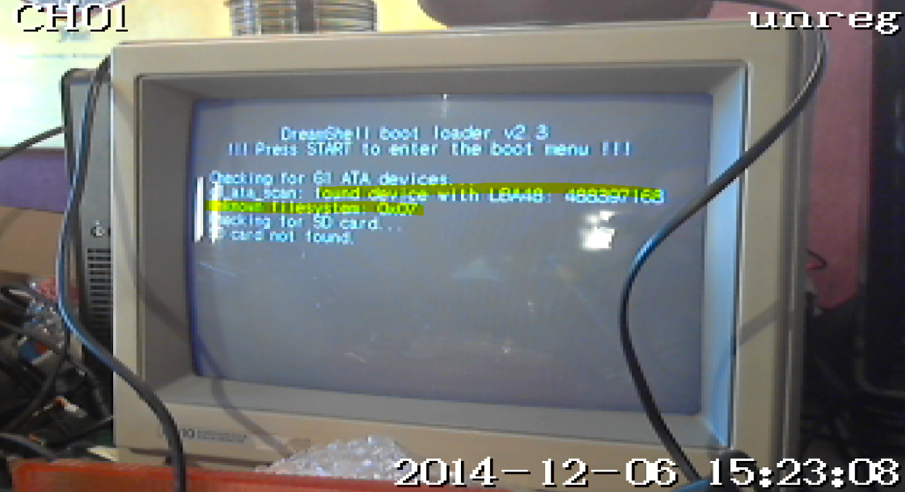

    My Hard Drive is found and file system sometimes will work...
    Screenshot is from when hdd was formatted in ntsf.
    When i format Fat or FAT32 It will mount the drive.
    but it will stop loading after sd card not found.
    when i leave the Hdd power off it will boot in to bootmenu where i can not boot.
    Have Ram and Cd but will not boot. seen a youtube video where they booted from sd..
    i have tried different dreamshells core; bootloader; cdi. but no go..
    Core stops at splash screen when hdd is on. or gives blackscreen
    Bootloader at picture showing above
    Cdi stops at splash screen.
    any thoughts?

    As far as I know it depends by the bios you flashed on your DC.
    Most of them need the Dreamshell files on CD to boot.
    Only one version, with less game compatibility, can be booted by an SD card without the need of a GDrom.
    The last bios I mentioned (ATA working and boot from SD card) can be found here (http://www.dc-swat.ru/page/dreamshell/firmware/) and it's named "sd_loader_with.bios".
    Take note, on that page, that most of the bioses are marked as not passing the "Holly protection". It means, afaik, no ATA initialization.
    Good luck.
