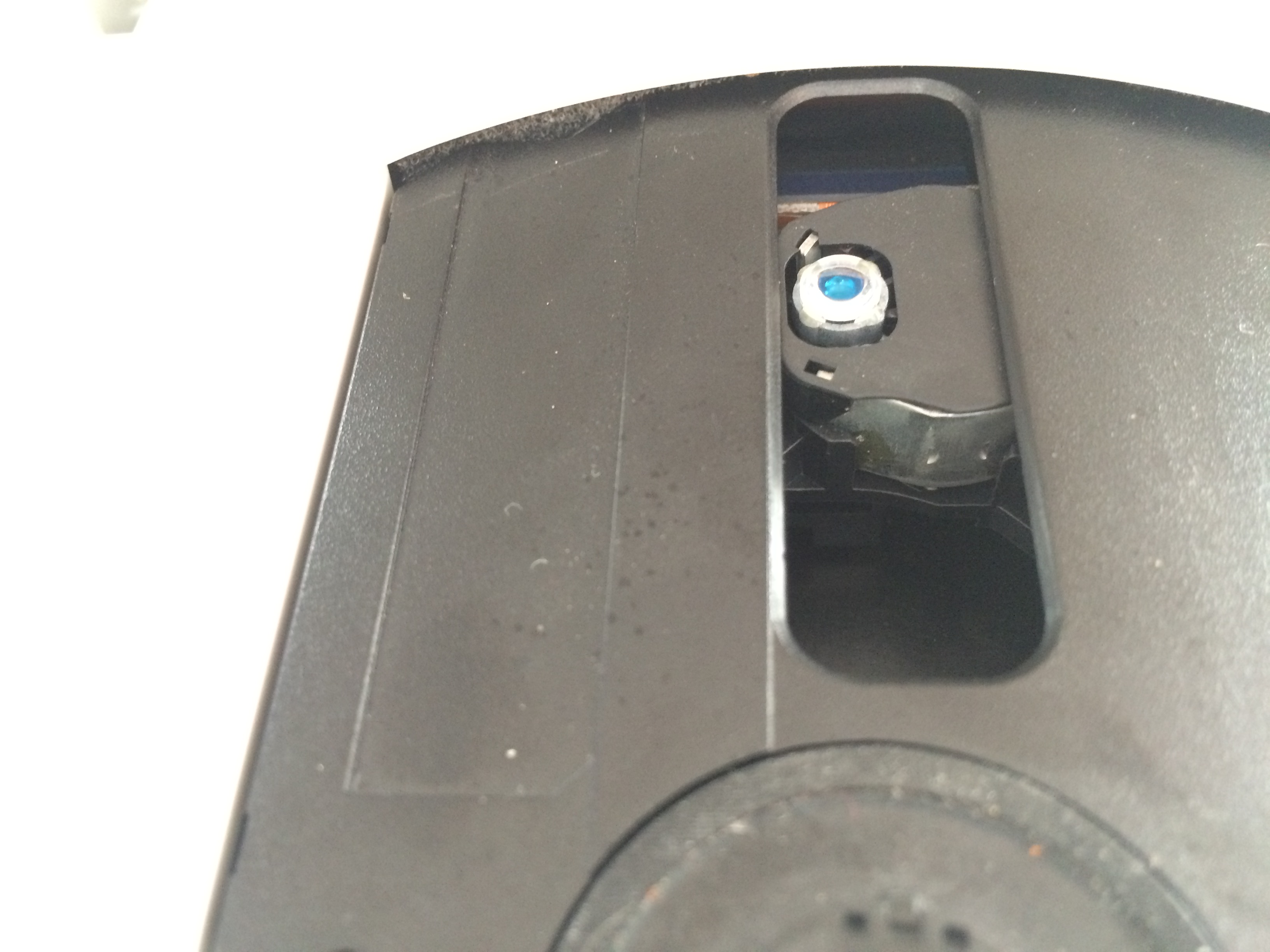

    Weird to see a Yamaha laser with a Samsung disc assembly, and I think I got a Yamaha pickup in this drive, not sure o.0
  13. TriMesh
    Jul 3, 2008
    2,324
    That seems to be a SPU-3200 - maybe it was already swapped by someone?

    OK, I just did some experiments.
    The Yamaha and Samsung pickups are electrically interchangeable - you can plug either of them into either control board and they will work. Mechanically, the Samsung drive has a wider slot in the plastic frame and a different top cover. The overall result is that you can freely swap boards, but you can't replace a Yamaha pickup with a Samsung. You can put a Yamaha pickup into a Samsung drive (still using the original control board) and it works.
    If you try to swap the Samsung pickup into a Yamaha drive, it's physically impossible to install - if you swap over the plastics, too, then it works.
