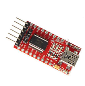

    Recent versions of RT232RL doesn't need a separate level converter circuit, it can operate with 3,3V directly.
    You can use a pre-made board like this, it has a jumper set so that you can choose between 3,3 or 5 volts:
