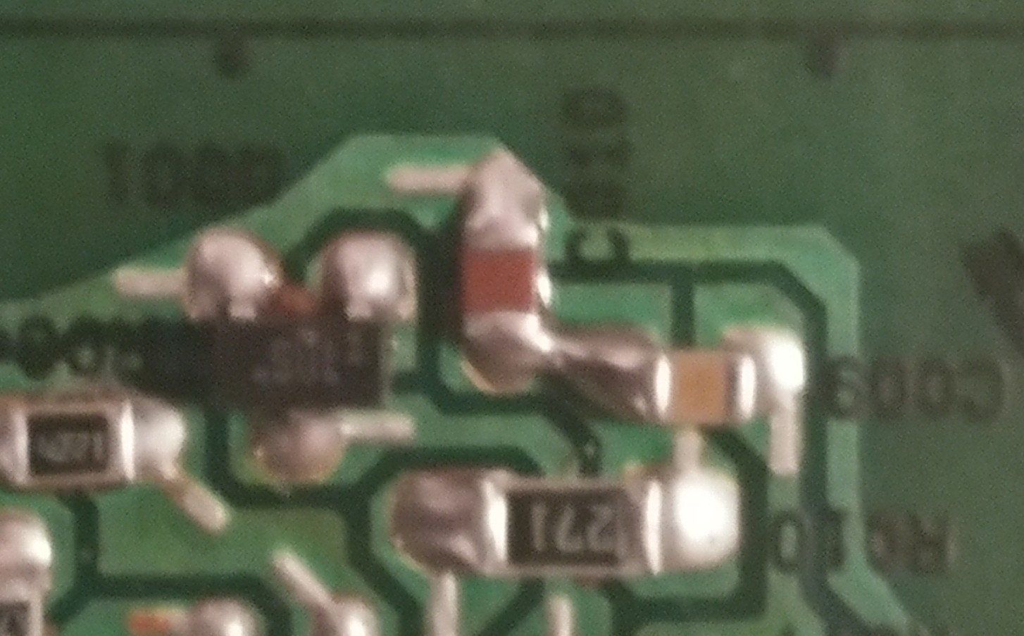

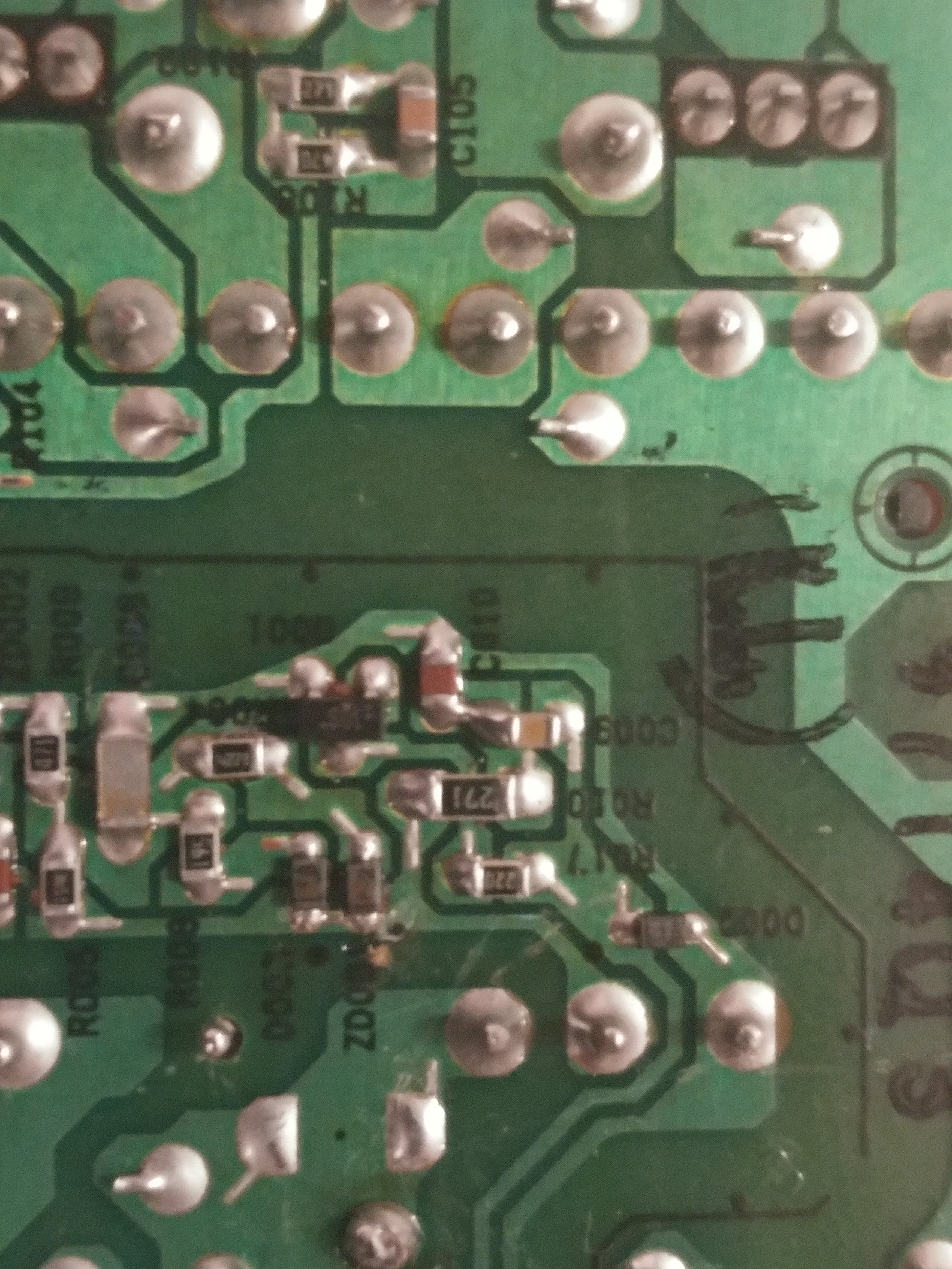

    Both replacement parts have finally arrived, the DF08M came a bit earlier, and just to check I replaced the old one with a new one, and the problem still persists. I got delivery of my 2SK2129 today, and I was going to replace it, but I had a look at the board again and I saw two resistors kind of soldered together. Could this actually be the problem and not any other components? I did have a look at the board multiple times beforehand, but I never noticed this before. I'll wait for a reply before I go about replacing the 2SK2129, perhaps I won't need to expose the board to unnecessary heat? Thank you.
  4. Bad_Ad84
    1,309
    No, looks like those parts are connected via the pcb anyway. So having the solder there does no harm.
