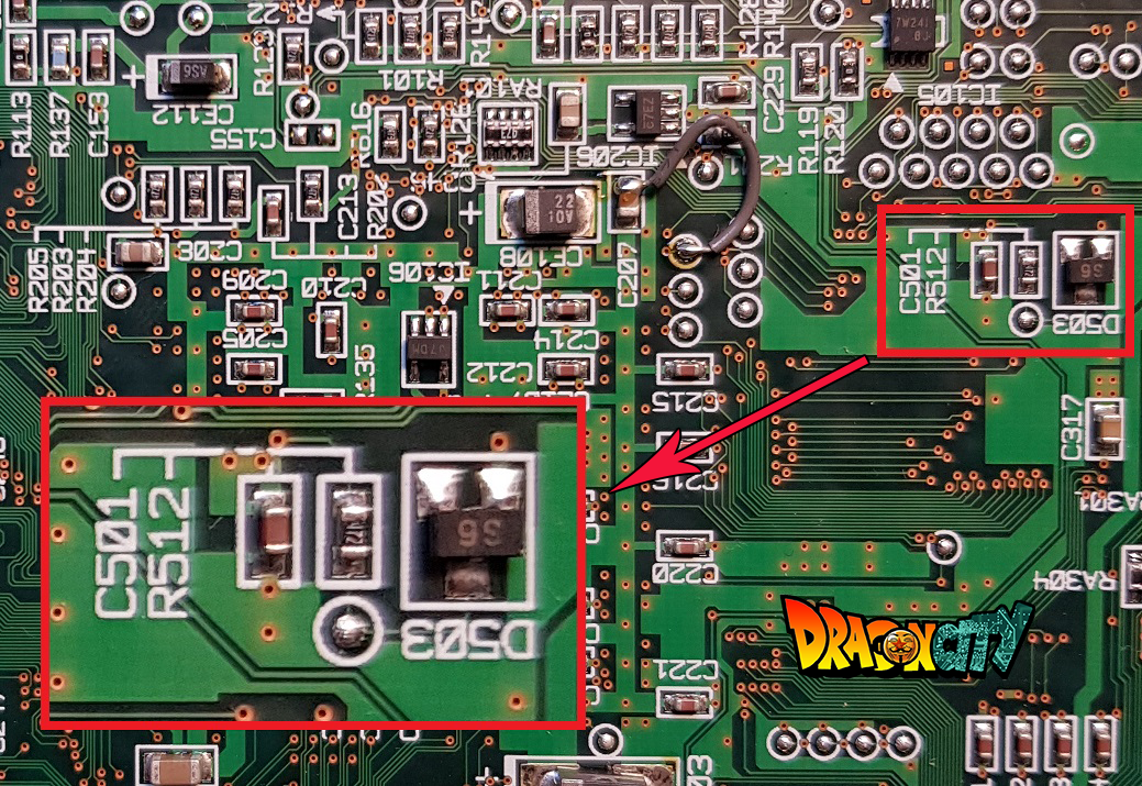

    Do you know if it's possible to change region (with Dreamcast Region Changer) on JAP VA0?
    Because I tested,and nothing change...I read in some forums that it was not possible...but maybe now you have found a solution? [​IMG]

    I think it depends on which boot ROM is installed. I had one early production Dreamcast (one of the Japanese ones that came in the box with Yukawa on it) and the region changer didn't work on that. I also had a later unit (still VA0) where it did. The only thing I can think of is to open the unit up and change the boot ROM to one of the later ones that uses the contents of the flash to determine region.

    Ok I found the solution with Megavolt,need to change the bios with freezone or dreamshell,and after you can change the region changer :)
