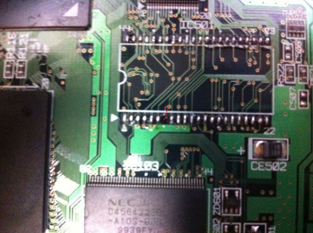

    pad 7 of the bios is A4
    Pin 17 is A4 on the IC502
    Connect them together, as they are on the same bus.
    I can also make out the trace just from your low res picture.... you might need glasses! lol

    I see, thanks Bad_Ad! What do you think about the idea I posted on the previous page? Would that not work? Not that I don't trust you, but following the trace myself, I could swear that pin 17 (counting from 20, right to left) on the IC502 leads to pin 8 on the IC501. And I'm using a magnifying glass here :p

    What idea? Connecting it to pin 7?
    Why would that work? you dont just connect up pin 7 to leg 7... the chips have completely different pin out. Following that logic, Pad 44 will connect to leg 44 on IC502, which doesnt exist.

    Here is how I am seeing it:
    If you have a multimeter, you can confirm by checking for continuity between the via right next to pad 7 that you ripped off (the little hole above it) and check that to pin 17 on IC502. It should be directly connected.

    Actually, my idea was more like this:
    But it would probably be best to go with what you're suggesting ;)
    *EDIT* I've checked the trace with a multimeter, and unless I'm completely failing at using a multimeter (I've only just purchased one recently so it's possible!), it's responding on leg 16 and not leg 17 :\

    What you suggest is how I would do it.
    If you think your soldering is up to it, then do it like that.

    Sweet, that also solves the problem of if pin 7 is connected to pin 16 or 17 too :D Thanks again for your help Bad_Ad!

    Are you sure you are counting the pins correctly?
    it should be the 4th one from the right
    17 18 19 20
    Common mistake is counting 3 back from 20 to get to 17

    Pretty sure I'm counting it correctly. The pin that's responding is next to the pin with the white dot (pin 15 I'm assuming) on the right. This also is the pin that I'm arriving at when I follow the trace from the broken pin (damn you white text!)
    Either way, I think the easy and safe option is to do what I depicted in the picture above :)

    I will check a board when I get home - just out of curosity sake.
    Its possible the address lines do not match 1:1, but I was pretty sure they did.

    Well, I've installed the new BIOS. The DC hasn't exploded and the main menu loads, so I think it was a success :D

    It does indeed connect to pin 16 (A5) rather than A4.
