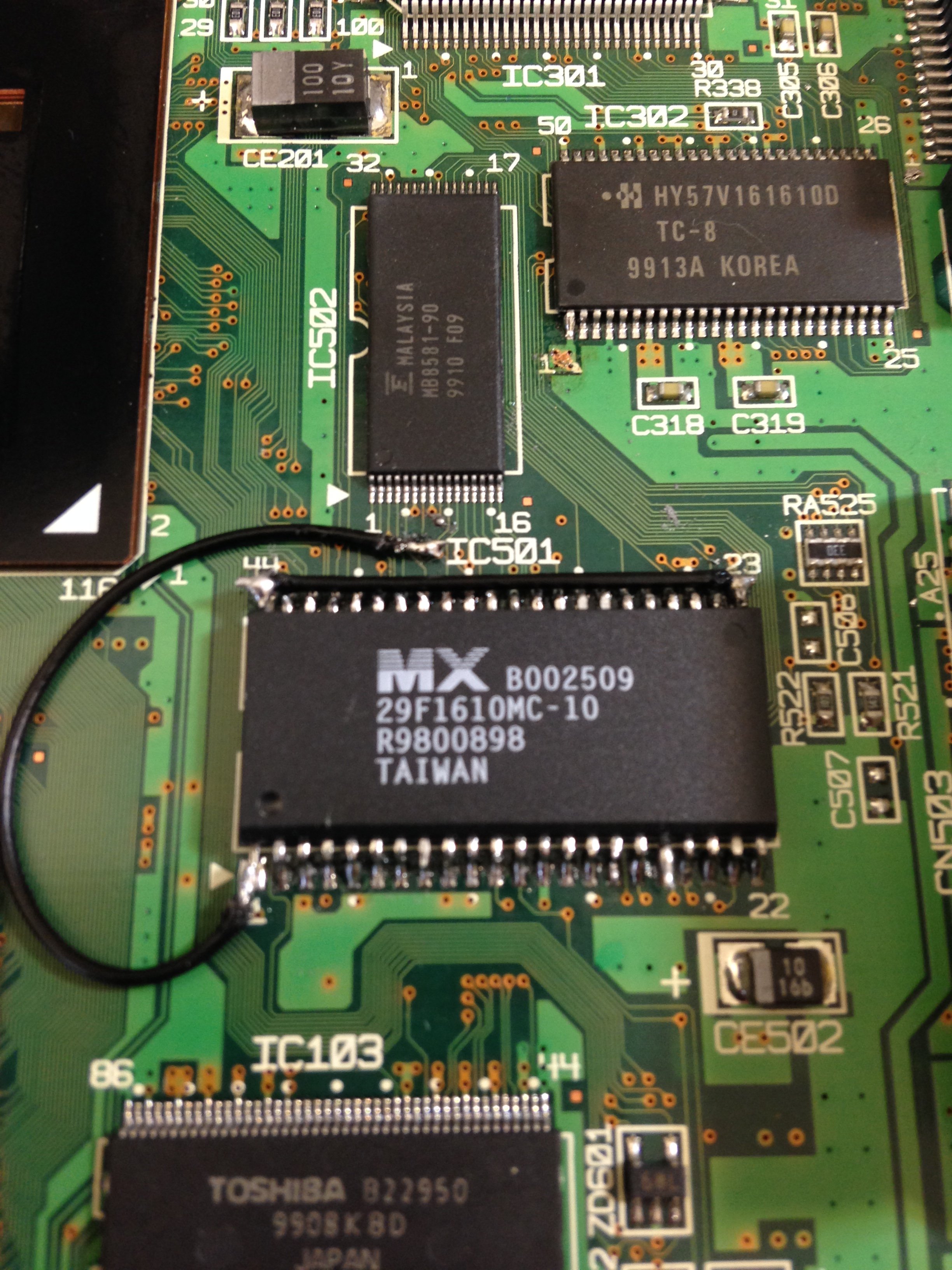

    This is how mine looks now and working great finally

    The reason why it's different is because VA0 Dreamcast uses5V ROM chip instead of 3.3v.

    Yea I already knew that . Hence why I pointed out that mmmonkey's instructions for wiring a VA0 5v chip is incorrect .
    I'm not bashing the hard work that was put into all the effort of figuring out this chip , simply the fact that no one followed up with clear or correct instructions on installation of both versions and both methods . Most people do the piggy back method on a VA1 so that's what was covered most clearly .

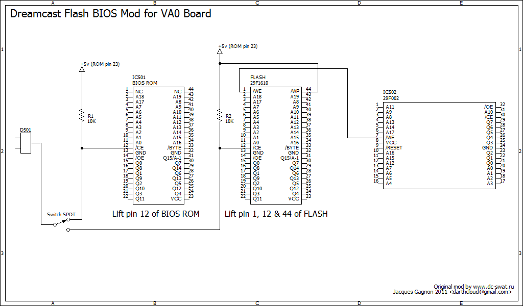

  4. Bad_Ad84
    1,308
    That's because the mmmonkey guide isn't using a 5v chip.
    It's for using the 3.3v chip on a va0 console.
    You can see the part number of the chip in the pics.
    I also have install diagrams in my sales thread for both chips.

    And I wasn't aware that the chip on mmmonkey's VA0 board was 3.3v :/ I do see the LV on the chip now , it just didn't state that in the instructions above it and I didn't think anything about reading the what the chip said on it .
    Please don't take my comments the wrong way , I just got annoyed at all the different methods and IMO poor references to the ins and outs of swapping chips and VA0 boards .
  7. Bad_Ad84
    1,308
    The install diagram shows how to install piggy back, but also gives all info you need to do total swap, just ignore the pin 12 connection.
    It shows you don't need to lift pin 23 and it shows where pin 1 and 44 connect -which is all the info you need.
