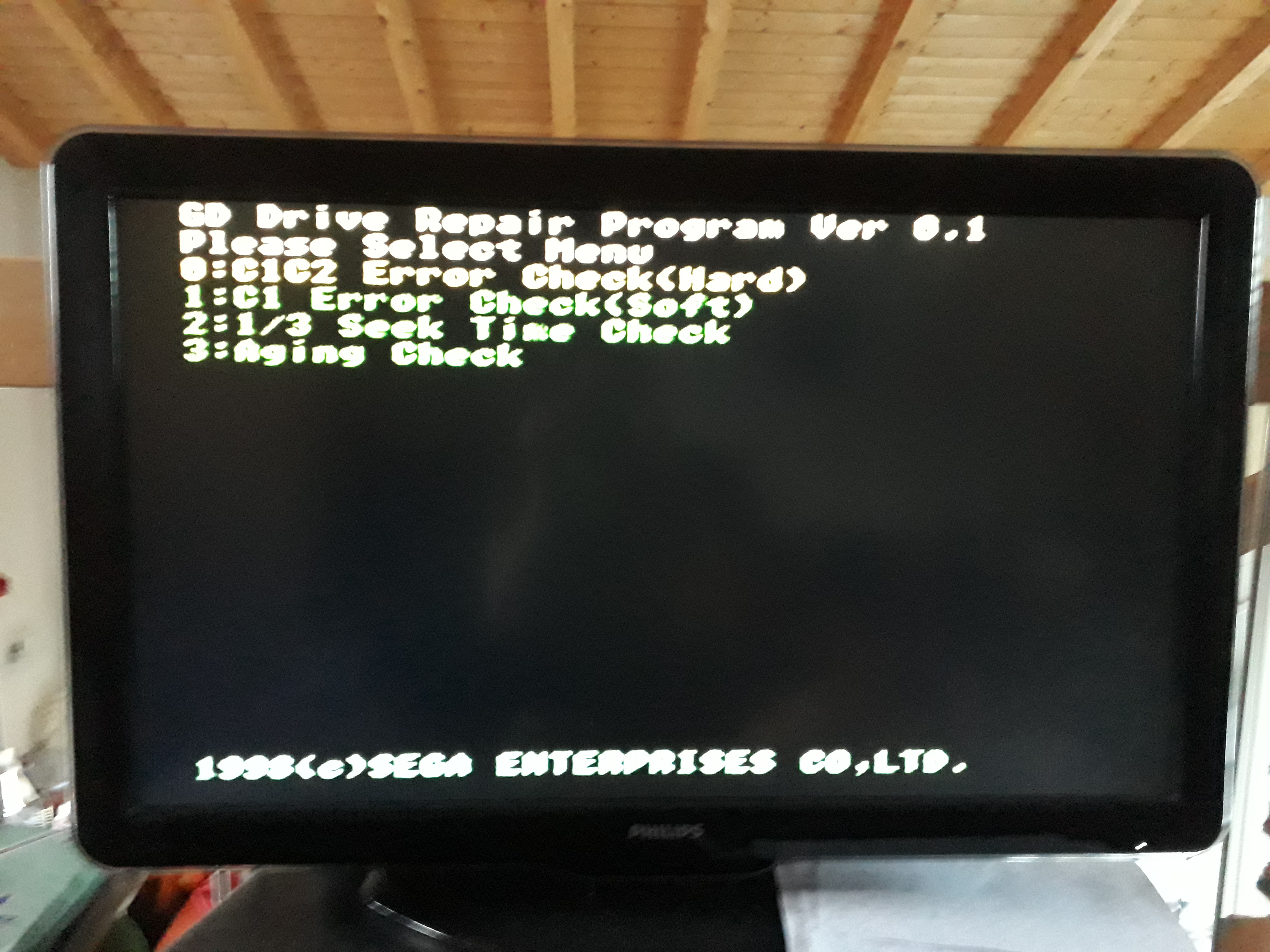

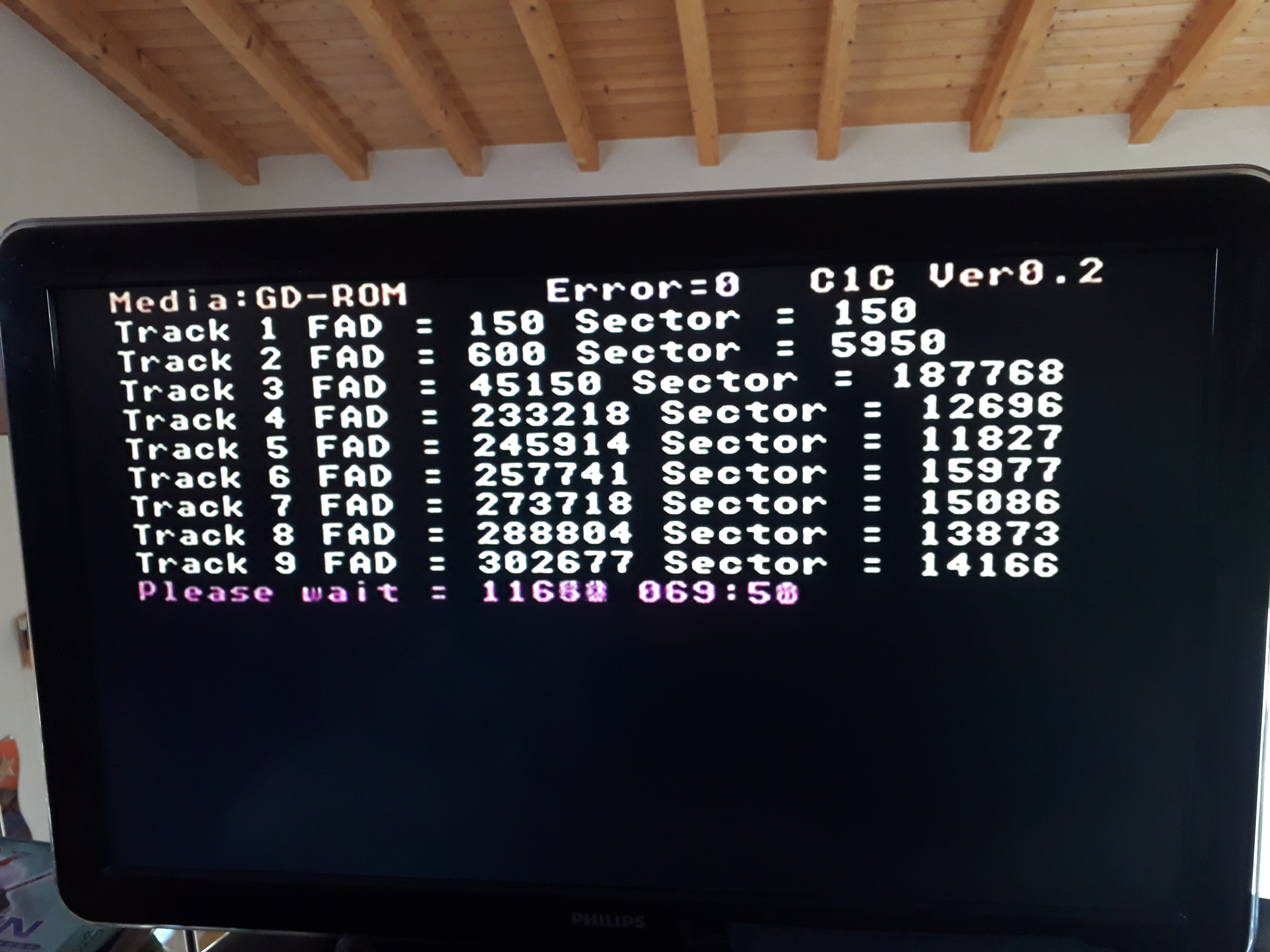

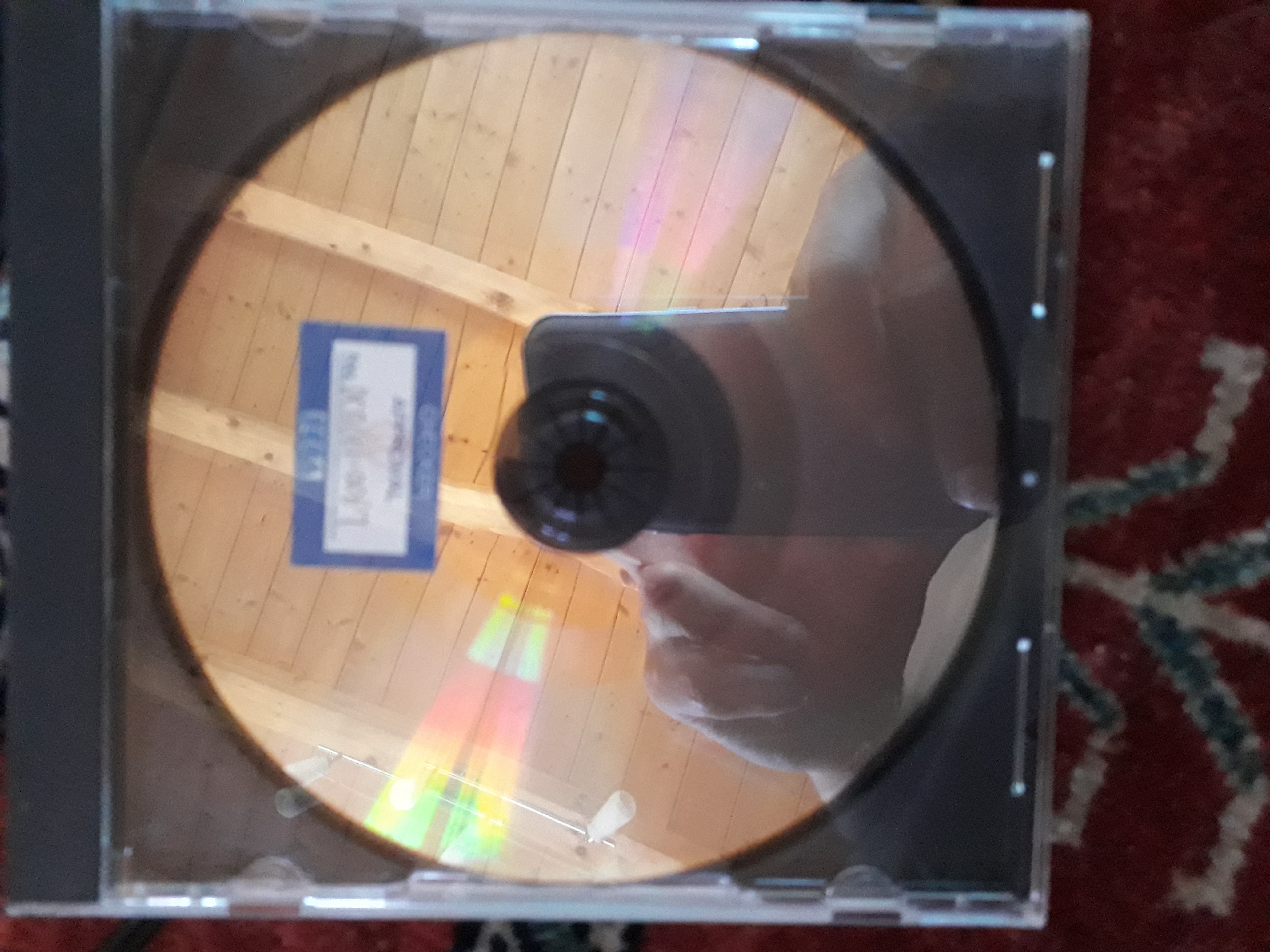

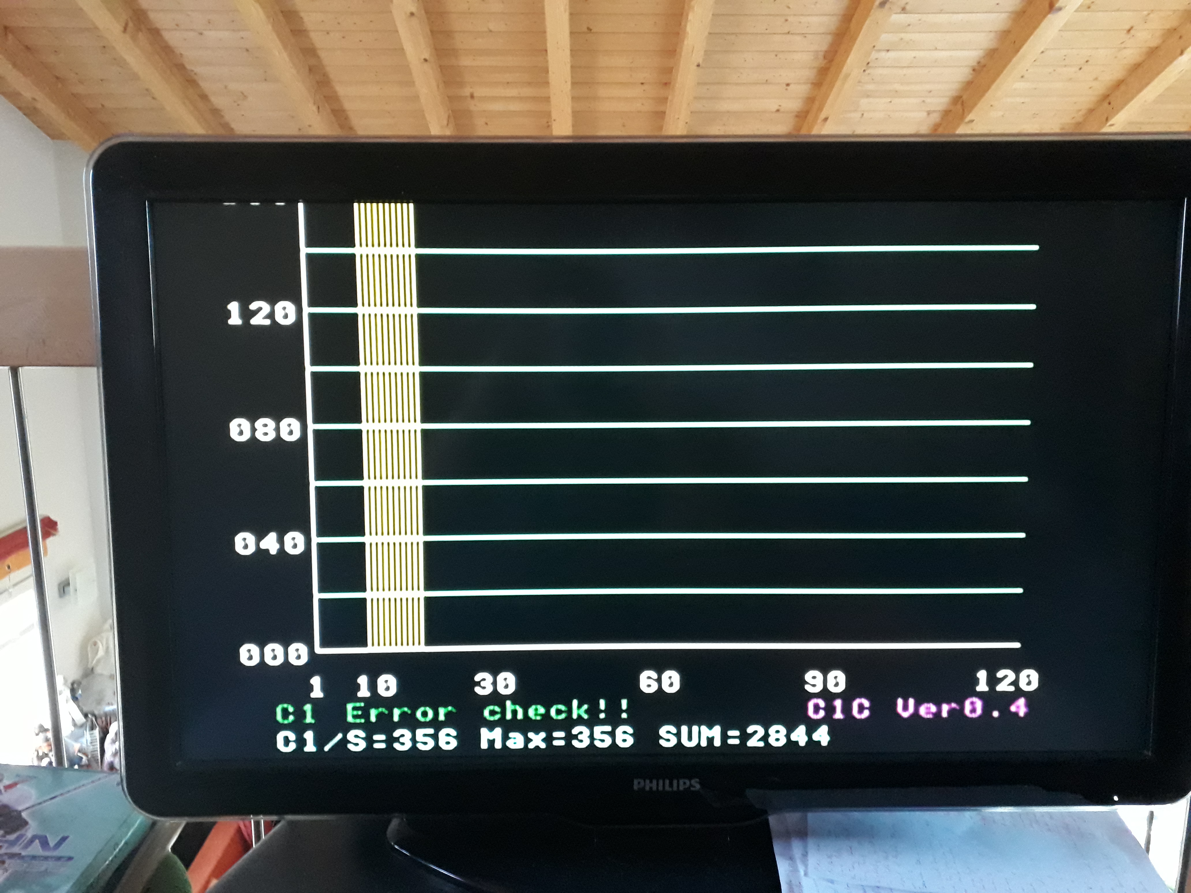

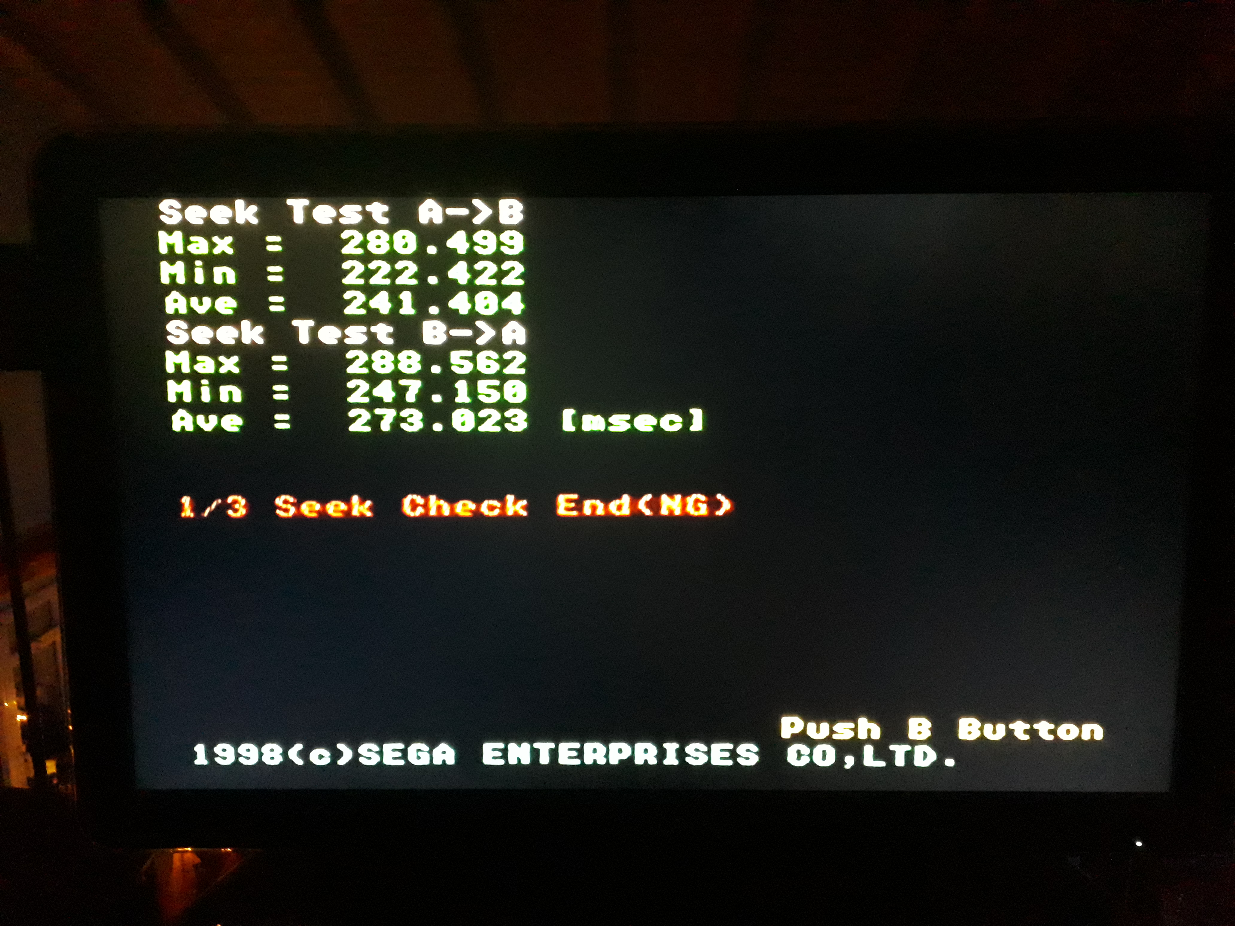

    I found some interesting disc
    I presume its To repear build . I don t really know

    Its look like the same of the dreamcast C1/C2 checker ( console) ...

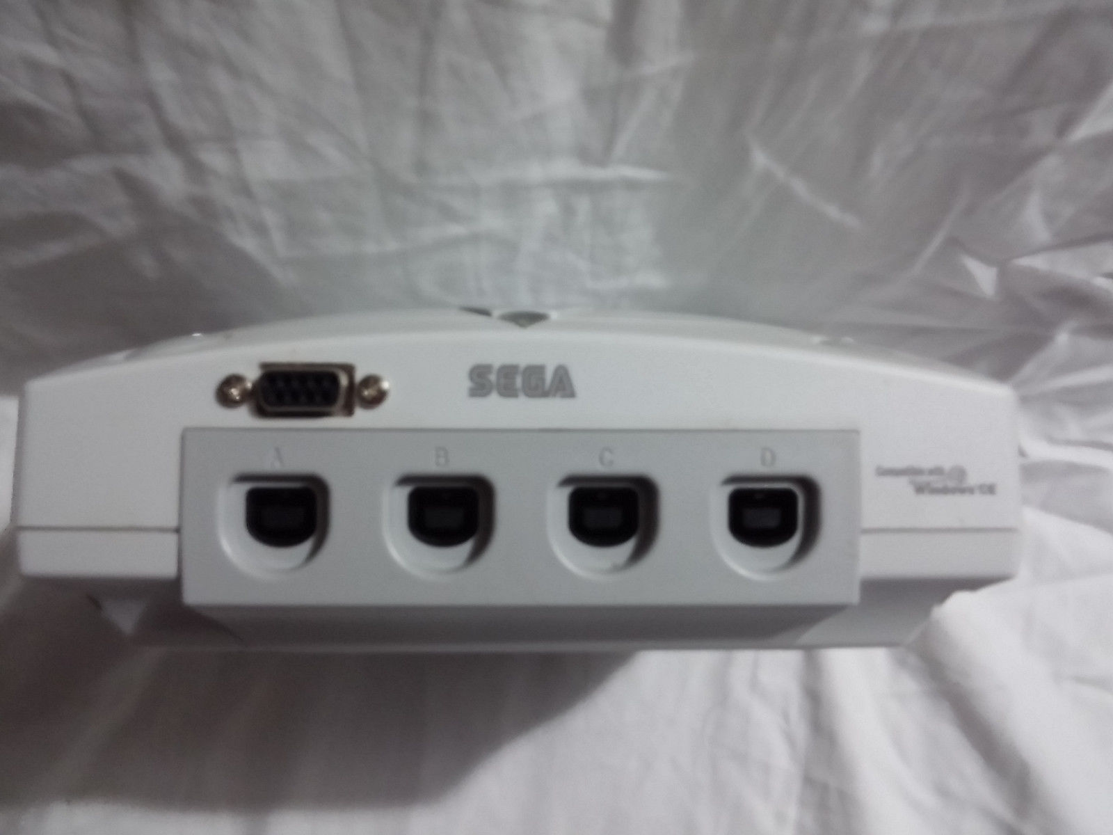

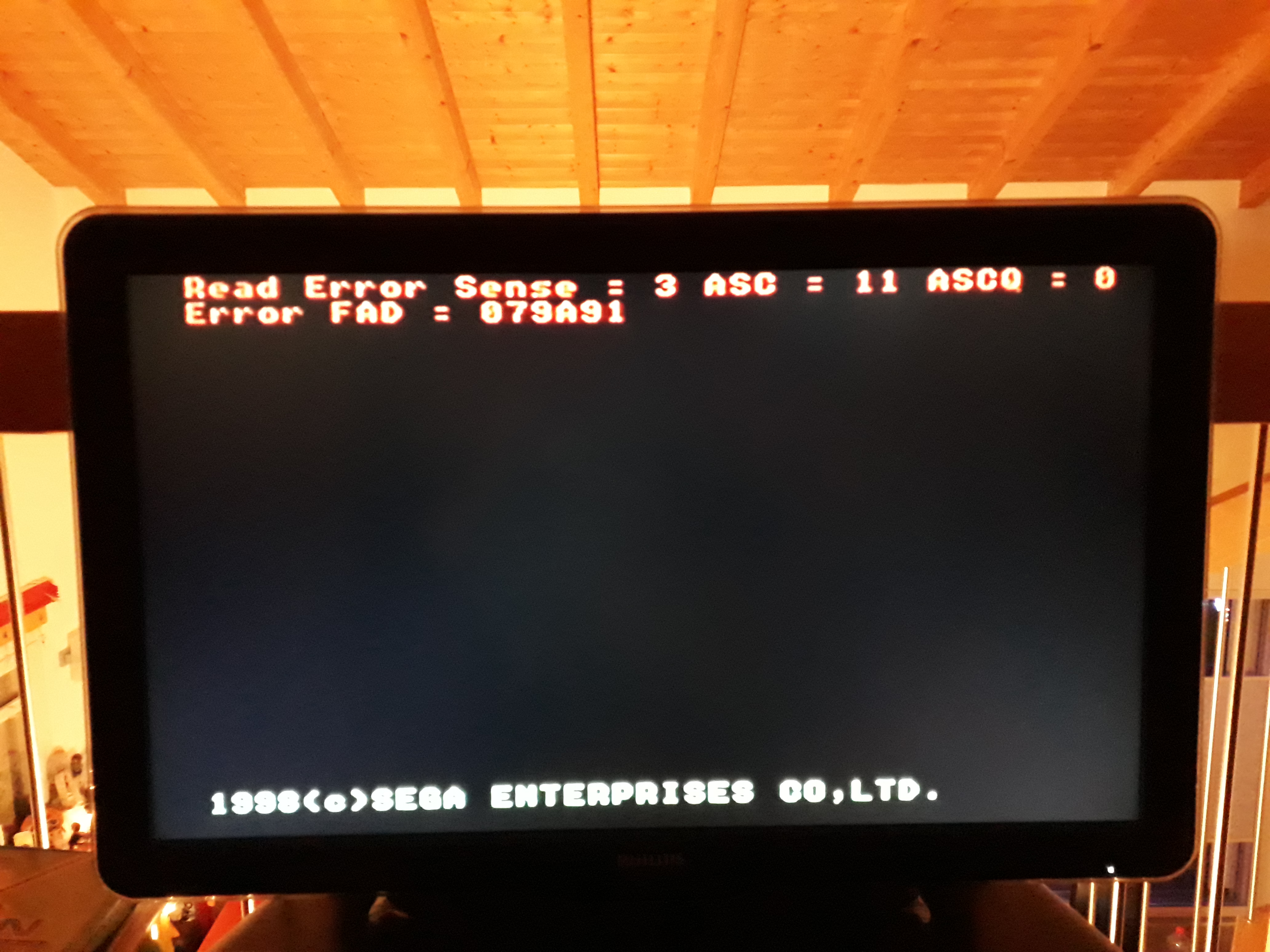

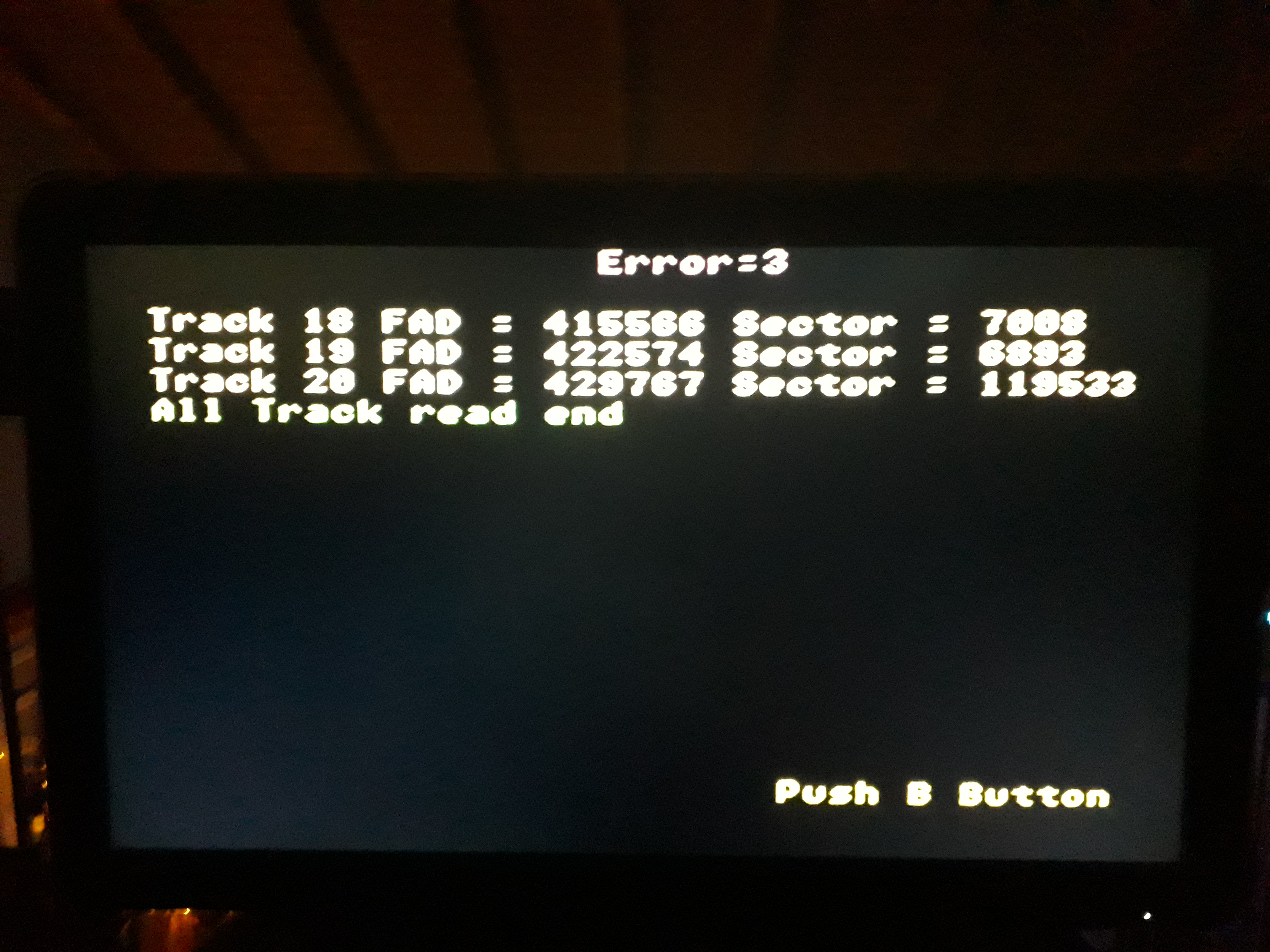

  10. darcagn
    May 12, 2007
    529
    246

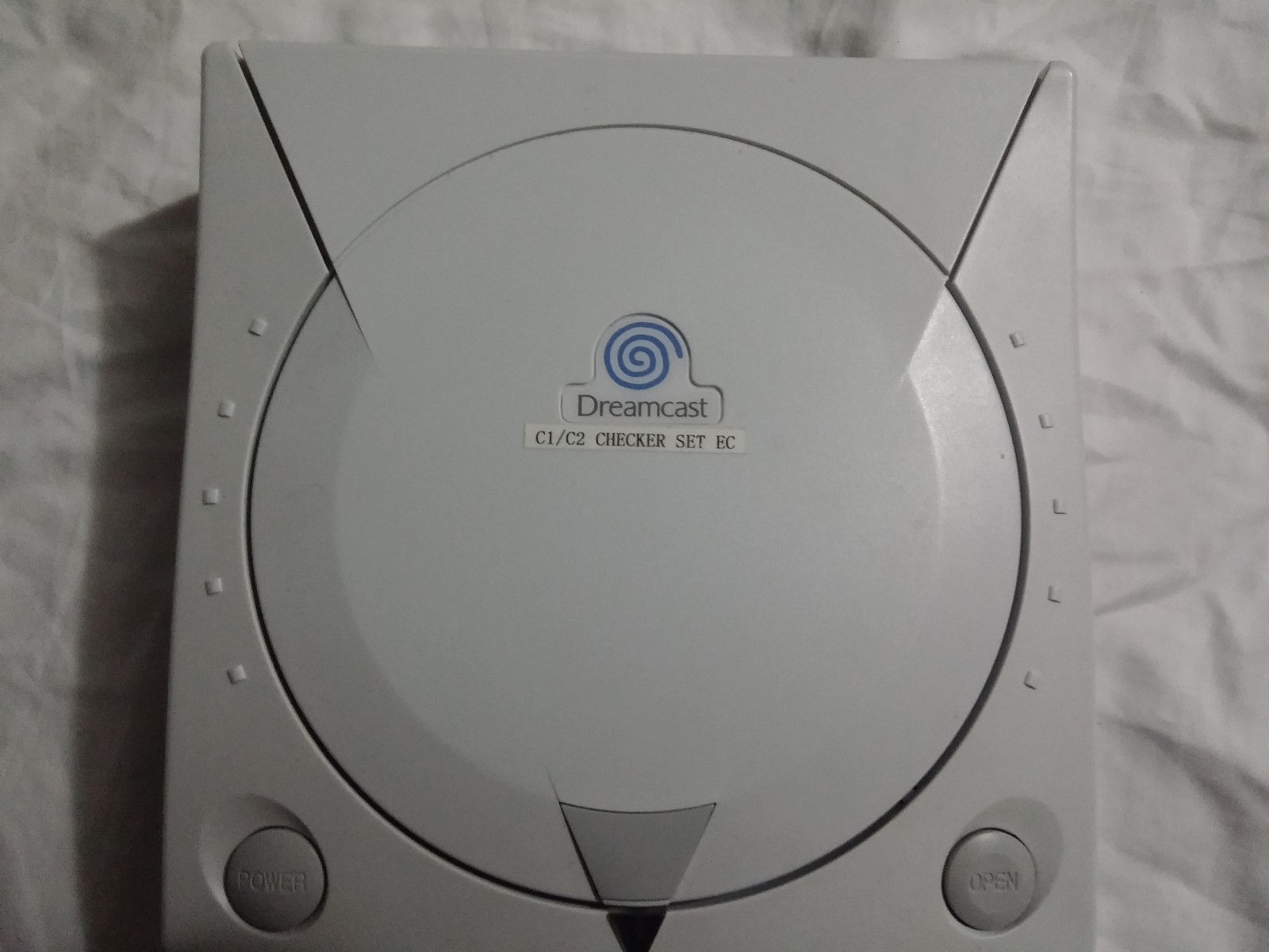

    This appears to be correct.

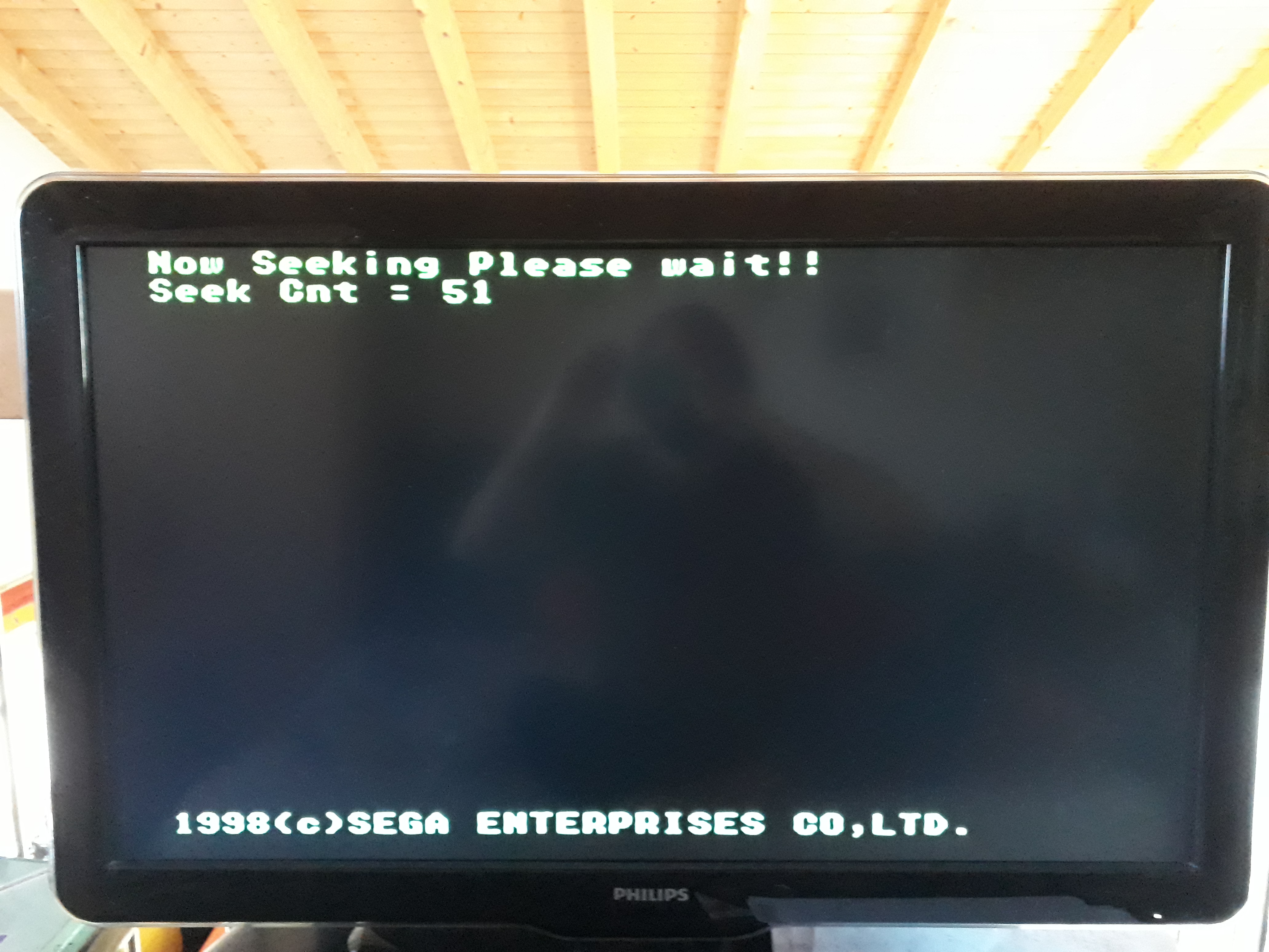

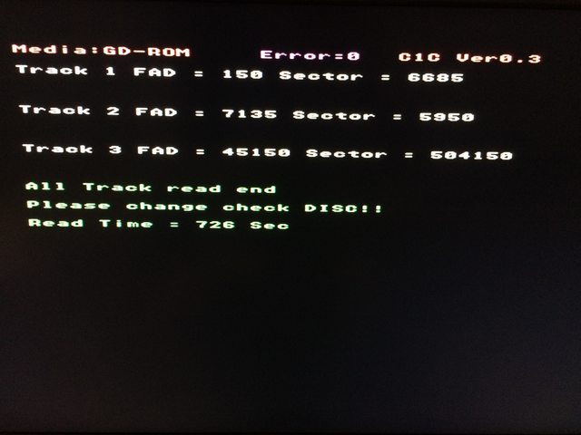

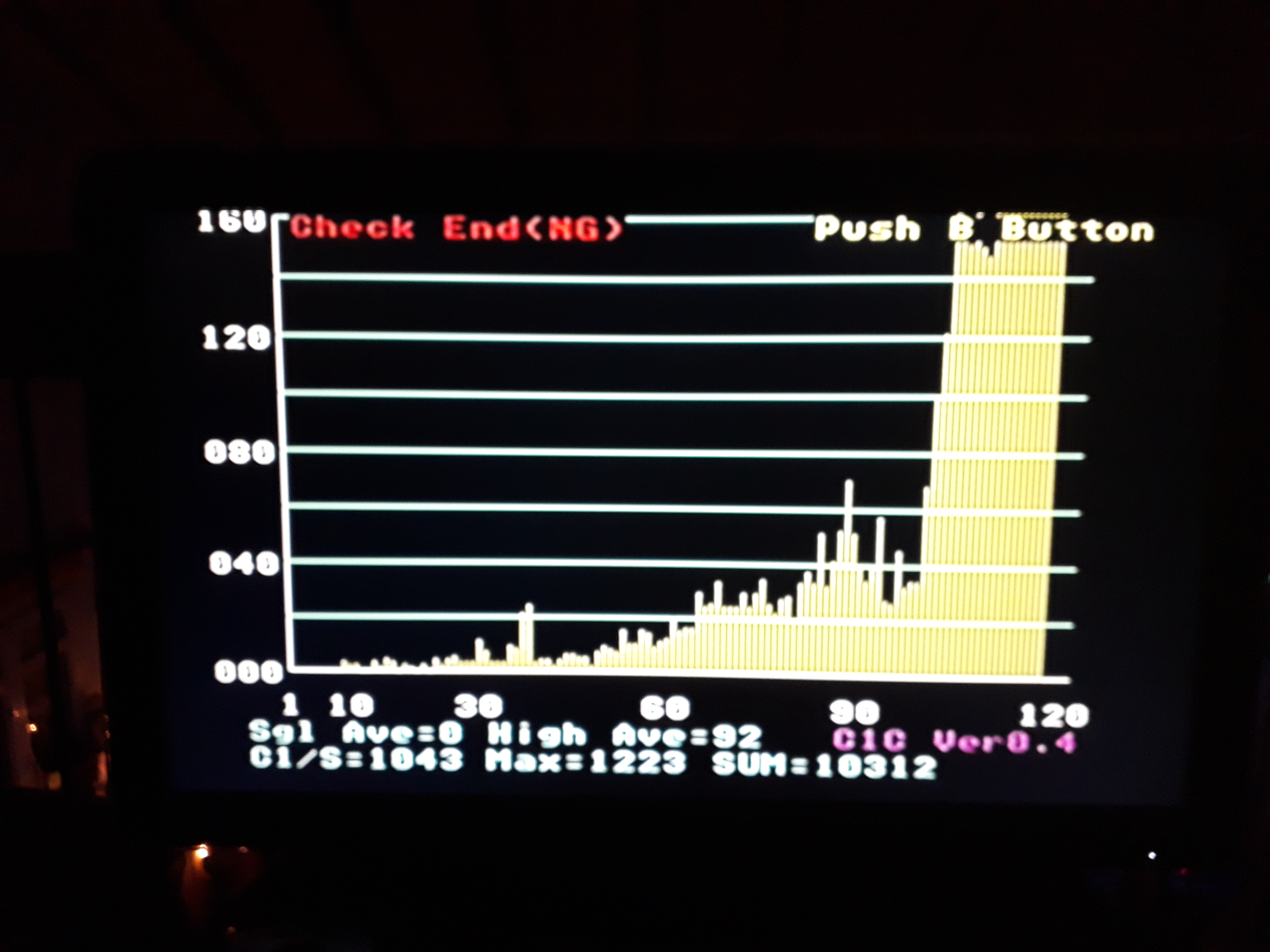

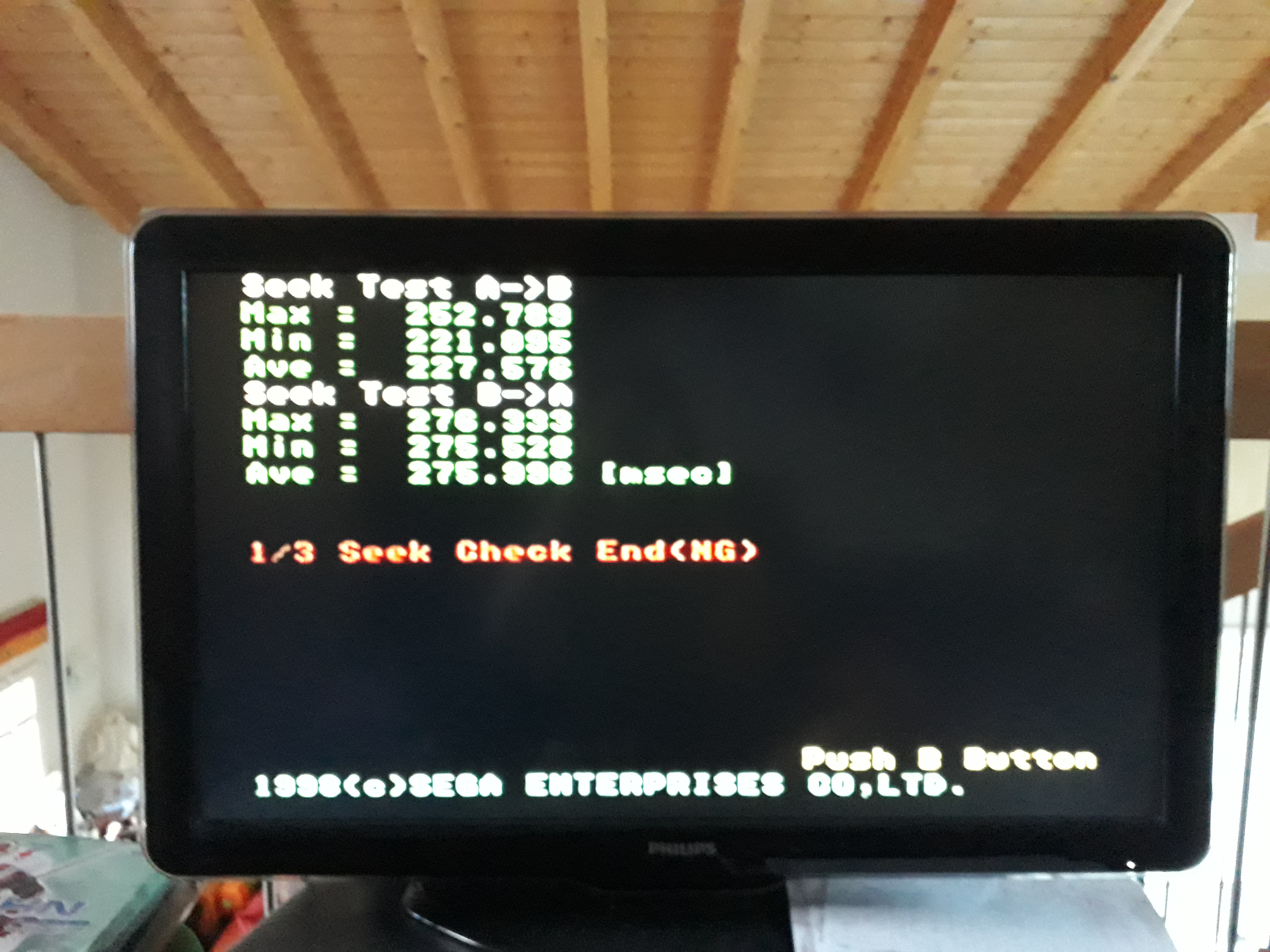

    Software on the disc shows "Ver0.2" in the upper right corner when running the test (see screenshots above).
    The C1/C2 Checker console has the system wired up with a custom BIOS and a serial port. The custom BIOS boots directly to this checker program. The checker program on the console in the example is "Ver0.3" however.
    Here are pictures and a screenshot from Wombat.
    From what I can gather, this disc was intended to test GD drives during the repair process.
    The C1/C2 checker was intended to test discs during the manufacturing process.
    Both of them use the same software code to test in these different use cases?

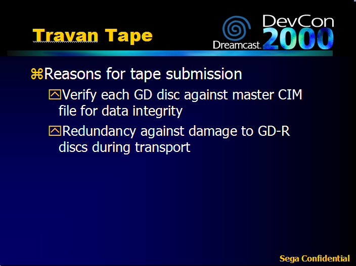

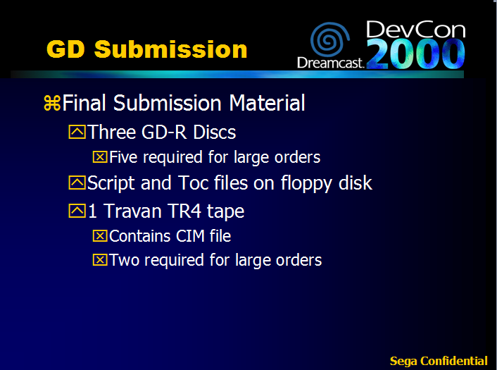

    MetalliC Spirited Member
    Apr 23, 2014
    155
    127
    it seems was like that in early times, later it was changed to submit product as both GD-Rs and master disk(s) image(s) in CDCraft CIM format on tape drive.
    from SDK SOEGDMastering.ppt:
