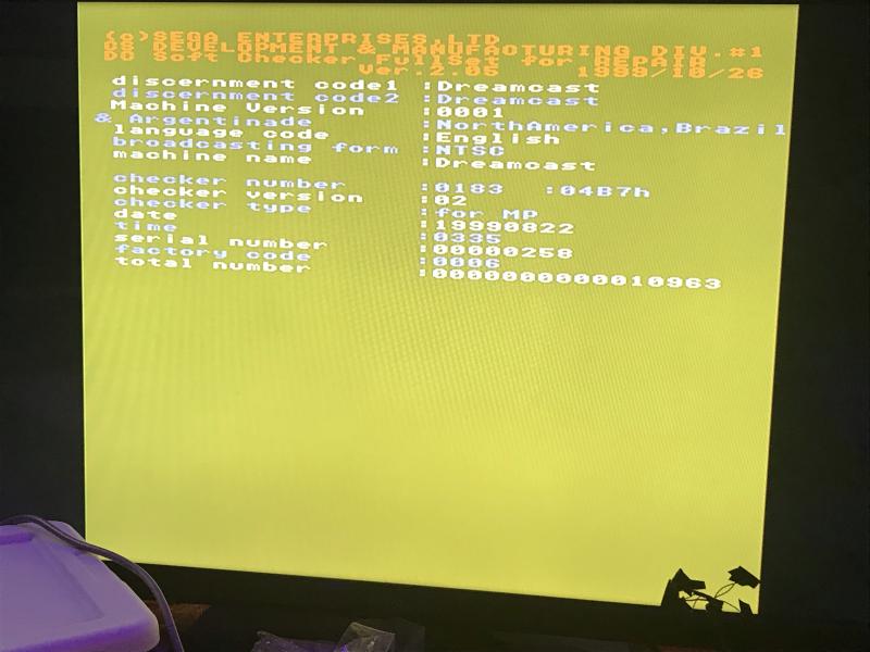

    Some more info for those who are interested in this DC CHECKER Ver.2.05 for Repair GD-ROM.
    Laurent will be scanning the full documentation for it soon, but in the mean time here are some hints about this GD-ROM:
    - WARNING: It will erase your Dreamcast's flash setting/PSO serial, so don't run it if that's gonna be a problem
    - WARNING times a million: Running this on a Dreamcast with the +12V wire soldered for the region changer's write enable will result in all region coding being erased from your console, it will be bricked with a black swirl
    There are multiple modes that the disc can be run in depending on what buttons you hold down at the IP.BIN screen:
    - Holding nothing: Full checker
    - Holding A + B: Full checker but without modem checks, req. for Asian modemless consoles to pass
    - Holding X + Down on D-Pad: MP Checker mode, skips critical tests but runs the other tests
    - Holding X + Right on D-Pad: Single test mode, disables test script and allows you to scroll through the individual tests and pick them at will
    - Holding Y + Up on D-Pad: CLX Signature check. which renders a scene and compares calculated graphics data against reference data
    - Holding Y + Down on D-Pad: Sonic Cube mode, which allows you to run several Holly samples, basically the same ones that are run during the scripted test modes, but you can control them with controller.
    Sonic Cube Holly Samples:
    - Non-Tex Cube
    - Tex Cube
    - Punch-Thru Cube (X+Up/Down increases/decreases number of cubes, Y+Up/Down zooms in and out, start pauses/resumes motion)
    - Vertex Test (B toggles mirror map and transparency, d-pad moves screen)
    - Torus test (A changes number of doughnuts, Y+Up/Down zooms in/out, start pauses/resumes motion)
    These are the results running with BBA attached and with only 1 pad plugged into port A:
    If I replace the BBA with the modem and plug in 4 controllers (keyboards did not work), everything passes but SH4.
    SH4 fails the SCIF test.
    I knew the SCIF test was related to the serial cable that comes with this disc, but I don't have it and I didn't know what it did.
    I've seen it on Adam Koralik's video about the Check-GD, but like all of his videos about dev hardware, he's completely fucking clueless as to how any of it works, and he even says the purpose of the cable is to flash the console's BIOS...
    Thanks to Laurent, who gave me pictures from three of the pages of the documentation, I saw they called it a "communications loopback jig." So I realized it is just a loopback test.
    Not 15 minutes later the mailman dropped off 2 new old stock Dreamcast/NeoGeo Pocket Color link cables. What great timing, Mr. Mailman. A week ago I bought them, one to keep for my DC collection and one to steal the serial cable end from. My purpose for this was to make a "serial box" in a project box, sort of like the VGA box, with a USB port, SD card slot, and a DB9 serial port, controlled by a switch. I have no fucking patience to hack up mobo slots or HDMI cables to make any of my own, I wanted something more professional looking and durable, and the price wasn't terrible.
    So I removed the serial cable from the NGPC board, and used a multimeter to figure out which pin was which cable, then soldered pin 4 and 5 together and pin 6 and 7 together (RX and TX, and RTS and CTS, respectively) to make a loopback cable.
    Voila! It passes the SH4 SCIF test now! So I'll be adding a loopback function on my "serial box" for running this Check-GD :)
    This is what it looks like when the test passes:
