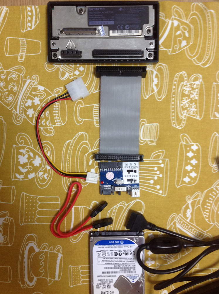

    I received 1 week ago my DTL-H30102 Unit and I'm curious if you can use an internal HDD with this model.
    I already purchased the Network Adapter (SCPH-10350) and also this IDE to SATA converter. Well it didn't work.. I used my 128GB SSD and the newest version of OPL and WinHIIP but the OPL didn't recognize the HDD. Tomorrow I'll try the adapter with a random IDE HDD that I found to make sure if the adapter works.
    Does someone have an idea which way would be the best to play games from the internal HDD? I really wanna use a SATA HDD instead of a IDE HDD.

    Have you checked that the power and ZIF cable (between the SPEED board and the SATA to IDE board) are secured properly?
    Does the disk power up when the HDD is accessed? If you cannot tell, does the fan spin faster? If not, then the network adaptor probably isn't being detected by the console.
