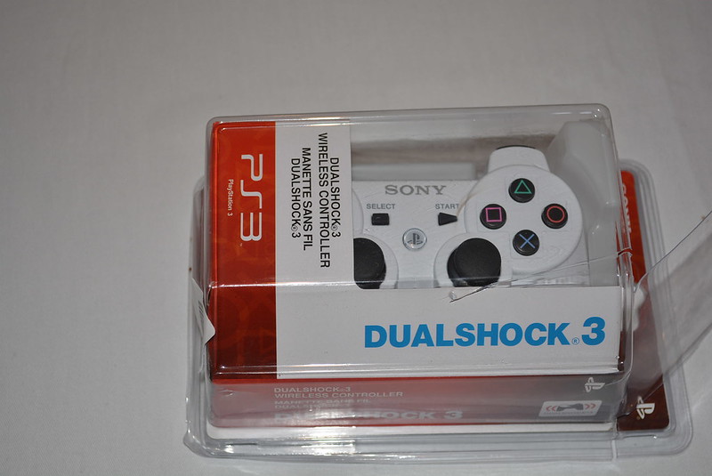

    So I bought a DS3 off Amazon New. I have had good luck in the past with Amazon as they are pretty good at weeding out fakes. However, this last one I got is so good I couldn't even believe it was fake for about an hour. After comparing it with my real DS3s I was finally able to confirm this is a POS fake (and after using it, Six Axis is alllll off on the fake.)

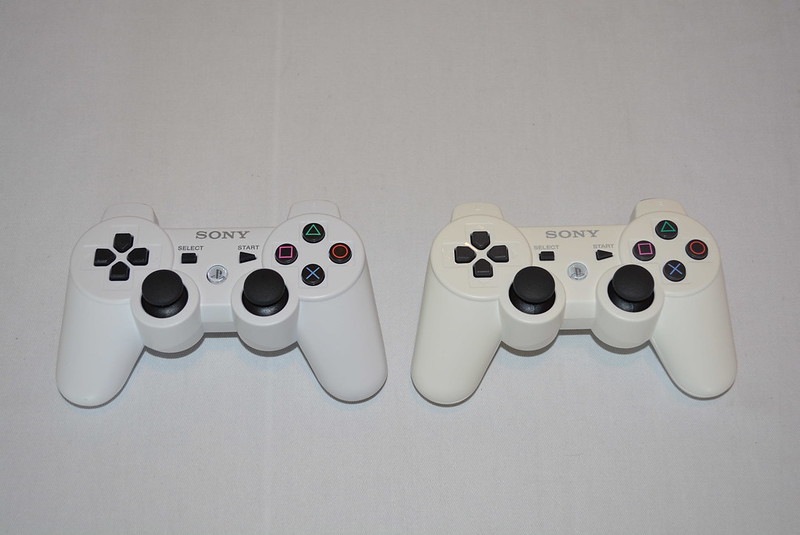

    So which one is the fake?
    If you guessed the one on the right you would be wrong! The PS3 classic white is an old school looking white, like PS1 Slim white. However, not everyone buys white controllers so hopefully I took some photos to help those find, spot, and report fakes. (I'm serious report fakes! Especially the ones that try to pass as real DS3s)

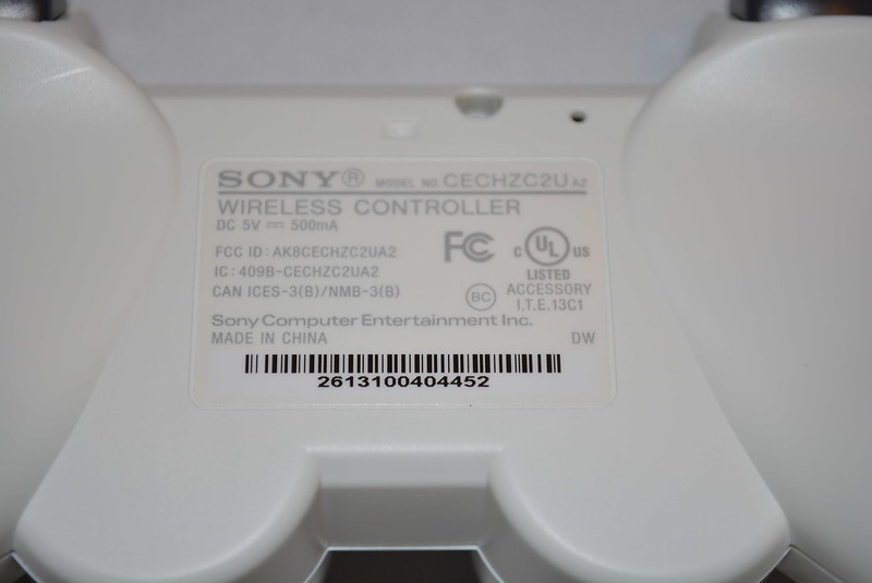

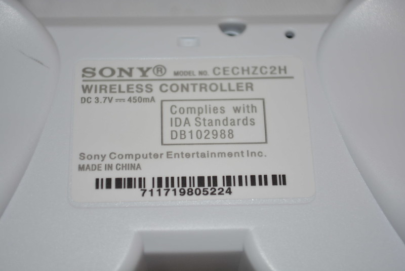

    How to spot a fake rule 1: Check back labeling.
    Real label: Has FCC labeling
    Fake Label: Has BS Compliance standard labeling
    Also note, model number doesn't even match model number on the box:

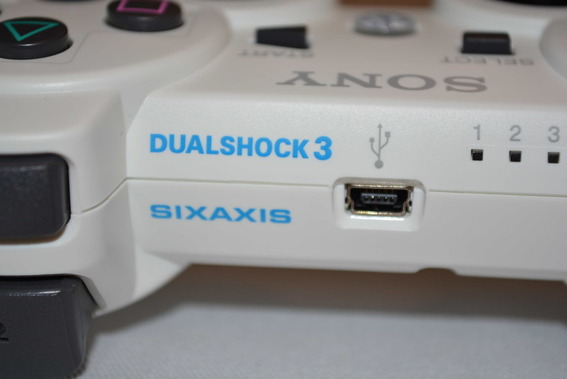

    How to spot fake rule 2: Fakes are bad at the painted add on labels.

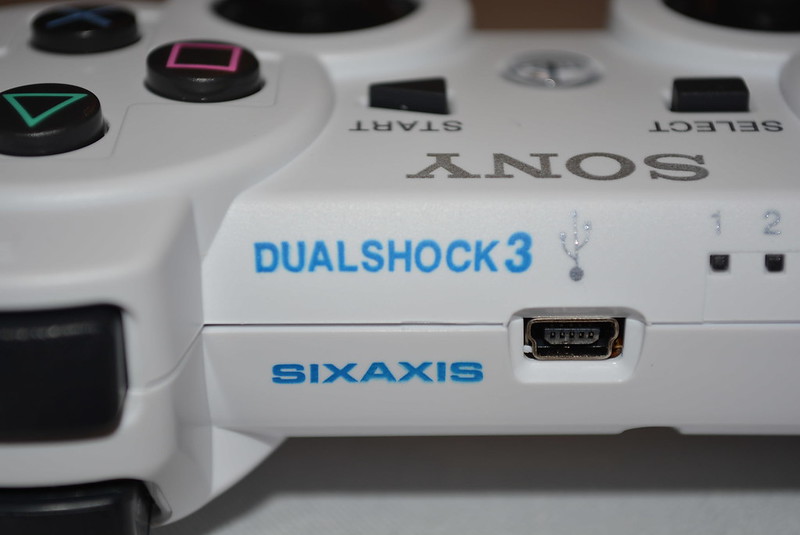

    Real Controller: The Dualshock 3 and Six-Axis logos look professionally done.
    Fake Controller: Dualshock 3 is a mess of fade and smearing, the 3 is the worst it's italicized and smeared, the six axis logo is faded.

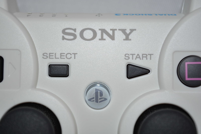

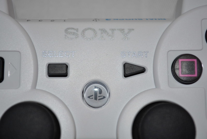

    Real Controller: PS center button looks like this. (Also note Sony, Start, Select are matte not matallic, but that will vary by controller color.)
    Fake Controller: PS center button isn't as defined. Also Sony logo is not center and wrong color.

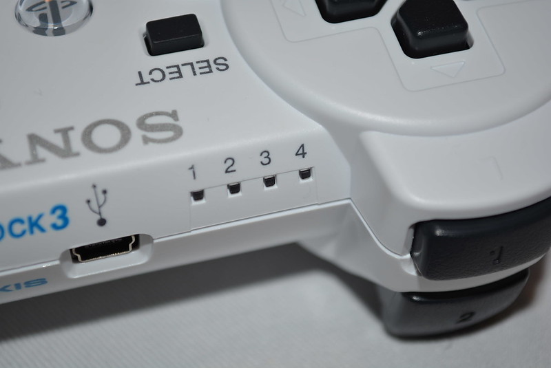

    How to spot fake rule 3: Indents on the back are too sharp.
    Real Controller: Barely can see the indent on the controller number labeling.
    Fake Controller: The rectangle indent is noticeable from a mile away.

    This box is 90% of the time a fake: Sony hasn't used this box in ages.
    If some how you manage to find a deadstock of this box, it looks like this in real form:

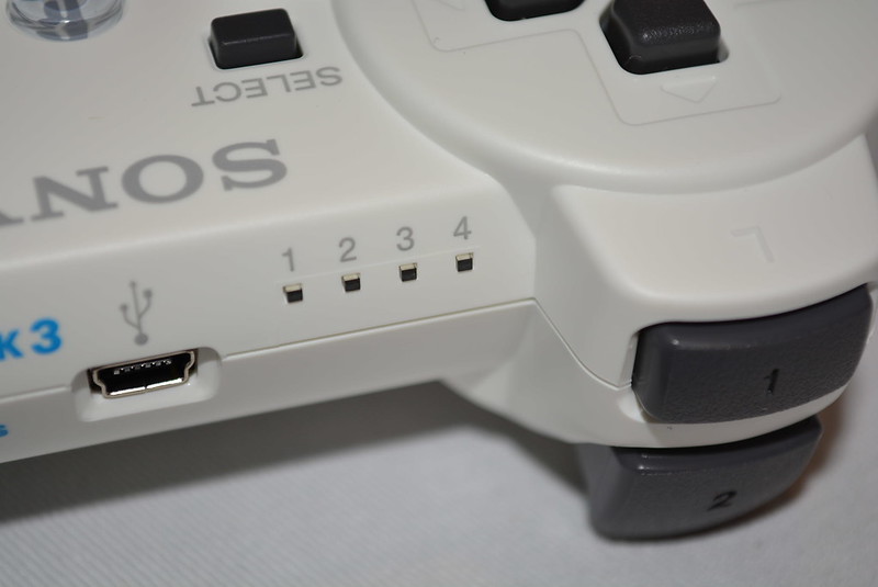

    One other thing I noticed, the font on the 1 for L1 is way off. From the pics you can tell, it's huge.

    Just FYI, that label on the back of the controller is perfectly valid - IDA is the approvals agency in Singapore, and the ones that are sold in Asian markets look exactly like that. I just pulled out the DS3 that came with my original PS3, and the label is identical to the one in your photo except for the color (it's a black controller).
