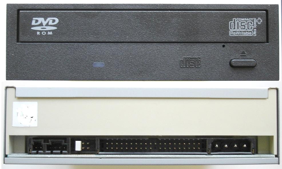

    With the IDE mod, it's possible to connect a DVD Drive IDE on the Dreamcast.
    So, my question is, if someone write an application for DreamShell would it be possible to get a DVD working on the Dreamcast?

    IDE driver in DreamShell work with CD/DVD drive ;)

    Really? so if I burn a game in a DVD the Dreamcast will run it?
  10. darcagn
    May 12, 2007
    529
    246
    You'd have to load it from the DreamShell menu just like when you load a game off of a hard drive.

    in next version DreamShell
    current version don't include cmds for read DVD-VIDEO
    current version support:
    Master channel
    GD-ROM
    CD/DVD
    HDD
    Slave channel
    CD/DVD
    HDD
    zero35 and LuizNai like this.
