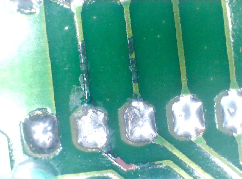

    This is the cartridge connecter that appears to be damaged.
    That being said, its most likely a damaged SRAM
  16. Bad_Ad84
    1,309
    Actually, if those are related to sram address lines, it could easily be the cause of the problem.

    By multimeter he means an electrical testing tool which can be used to test things such as conductivity between two points. You would be using it to see if those traces are on board are broken.
    It's hard to tell from the picture, but I wouldn't assume your problem is those traces, but it is possible. You need to test to be sure.
