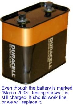

    Originally I considered the MN-918 Alkaline battery.
    It's basically a doubled up 6v spring cell.
    30,000 mah of power. $13 each. Very cheap.
    However, there is a 6v lead acid rechargeable
    for the same price.
    However it is only 12,000mah.
    But it is reusable.
    The charger for the 6v battery would be around $7-20.

    I would use four modules, so that would be About 12 hours light on the lead acid as it will probably heat up and combust below 20% charge.
    The alkaline would give a staggering 30+ hours of strong light before it starts diminishing.
