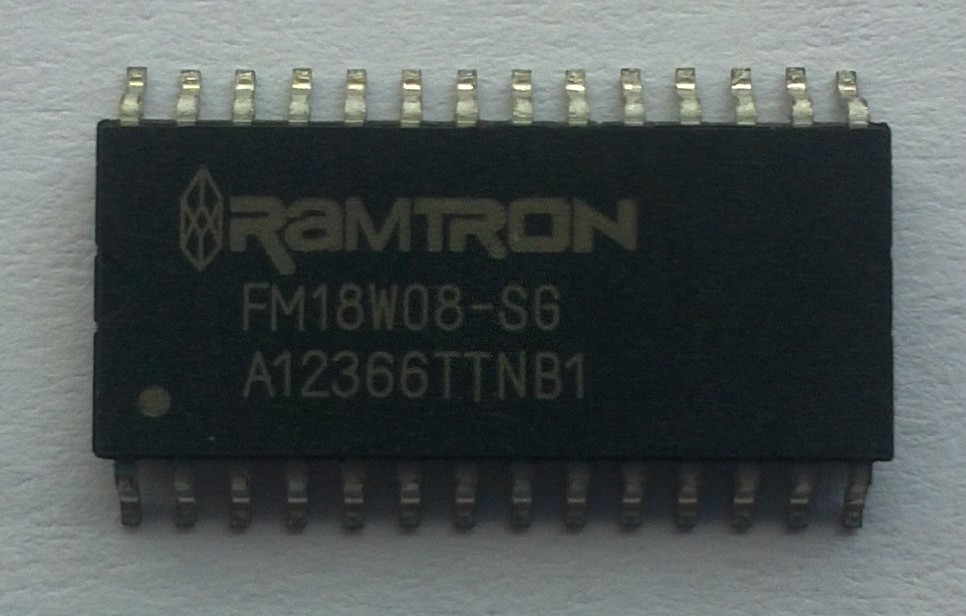

    Hi guys,
    Bought this on ebay from a Chinese seller. Before anyone mentions the fact that its ebay and you should get electronics from a proper supplier, I only ordered this as I had an ebay voucher that needed to be used.
    Just wondering if you guys think this is a fake?
  2. Zer0-2k11
    Jul 18, 2012
    542
    Looks normal to me when i compare it to other images on google.
  3. sanni
    sanni Intrepid Member
    May 30, 2008
    653
    77
    It looks used, fake chips normally are newly manufactured.
  4. Zer0-2k11
    Jul 18, 2012
    542
    Now that you say that, the pins do look a bit off. To be honest, i would just try it out and see what happens. It might be closest to what you get for quality.

  5. theid
    theid <B>Site Supporter 2014</B>
    May 2, 2014
    36
    I'm no expert, but that font looks sketchy. The "M" looks out of place and the top of the "A" is curved.
  6. afccarl1994
    afccarl1994 Rapidly Rising Member
    Jun 13, 2014
    87
    My thoughts exactly. The text seems way too thick (I think the logo is supposed to be two very thin lines), and the letters too curved.
    I have since contacted Ramtron/Cypress, who have confirmed that the chip is counterfeit.
    Now to try and get my money back through ebay, hopefully without having to send the item back.
  7. TriMesh
    Jul 3, 2008
    2,324
    My guess is that it is what it says - but they are parts that have been taken off boards. The reason for the dodgy marking is that they had a lot of chips with different date codes and lot numbers on them, and remarked them to all be the same. I've seen lots of parts like that.
  8. afccarl1994
    Jun 13, 2014
    87
    Had a reply from the seller this morning, asking that I return the item and they will send a replacement sourced from a different supplier. I'm a bit sceptical that they would find a genuine supplier of the item so quickly, and the fact that the item is still listed. If I do send the item back, by the time I get a replacement, I'll no longer be able to file a claim if the replacement is the same, which I assume it would be.
    Not sure what the best thing to do would be in this situation, has anyone had any dealings with fakes on ebay before?
  9. sanni
    May 30, 2008
    653
    77
    Obviously you file a paypal claim, send the item back, get a new one and then close the paypal claim.

  12. LeHaM
    LeHaM Site Soldier
    May 5, 2013
    2,634
    292
    It probably is just a clone, clones function just the same but the manufactures of said clones don't pay royalties (a lot of cheap electronics they actually shave the label off to avoid royalties )
    if you don't have the tools or skill to desolder the chip what use is trying to de cap it and determine what's "actually in there"..
    I can see no reason for this to function any different than what it's advertised as. I usually use clones in my projects, just because it's from China does not mean they are out to get you and why make a fake chip and go to all that effort for a $1 profit..

    halo3 Robust Member
    Jul 20, 2010
    251
    rub some iso on it to see if logo fades
