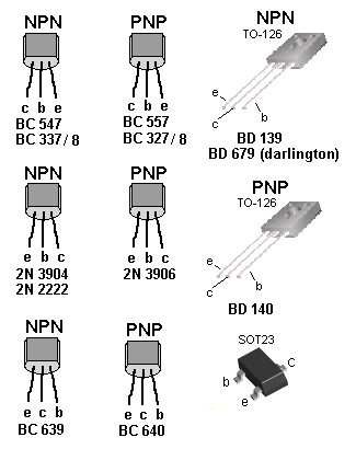

    I think that one of the guides I was following may be wrong as it has the capacitor as:
    I have "+ve" at "base" and "-ve" to "video out".

    I'm confused about how you have it wired.
    The PNP base should be connected to the PPU's video output, nothing else.
    The PNP collector (same pin as NPN emitter) should be connected to GND, nothing else.
    The PNP emitter (same pin as NPN collector) should be connected to 5 V through a ~300 ohm resistor. Then it should also connect to the positive lead of the 220+ uF capacitor. The negative capacitor lead should connect to the ~100 ohm (not ~100k) resistor.
    You can wire the 100 ohm resistor before or after the capacitor, I think before is better, IIRC Nintendo put it after (as in the schematic).

    So, wired up incorrectly and I'm using the wrong resistors (the store sent me the wrong type of resistors), a great start! lol
    I had the "+ lead" from the capacitor and video out (PPU) at base and the "- lead" went to video out (TV).
    The whole thing actually works without the 5v+ from the mobo so I guess that explains the dark image as well...
