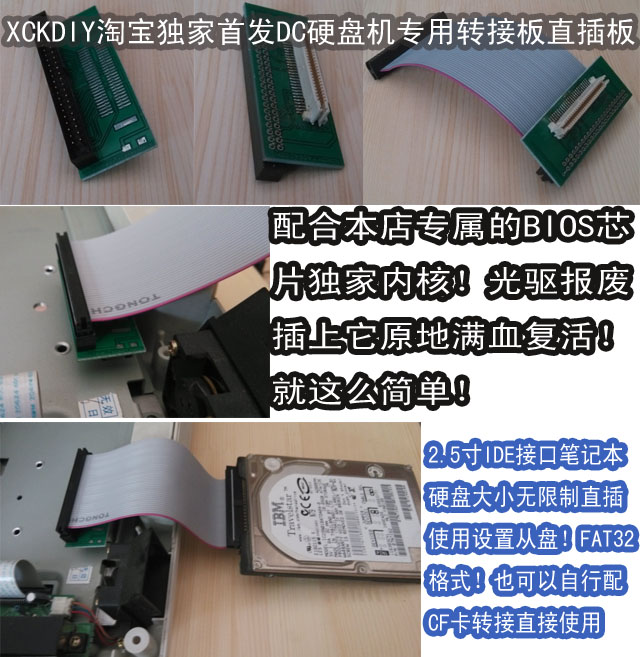

    if the drives are dead, haven't you just considered xckdiy pcb? [​IMG]
    either way you'd need to bios mod dreamshell in order to use either one though

    Thank you for that. I might drop the cash for 1. Anybody know of a way other than alibaba merchrchant to buy one of those XCKDIY kit? Also if not I've got plent of guinea pigs for that ribbion cable lol.
