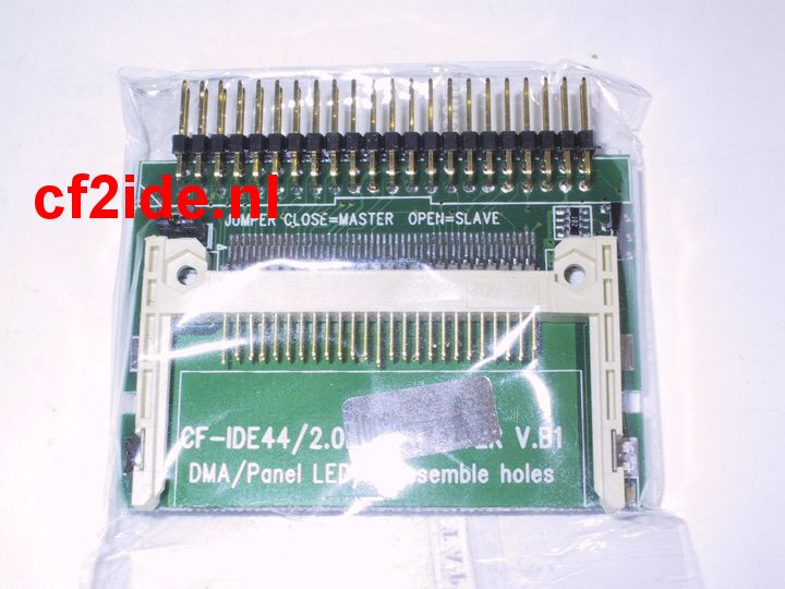

    I wonder.. if you can make it a little bit longer, would it be possible to fit a cf2ide reader and picu psu next to the gdrom drive?
    Something like this: http://www.cf2ide.nl/product_info.php?cPath=22&products_id=33
    EDIT or even better..
    Get the smallest cf2ide adapter which requires a 44pin powerd ide-connector.
    http://www.cf2ide.nl/product_info.php?cPath=22&products_id=34
    Then solder this adapter onto your flex cable: https://www.ebay.com/i/172337684163?rt=nc
    Then it should fit next to the gdrom drive together with the pico psu :)
    Anthony817 and fafadou like this.

    The sister board flex cable is maneuverable, so I'm sure it'd work fine either way - else a female to female adapter to give it a little extra leeway, or just a straight ide cable.
    Though if my testing usage of it over a week or two goes well and people would prefer a longer one, I could easily get more made if there's enough demand - I should note that the ide shrouded header I put on there I actually shortened the pins on the underside since they were pretty cumbersome and stuck it down on some foam tape so it doesn't move any
  20. MastaG
    MastaG Rising Member
    Apr 7, 2015
    65
    Alright mate.. well my goal is to have an internal CF-card and pico psu so I can keep the gdrom drive :)
    So count me in :)
