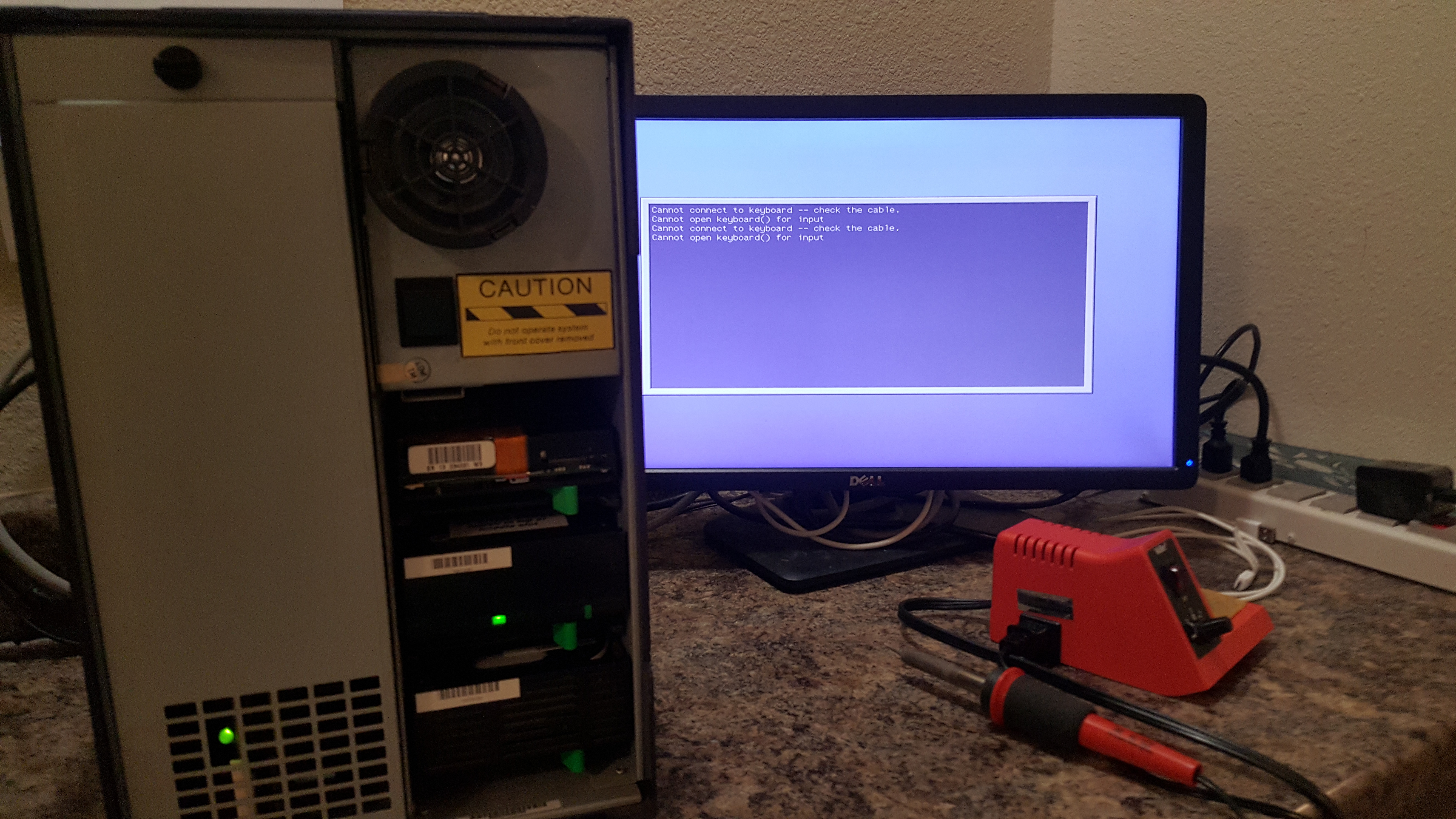

    Got the new battery installed in the Indigo. Will it refuse to boot without keyboard and mouse? indigo.jpg
    Edit: Left it running for a few hours. Won't go past this screen without keyboard.

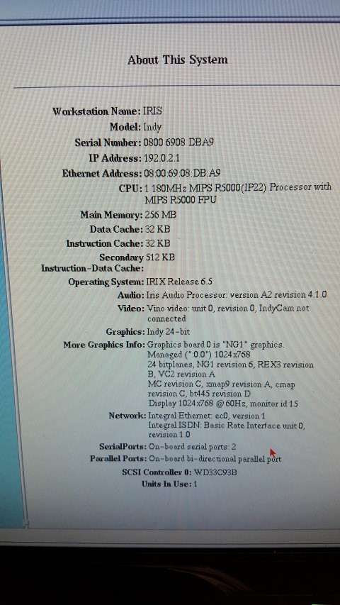

    Finally got a 13w3 cable!
    Working on removing root password now.
    What is the FPU? Is it like a math co-processor? What is its purpose?

    FPU is "Floating point unit" - in the case of the R5000, it's built into the CPU - the reason it's broken out individually is that on some of the older machines it was a separate chip from the CPU - so on something like an R3K Indigo you might have "CPU: R3000A / FPU: R3010"

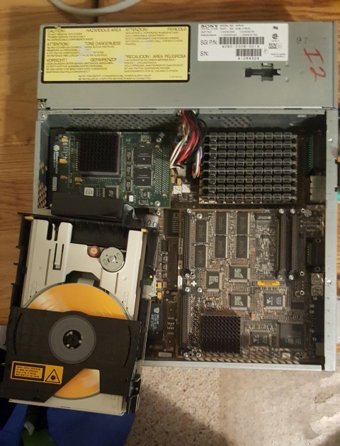

    Ran into a few problems removing the root password. The tray eject on the CD drive was broken. So, it didn't work at first.(Drive would constantly stay busy) It turns out the gear on the motor had a hairline crack and it fell off. It's loud, but at least it works now!
    The IRIX boot disks are not ISO9660. They actually use a system called EFS. (ImgBurn will say the file is corrupt) I downloaded burnatonce to write the .img to a disc with no issues. Booted up the disc and changed the root password.
