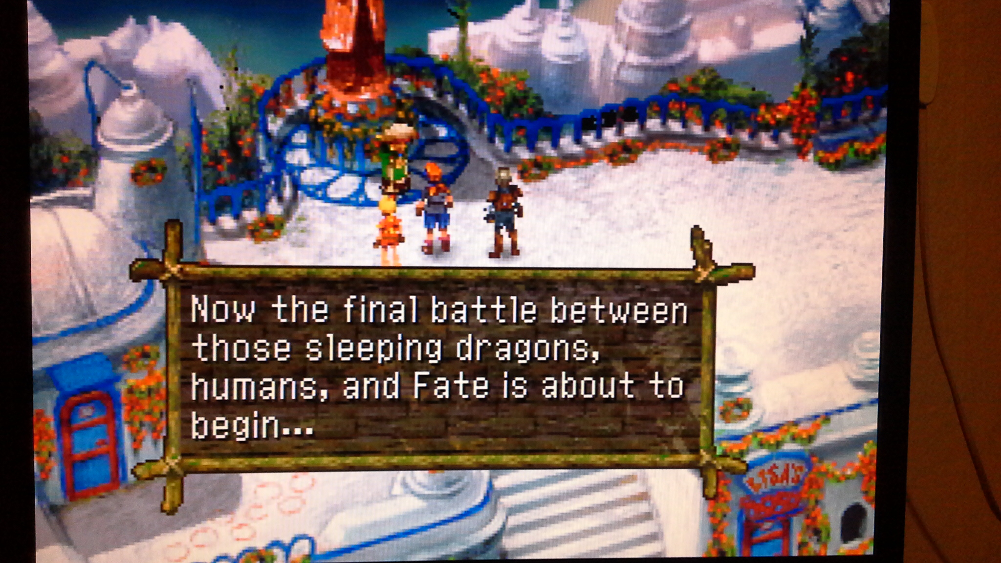

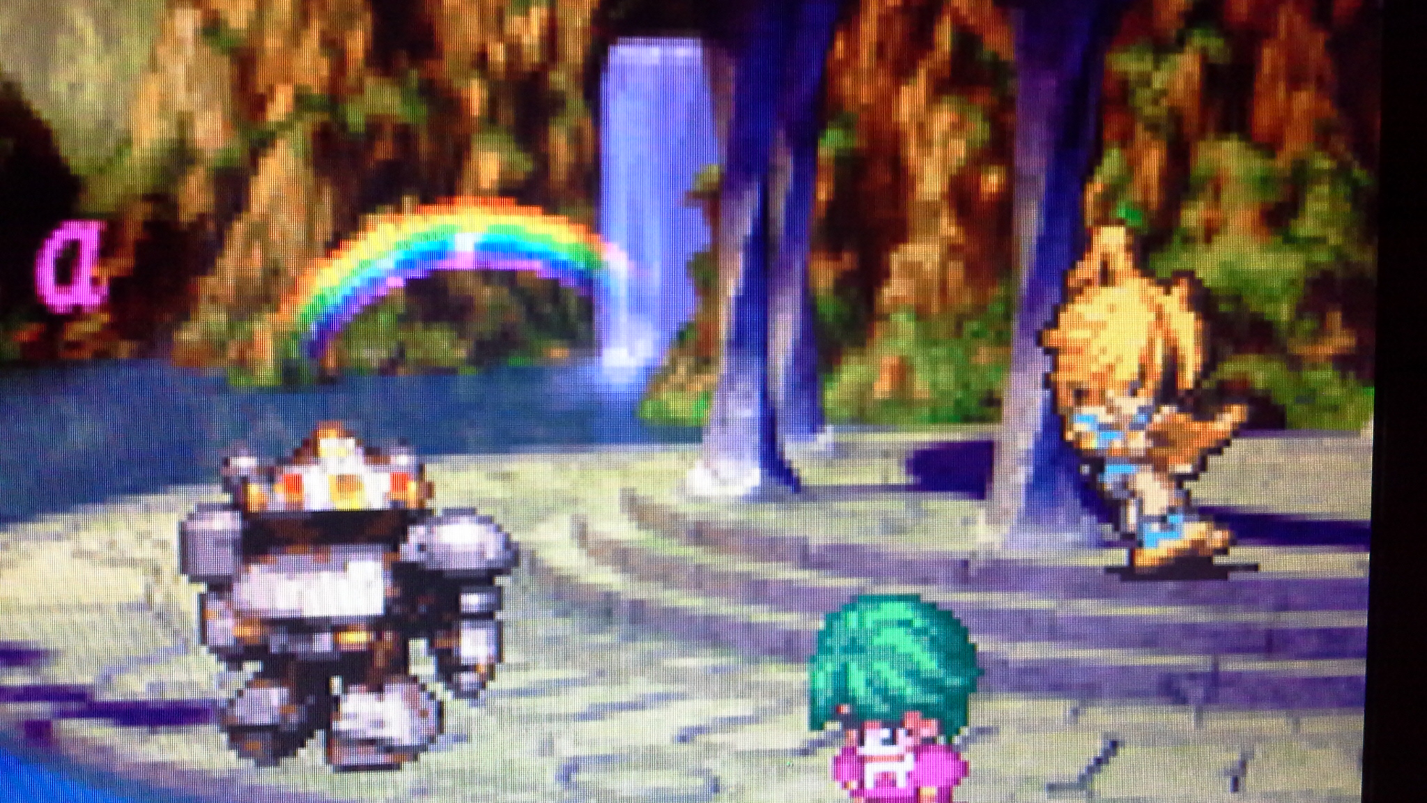

    The GBS can do deinterlacing, it just adds to the software complexity. As I said, someone has to code the software.
    What I have is tailor made for my TFT and has a lot of quirks. I don't care about deinterlacing so I get artefacts when a game uses it.
    It does display fine though, pretty much comparable with how it'd look on a CRT. No problems with the interlace mode switch either (no resync required).
    Good control software would look at the source parameters (they're kept in a few registers in the IC) and switch the deinterlace routine on and off as required. It could also automatically adjust PLL parameters and optimize the sync for perfect scrolling.
    Everything is accessible via the registers and can be controlled with an Arduino or anything else with I2C.
    Here's some Arduino code to get people started: http://www.kernelcrash.com/blog/the-gonbes-gbs-8200-and-arduino-uno/2016/04/20/
    When someone wants to develop this, contact me for updated settings and tweaks! ;)
    pics!
